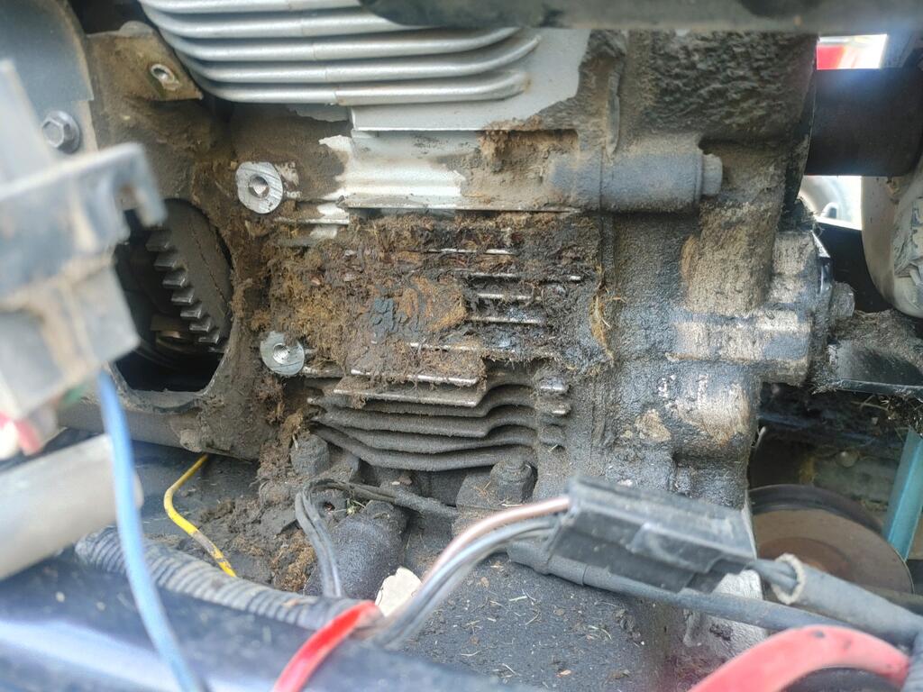

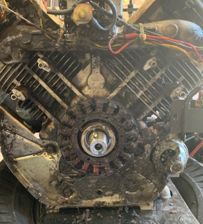

JoeM 10,318 #4 Posted April 25, 2024 (edited) Like Dan says need to shoot the temp on the oil filter to actually see. I know the air cooled ones with a 60 inch deck will red line on a hot day. Keeping them blown off and using full synthetic oil helps. Yes the engine has to come out to get the tins off. I have seen one tin destroyed by trying to remove in the machine. And it is very difficult to get the back of the heads clean with out removing the tins. especially if the rear seal is seeping. Takes about an hour to remove the engine. This one was seeping oil at the seal and you can see the back of the jugs are packed. Edited April 25, 2024 by JoeM 1 Share this post Link to post Share on other sites

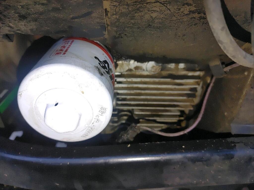

Fordiesel69 276 #10 Posted April 26, 2024 The oil filter is 180 tops and the fin area was 252 deg. It was very cold yesterday like 48 degrees so that felt hot to me. All the oil you see was from the car quest filter that wa leaking badly. He changed it and the oil after I discovered that leak so that is now addressed. Really nervous it is dirty. Share this post Link to post Share on other sites

Fordiesel69 276 #21 Posted May 1, 2024 I was able to sneak off the side cylinder tins, and was able to pressure warsh the engine while still in the tractor. Got creative with some brushes and I think I got it 85 to 90 percent clean. My concern is there is very little it any visable blowby out the crankcase indictating the rings and crankcase pressure is not abnormal, yet why is there so much oil caked all over everyplace? Also those fins behind the starter were indeed packed solid with grease and debris, yet It would not appear those fins do much cooling as there is no air blowing across them. Share this post Link to post Share on other sites
Wild Bill 633 943 #22 Posted May 6, 2024 Looks like a leaking crankshaft oil seal and the fan is blowing it foward. Share this post Link to post Share on other sites
