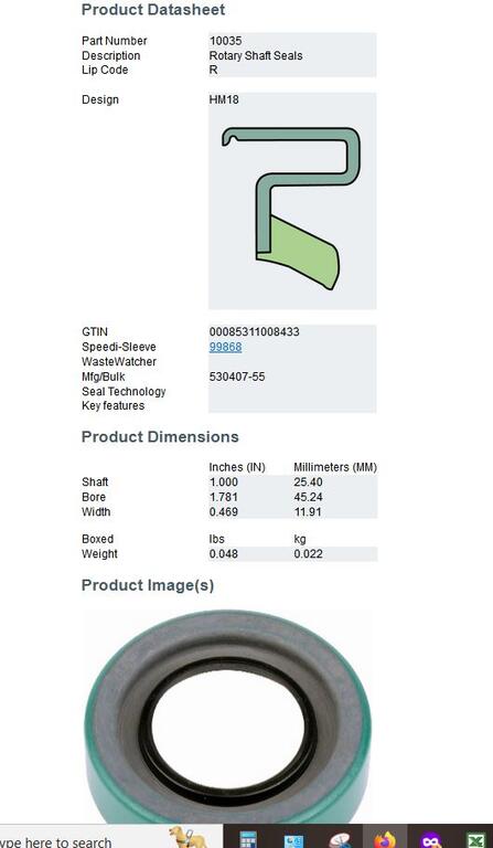

WHNerd 8 #1 Posted April 24, 2024 Need Part number and source for front axle seal for gt14.. Also, need a parts list for GT14. 1-7441. Share this post Link to post Share on other sites

pfrederi 21,215 #3 Posted April 24, 2024 Front axle seal WH #3373 SKF 10035 Share this post Link to post Share on other sites
