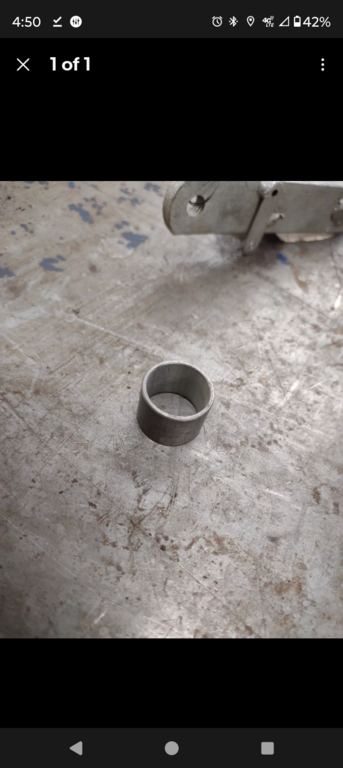

Mushrush 18 #9 Posted April 26 Same thing happened to me. Except my pulleys are fine. I'm missing the spacer. I'm about to go to Lowe's to find something that'll work. Any information on the size of washer would be greatly appreciated. In the picture, is this correct or no? Share this post Link to post Share on other sites

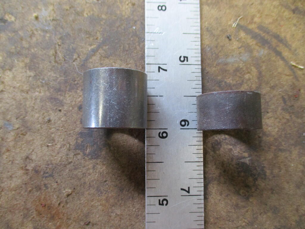

pfrederi 19,278 #12 Posted April 27 There are two spacers one between the pullies (3/4" long) and one between outer pulley and the shield. 1/2"" long Share this post Link to post Share on other sites
