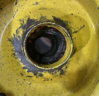

fourwheelhorseman 362 #1 Posted April 21, 2024 (edited) What year did Wheelhorse start using bearings in thier front rims?I have a manual from 1964 that shows wheel bearings rather than bushings in the parts diagram, so I’m guessing before that. I’ve got a 753 that I’ve been working with that has bushings instead of bearings. Most likely I’ll pop a bushing out and measure it, then replace them with bearings rather than leave the bushings in place. Edited April 21, 2024 by fourwheelhorseman 1 Share this post Link to post Share on other sites

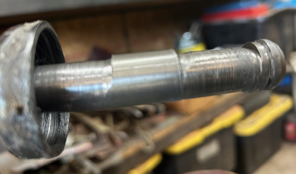

ri702bill 12,992 #2 Posted April 21, 2024 (edited) The bushings are what eats up the spindles.... Edited April 21, 2024 by ri702bill 1 Share this post Link to post Share on other sites

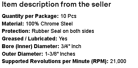

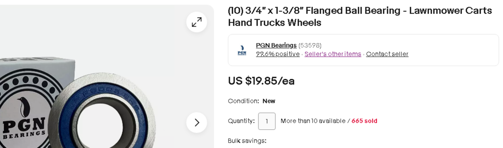

JoeM 10,253 #3 Posted April 21, 2024 The last set of bushings I replaced was 1 3/8 x 3/4 flange bearings Hard to find US made stuff, these were high quality off shore. 2 Share this post Link to post Share on other sites

JoeM 10,253 #5 Posted April 22, 2024 (edited) 10 hours ago, ri702bill said: bushings are what eats up the spindles Dirt and lack of grease. I have seen one were the little dust / rubber cap was missing. It was greased but the sandy dirt ate away an 1/8" on the outboard bushing. The other side with the cap was still good. It was on a customer's JD. Missing dirt cap side. One season, 50 hours. 9 hours ago, peter lena said: clean out and re grease those , with a hi temp grease Pete those bearing got some pretty good grease in them. They are rated at +20,000 rpm. Using them on slow moving tire I don't think i would get to concerned. Edited April 22, 2024 by JoeM Share this post Link to post Share on other sites
