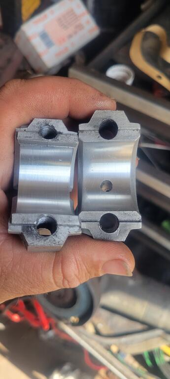

Fordiesel69 272 #26 Posted April 30, 2024 Crank looks good, rod not so much. What would happen it I got a new rod and just let it be noisey? Would the slop break the new rod? Also there was never grenade gears in this one, the shaft holes are plugged on the inside. The piston and rings are new. Not one spec of carbon so the owner did a quick fix (probably an oil burning monster) Didnt even bother to hone the cylinder. Share this post Link to post Share on other sites
RED-Z06 2,720 #27 Posted April 30, 2024 10 minutes ago, Fordiesel69 said: Crank looks good, rod not so much. What would happen it I got a new rod and just let it be noisey? Would the slop break the new rod? Also there was never grenade gears in this one, the shaft holes are plugged on the inside. The piston and rings are new. Not one spec of carbon so the owner did a quick fix (probably an oil burning monster) Didnt even bother to hone the cylinder. Eventually it can fail if the crank is out of round. My K181 was addicted to oil, i put in a new rod, piston, rings..no hone out...runs like new, this is the old rod i pulled out of it, it, I know i had about 100hrs on it, and it came off a completely worn out tractor when i transplanted it 20+ years ago Share this post Link to post Share on other sites
Fordiesel69 272 #28 Posted April 30, 2024 So a quote from brian millers webpage: K-series and Magnum "new style" rod. This particular forged rod has a thicker beam section, which makes it just as durable as a machined billet rod, and with bearing inserts installed, it's suitable for high RPM and wide open throttle engine operation. And when used with a factory type piston with a thin-wall wrist pin, the rotating assembly will not need to be rebalanced. OEM Kohler part # 45 067 24-S and John Deere part # AM106441. $124.50 each, plus shipping & handling. Return To Previous Paragraph È I think i have no choice but to just buy a new heavy duty rod, and let it knock a bit. Ebay is dry on cranks it seems. Nobody local to machine or I would consider it. Share this post Link to post Share on other sites

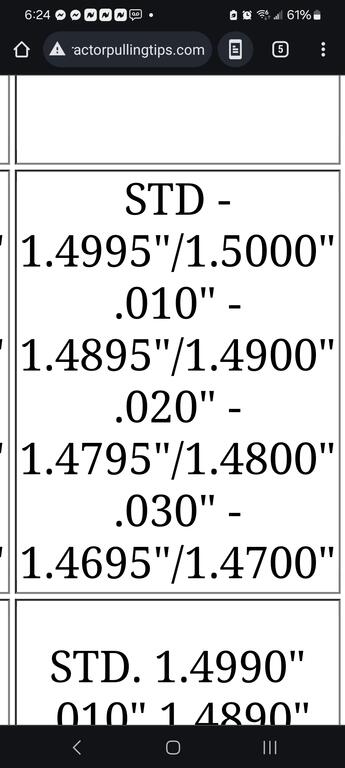

Fordiesel69 272 #32 Posted May 1, 2024 1.494 on side away from TDC. 1.488 on side that is TDC. I'm at my limit on photos so sorry. Share this post Link to post Share on other sites
RED-Z06 2,720 #33 Posted May 1, 2024 (edited) 17 minutes ago, Fordiesel69 said: 1.494 on side away from TDC. 1.488 on side that is TDC. I'm at my limit on photos so sorry. Heres the tolerances, 1.494 is only 1thou under minimum, not ideal..but 1 488 is already beyond 10 under. I personally wouldnt go 20 under, you never know how deep the surface hsrdening was back then. Edited May 1, 2024 by RED-Z06 Share this post Link to post Share on other sites
