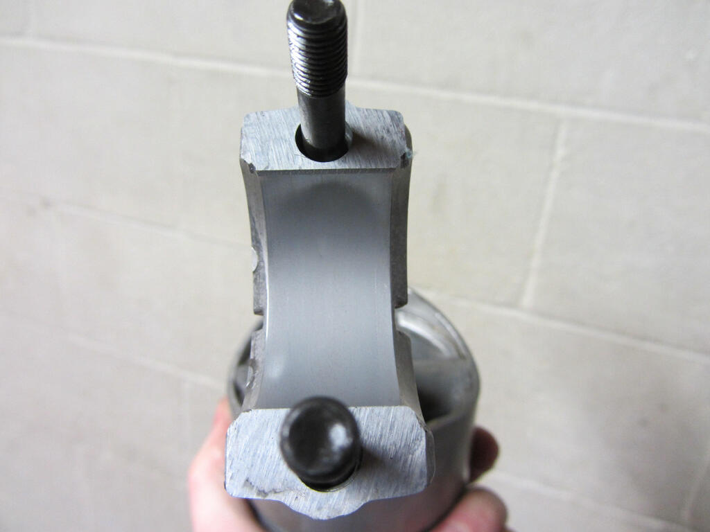

Fordiesel69 272 #5 Posted April 21, 2024 (edited) I have torn others down and the rods look perfect. And it was a waste of time. I mean its not that hard to have a look i guess. But the entire under side of the hood has every oil chnage written on it since 2021 back. Here is a oil gushing / knocking 14HP I torn down with this same kind of knock. Edited April 21, 2024 by Fordiesel69 Share this post Link to post Share on other sites

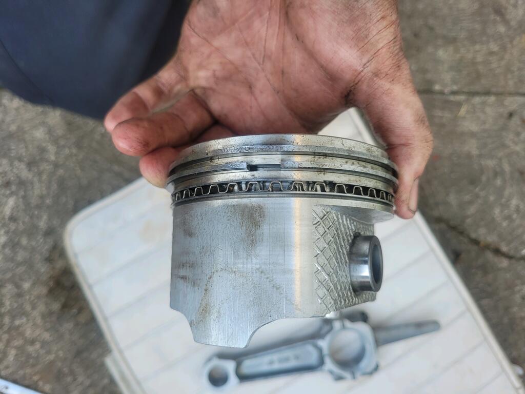

squonk 48,207 #6 Posted April 21, 2024 I had a 1000 HR K341. The noise I had was the same piston rattle but just a tick louder. I had a spare engine so I swapped it out. Tore the engine down and the piston skirt was broke and there was a balance gear roller bearing in the oil pan. Unless you have X-Ray vision like Super Man tear it down. 3 Share this post Link to post Share on other sites

RED-Z06 2,720 #19 Posted April 28, 2024 On 4/21/2024 at 5:17 PM, Fordiesel69 said: I have torn others down and the rods look perfect. And it was a waste of time. I mean its not that hard to have a look i guess. But the entire under side of the hood has every oil chnage written on it since 2021 back. Here is a oil gushing / knocking 14HP I torn down with this same kind of knock. That dull finish says dirt intrusion or carbon abrasion on that one, probably had a nice rattle to it 1 Share this post Link to post Share on other sites
Fordiesel69 272 #20 Posted April 28, 2024 (edited) All small engines have this appearance on the rods. I will be doing a tear down this week if the weather holds out. Edited April 28, 2024 by Fordiesel69 Share this post Link to post Share on other sites

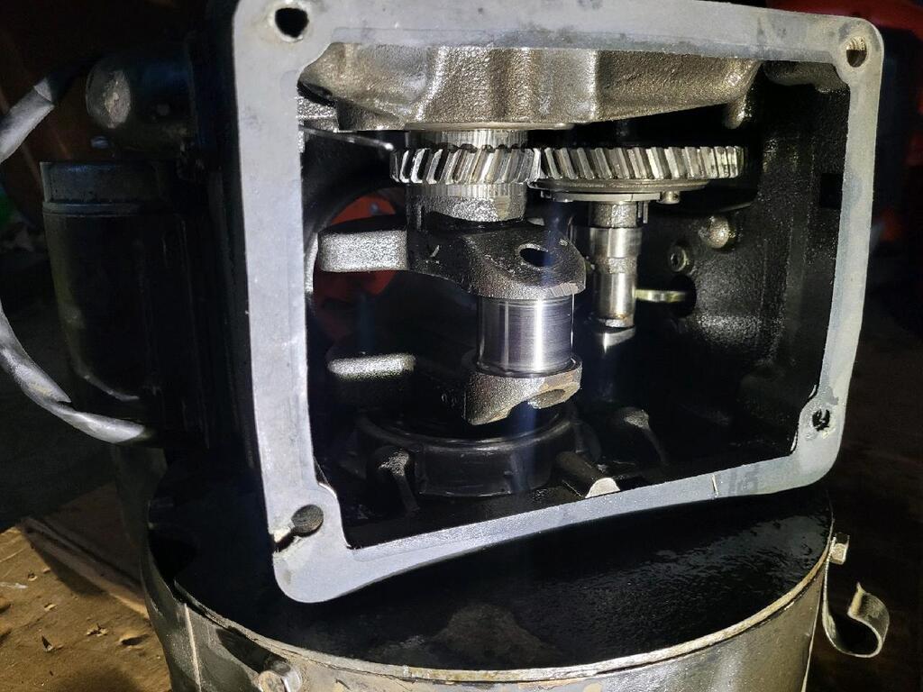

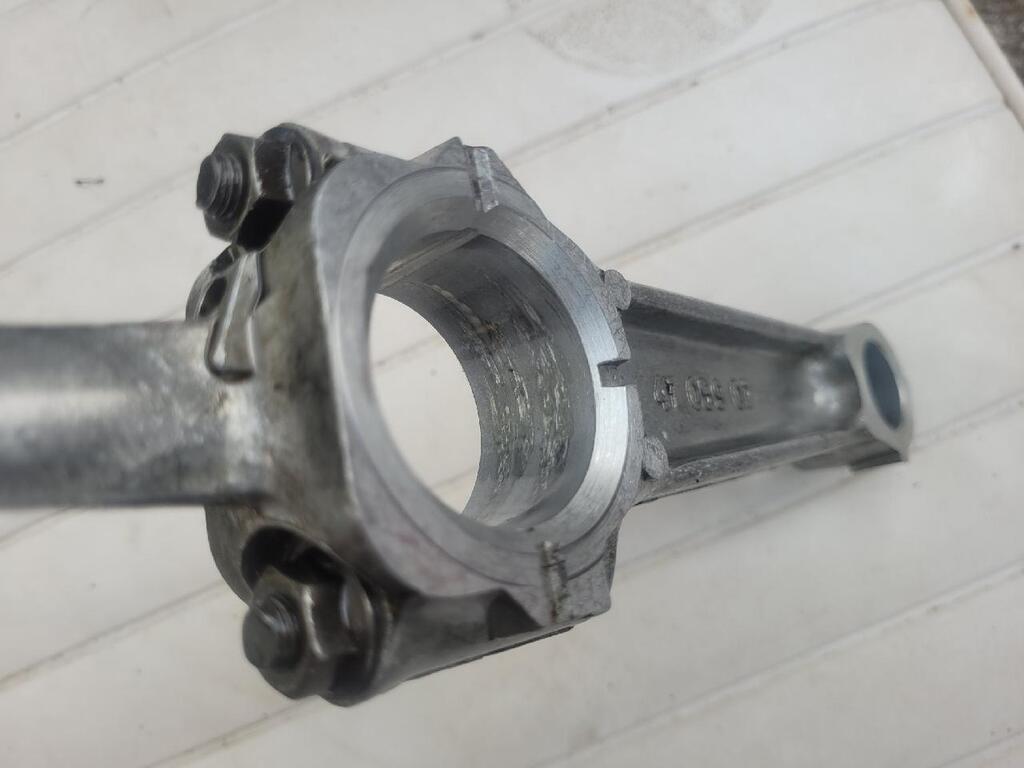

Fordiesel69 272 #22 Posted April 29, 2024 Really bummed out. The prior owner did a bodge job. The rod has a little scoring but you can't feel it with your finger, and the crank pin looks really nice. Very shiney and no scratches. The problem is around TDC and a little after there is slop. Anywhere else there is not. So it would appear I need to get a replacement crankshaft ad my local shops all closed down. Share this post Link to post Share on other sites
RED-Z06 2,720 #23 Posted April 30, 2024 44 minutes ago, Fordiesel69 said: Really bummed out. The prior owner did a bodge job. The rod has a little scoring but you can't feel it with your finger, and the crank pin looks really nice. Very shiney and no scratches. The problem is around TDC and a little after there is slop. Anywhere else there is not. So it would appear I need to get a replacement crankshaft ad my local shops all closed down. I doubt you can get a new crank from Kohler... i cant even get new cranks for some modern Kohlers still in production. That rod looks really bad, have you measured the crank to see if its already turned under, or how out of round it is? New cranks last listed around $750, can probably get NOS cranks on ebay for half that. Share this post Link to post Share on other sites
