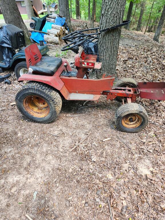

Nathan W 5 #1 Posted April 21, 2024 Is this a good tranny looks like they where made 68 to 73. Also looking to purchase a 74 c 160 is the 74 tranny better than the 90 2046. Thanks in advance Share this post Link to post Share on other sites
Nathan W 5 #2 Posted April 21, 2024 1140 is the 74 wondering if it's better or interchangeable Share this post Link to post Share on other sites
pfrederi 20,874 #3 Posted April 21, 2024 Only two significantly different Sunstrands Hydro gear and piston to piston. (Other model numbers are just minor variations in linkages controls etc) Hydro gear have a figure 8 motor housing.... Piston to piston round motor housing...Piston to piston may be fitted with an external physical brake. The previous maintenance of the units is a much bigger factor in deciding which one to get than the type, 1 1 Share this post Link to post Share on other sites
oliver2-44 11,632 #4 Posted April 21, 2024 10 minutes ago, pfrederi said: The previous maintenance of the units is a much bigger factor in deciding which one to get than the type, My C160 with the Sundstrand is one tough worker. 1 Share this post Link to post Share on other sites
Nathan W 5 #5 Posted April 21, 2024 My d 160 has 1137 so is the same just different linkages? Share this post Link to post Share on other sites
Ed Kennell 46,607 #6 Posted April 22, 2024 I have switched the 1140 in a C-160 for a 90-2046 with no problems. My limited experience with the Sundstrands is, all models are good if they were maintained correctly. As I recall, the 1140 had hydraulic lift and the 2046 did not. Again, some used ATF and some used Motor oil....do not mix the two. I test all hydros by strapping them to a tree and make sure they will spin the tires forward and backwards with me in the seat. If the test tractor is not running, you can drive the hydro with a long belt on the PTO of a running tractor parked behind the test tractor. 1 Share this post Link to post Share on other sites
Nathan W 5 #7 Posted April 22, 2024 I have a 73 14 and 16 autos. The 14 was an option on the tractor. 16 has hydro lift. Both ATF. 14 was bought used not sure what came in originally. Thank for the info. Share this post Link to post Share on other sites
Nathan W 5 #8 Posted April 22, 2024 Gonna bring this one back to life. Found a raider 12 that has same rear-end and strong. 1 Share this post Link to post Share on other sites
pfrederi 20,874 #9 Posted April 22, 2024 13 hours ago, Nathan W said: My d 160 has 1137 so is the same just different linkages? The D series tractors had piston to piston arranged in what is called a separated system, pump and motor connected by a manifold not directly bolted together. The innards are eh same as any other Sunstrand piston to piston unit. Technically you could take the separated system pump and bolt it directly to a motor. and put it on a regular WH. Motion control (swash plate shaft) would have to be swapped end for end. Share this post Link to post Share on other sites
