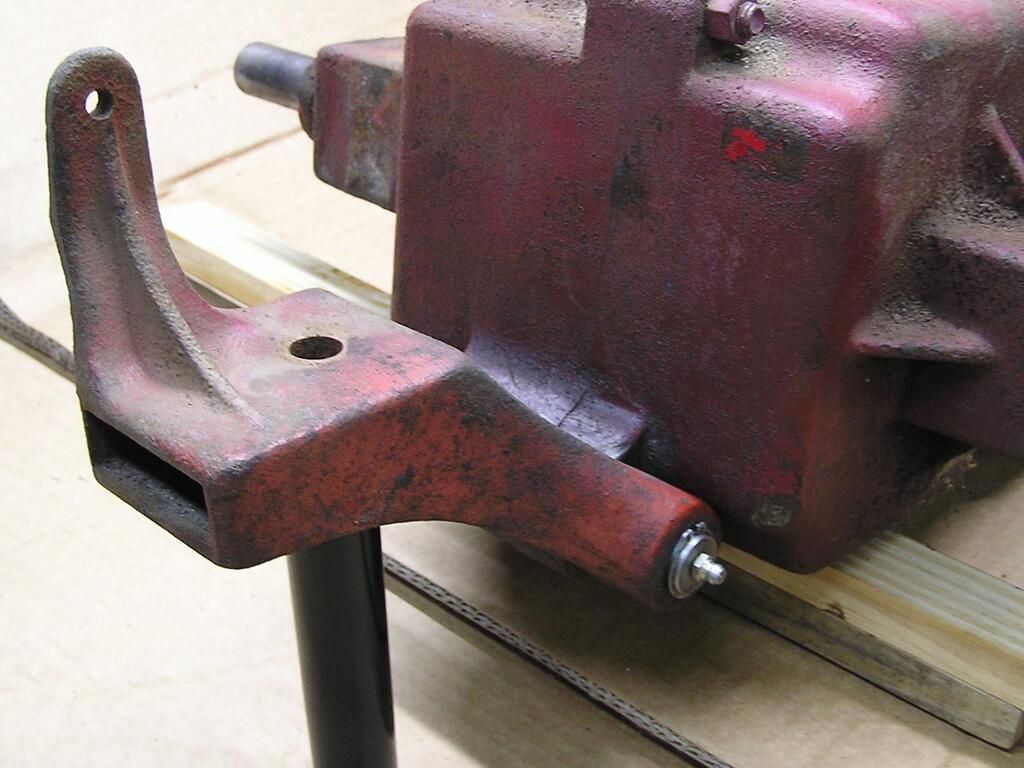

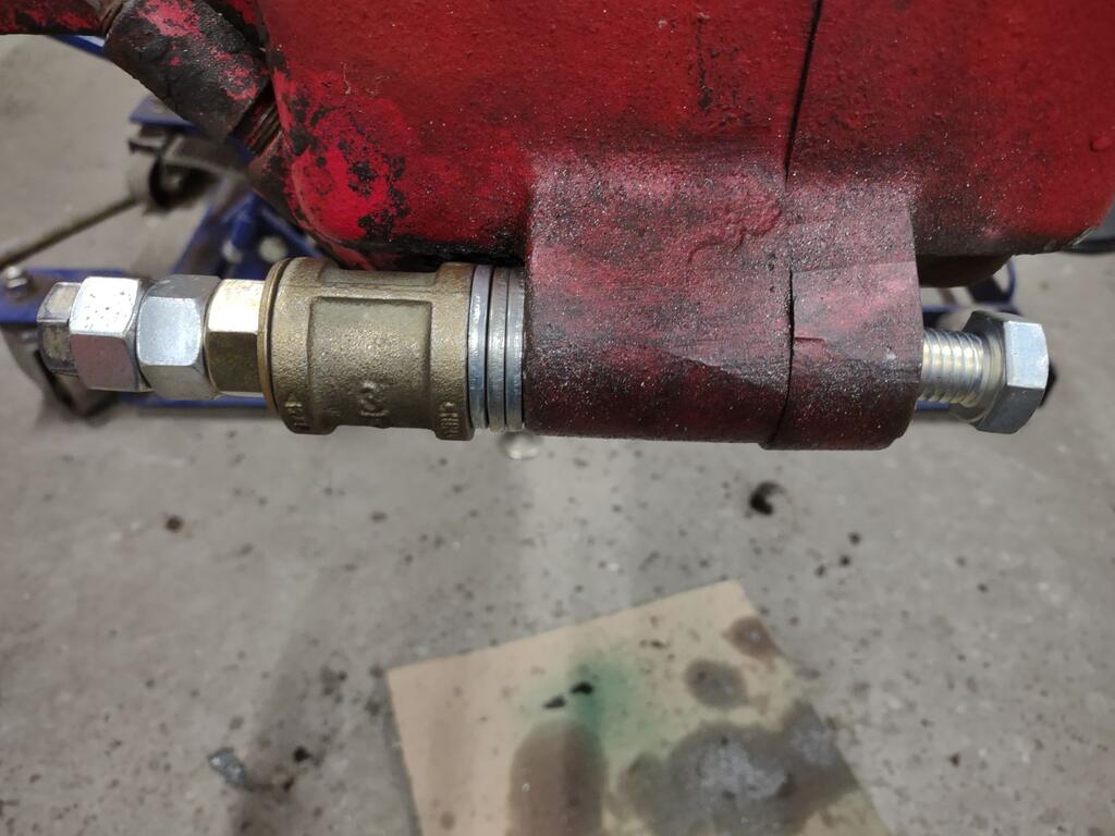

Achto 31,351 #3 Posted April 20, 2024 (edited) I threw together this puller to remove that last stubborn pin that I had. First I used a Sawzall to cut the pin on each side of the tranny. Then I drilled & tapped the pin that was stuck in the tranny. After that I used this puller to remove the pin. Tighten the bolt on the puller, use a drift to pound on the opposite end of the pin. Repeat, repeat, add more extensions, repeat.... Edited April 20, 2024 by Achto 4 9 Share this post Link to post Share on other sites
WHX?? 55,753 #4 Posted April 20, 2024 (edited) Those air hammers have helped me once or twice. Yes cut the slot hitch and take the hitch to the press if needed. Gets the draw bar out of the way too. Edited April 20, 2024 by WHX?? 1 2 1 Share this post Link to post Share on other sites
Mike'sHorseBarn 3,429 #5 Posted April 20, 2024 11 minutes ago, Achto said: I threw together this puller to remove that last stubborn pin that I had. Fist I used a Sawzall to cut the pin on each side up the tranny. Then I drilled & tapped the pin that was stuck in the tranny. After that I used this puller to remove the pin. Tighten the bolt on the puller, use a drift to pound on the opposite end of the pin. Repeat, repeat, add more extensions, repeat.... I really like the puller idea. 1 1 Share this post Link to post Share on other sites
mrc 1,067 #6 Posted April 20, 2024 i use my ball joint press. snap-on BJP-1 3 Share this post Link to post Share on other sites
Ed Kennell 45,378 #7 Posted April 20, 2024 (edited) I've removed a couple by sawing off the pin like Dan did, but then I bottom drilled a 7/16 hole in the pin from the right side stopping about 1/4" before drilling thru. Then used a 3/8" drift in the hole and a BFH to drive the pin out. The idea is, you are pulling instead of pushing and mushrooming the end the pin. I can see this combined with Dans puller would really work well. Using the drift in a hole does not mushroom the pin like pounding on the end of the pin. Edited April 20, 2024 by Ed Kennell 6 2 Share this post Link to post Share on other sites
Handy Don 16,063 #8 Posted April 20, 2024 1 hour ago, Achto said: This is an inspiring example of thinking outside the box, but shouldn't the washers be between the nuts and the pipe coupler? Share this post Link to post Share on other sites

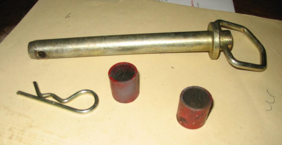

daveoman1966 3,882 #11 Posted April 20, 2024 Hitch pin removal (hasn't failed me yet): Take the right wheel off and set that side trans on a jack stand...leave the left wheel on. (1) the hitch pin is soft---cut off flush with Sawzall (2) Center punch and drill 1/8" pilot hole in RIGHT side at least 1 inch deep. (3) Open this 1/8 to 1/4 then to 1/2 or more...drilling deeper each time. (4) Using a pneumatic impact hammer with round punch in that hole you drilled to drive it thru. (5) Reinstall pin using a 3/4" with a big "D" ring like this from TSC....less than $10 bux. Coat it with anti-seize. 6 4 Share this post Link to post Share on other sites

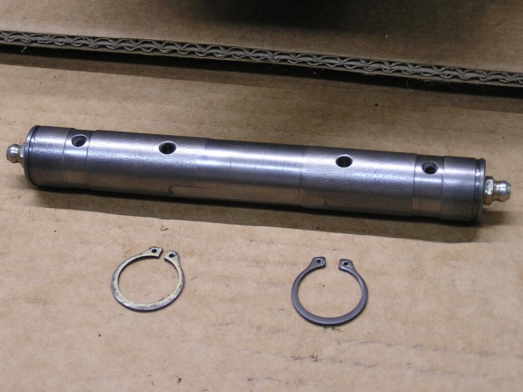

ri702bill 11,591 #12 Posted April 20, 2024 And once done with the removal, the solution is this....... Have these I made on all my Horses - for 10+ years now - remove one retainer clip - push it out with one finger.... 4 6 Share this post Link to post Share on other sites

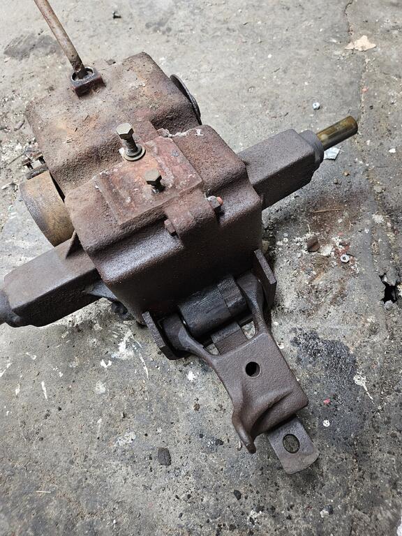

953 nut 64,707 #15 Posted April 20, 2024 9 hours ago, WHX?? said: Those air hammers have helped me once or twice. Yes cut the slot hitch and take the hitch to the press if needed. Gets the draw bar out of the way too. If the pin won't come out easily I don't even fight with it. Three cuts and move on to the press. Cut both ends off flush with the transaxle to remove the slot hitch/draw bar, cut at the center of the transaxle castings and after the transaxle has been pulled apart take both halves to the press and push the remainder of the pin out of each half. 4 Share this post Link to post Share on other sites

Achto 31,351 #18 Posted April 20, 2024 11 hours ago, Handy Don said: This is an inspiring example of thinking outside the box, but shouldn't the washers be between the nuts and the pipe coupler? That was the point where I ran out of room inside the pipe coupler. Those are 3/4" washers over the pin. 1 1 Share this post Link to post Share on other sites

Lane Ranger 11,883 #20 Posted April 20, 2024 11 hours ago, daveoman1966 said: Hitch pin removal (hasn't failed me yet): Take the right wheel off and set that side trans on a jack stand...leave the left wheel on. (1) the hitch pin is soft---cut off flush with Sawzall (2) Center punch and drill 1/8" pilot hole in RIGHT side at least 1 inch deep. (3) Open this 1/8 to 1/4 then to 1/2 or more...drilling deeper each time. (4) Using a pneumatic impact hammer with round punch in that hole you drilled to drive it thru. (5) Reinstall pin using a 3/4" with a big "D" ring like this from TSC....less than $10 bux. Coat it with anti-seize. yes I have been using these TSC hitch pins for years as the replacement pins! I like it so much I might even have to buy a transmission to remove a stubborn original! 2 Share this post Link to post Share on other sites

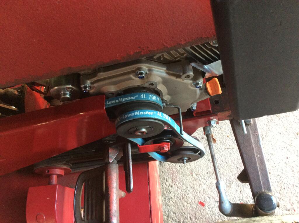

Rick3478 445 #21 Posted April 20, 2024 For worst design, I'd submit the six-sided drive belt on some of the 37" two blade mower decks. Rolls easy and tears up fast once it's rolled. 1 Share this post Link to post Share on other sites

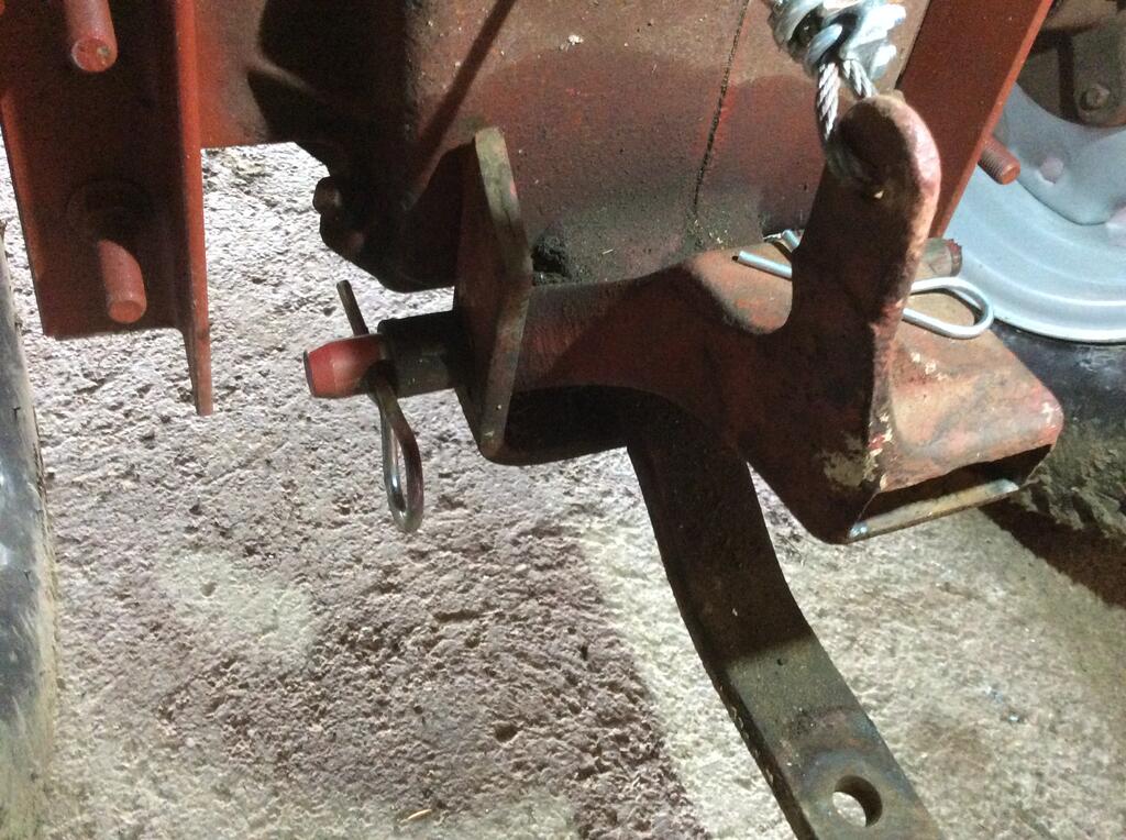

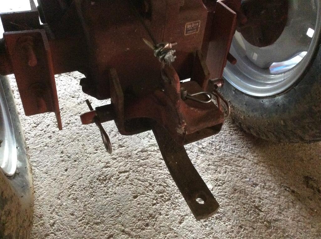

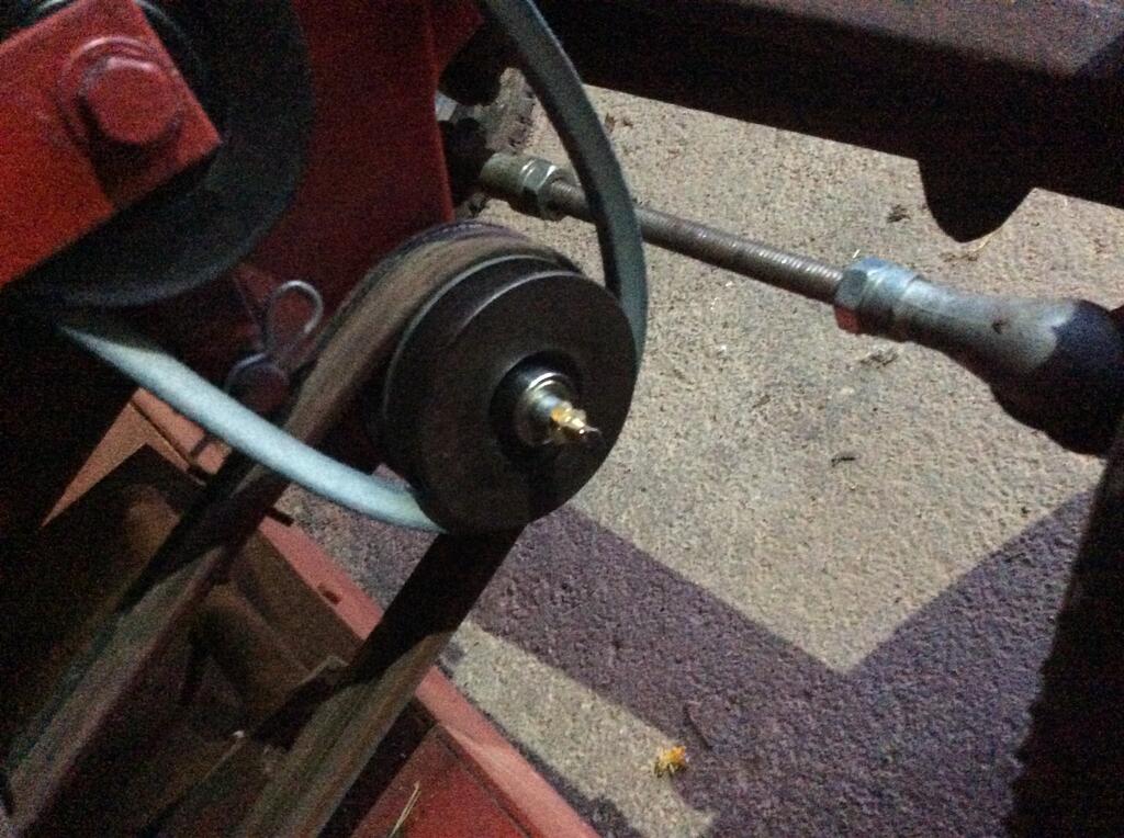

Tractorhead 9,217 #22 Posted April 21, 2024 (edited) 23 hours ago, Ed Kennell said: Just remembered one other thing I do as soon as I get a "new" tractor. I drill a hole down to the pin in the top of each tranny hitch lug. Then fill it with PB and let it sit for a couple years. After I get the pin out, I tap these holes for a grease zerk. The same i did when i got it new to me. pulled all Axles they be ungreased by Original and refit it with grease zerks. Even on spindles of Steering or Mowerdeck pulles and also on the Top of the Tranny hitch. On this pict it can be seen on the left side under the gunk. but it‘s still there and must be just wiped off with a towell before each you just can see the grease that flotes outside a little when moving. i have no better picts for now but can it update soon if needed. that saves me a lot of troubles on bolt removing or wear. 👍 To pull it out i use a induction heater and lot of Ballistol Gunoil. @Pullstart ‚s tip to twist it carefully with a big pipewrench 2“ was the go for it. Moving, gently hammering while moving, heat and Ballistol does the trick to loosen it up. Edited April 21, 2024 by Tractorhead 2 1 Share this post Link to post Share on other sites
