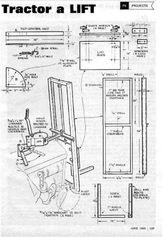

953 nut 64,322 #1 Posted April 19, 2024 Give your Garden Tractor a Lift In June of 1969 Popular Science Magazine encouraged us to “Give your Garden Tractor a Lift”. They provided detailed drawings and a good description of the build. Let’s get in our time travel machine and go back fifty-five years to build this hand powered forklift attachment. 6 2 2 Share this post Link to post Share on other sites
