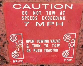

siebenaler 114 #8 Posted April 28, 2024 Sorry it's a Bronco 14 going thru it all now head off valve job done runs good now. My question is Finally. How come the tow release valve goes in Circles . It was moving very slow especially in reverse. It was a little low on oil atf oil. It's better now but should or should not the valve stop at 360 degrees it was slightly not parallel with the frame At first. Share this post Link to post Share on other sites
kpinnc 18,884 #9 Posted April 28, 2024 (edited) Tow valve on a hydrogear has two working positions: peg forward or back. You should have a decal that looks like this: Edited April 28, 2024 by kpinnc 1 Share this post Link to post Share on other sites
Ed Kennell 46,982 #10 Posted April 28, 2024 (edited) 8 hours ago, Mark siebenaler said: How come the tow release valve goes in Circles . It is not a stem type valve that screws in to close. Edited April 28, 2024 by Ed Kennell 2 Share this post Link to post Share on other sites
