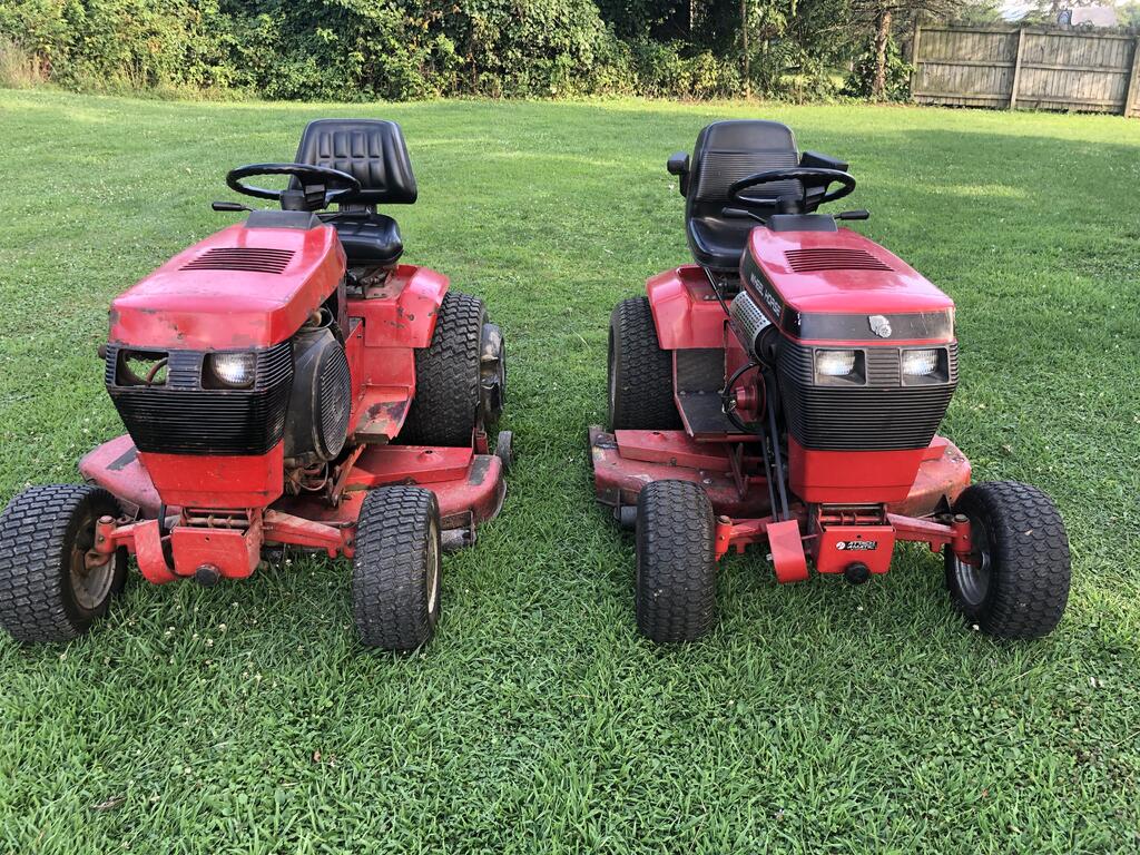

MyOtherCarisaWheel Horse 10 #1 Posted April 16, 2024 (edited) I have a 1995 520h bought last summer that has a random shutdown issue. When it does this if I get to the key and turn it off, then back on again, it will continue to run just fine. I replaced the ignition switch and that made no difference. I’m thinking the kill relay may be the culprit. I was next going to Hotwire the coil with a wire and alligator clip to the battery just as a test to see if it still does this. Where else should I be looking for an issue? It does this 4 or 5 times in a 45 minute window and runs fine otherwise. I also have a 90 or 92 520 for possible part swapping diagnostics. Edited April 16, 2024 by MyOtherCarisaWheel Horse 2 Share this post Link to post Share on other sites

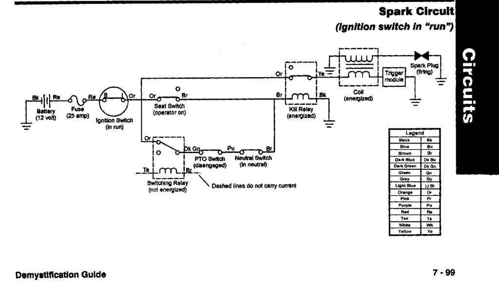

lynnmor 9,042 #5 Posted April 16, 2024 You are getting some good advice. Download the Demystification Guide and look at page 7-99. 2 Share this post Link to post Share on other sites

MyOtherCarisaWheel Horse 10 #7 Posted April 16, 2024 43 minutes ago, lynnmor said: You are getting some good advice. Download the Demystification Guide and look at page 7-99. Thank you, I downloaded the guide and I think I’m on the right track. If I jump juice directly from the battery to the coil and the issue is fixed I can assume the trigger module is ok I believe. I think the seat safety switch is already jumped as it runs with no one on the seat. My older 520 had issues with the molex plug and fuse block. I cut that all out and put an aftermarket plug and fuse bus in it and had no further issues in the 10 or 12 years since. Since I got the 95 the older one is relegated to driveway plowing and grading duties so it doesn’t see the usage it used to. 3 Share this post Link to post Share on other sites
JoeM 10,287 #8 Posted April 16, 2024 7 hours ago, MyOtherCarisaWheel Horse said: If I jump juice directly from the battery to the coil and the issue is fixed I can assume the trigger module is ok I believe yes 2 Share this post Link to post Share on other sites
Handy Don 17,484 #9 Posted April 17, 2024 (edited) 10 hours ago, MyOtherCarisaWheel Horse said: I believe. I think the seat safety switch is already jumped as it runs with no one on the seat. If this “hot wire” is faulty, the engine will die. I’d encourage you to restore the seat switch, in any case. (For emphasis, read the “Rookie Mistakes” thread) Edited April 17, 2024 by Handy Don Share this post Link to post Share on other sites
