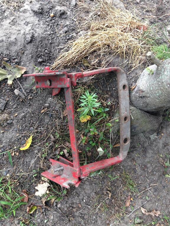

ML3 2,057 #3 Posted April 15, 2024 2 minutes ago, ebinmaine said: Is that reversed? Got any pics? Unfortunately no pics cause plow is apart in shed loft. Pic of plow bracket. I'm sure I can figure it out but I need to really know if my plow will even work on the 953?? Share this post Link to post Share on other sites

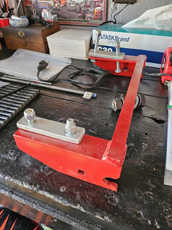

Ed Kennell 43,843 #5 Posted April 15, 2024 That bracket mounts to the front of the axle with the notches down. 2 3 Share this post Link to post Share on other sites
gwest_ca-(File Mod) 11,864 #6 Posted April 15, 2024 Share this post Link to post Share on other sites
953 nut 63,166 #7 Posted April 15, 2024 1 hour ago, Ed Kennell said: That bracket mounts to the front of the axle with the notches down. The ears of the latch will be pointed to the back and be lifted to remove the blade. Simple matter of physics, The force of the blade pushing a load will be transferred directly to the axle housing. 1 Share this post Link to post Share on other sites

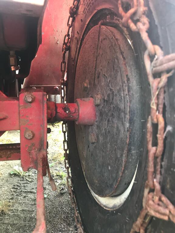

Lane Ranger 11,681 #8 Posted April 16, 2024 (edited) This is hitch on 1054 with Wheel Weights. Ww-93. our 1054 tractors also had a drawbar hitch welded to the back of the snowplow hitch for added usage. The drawbar does not interfere with operation of the hydraulic lift rear hitch. Edited April 16, 2024 by Lane Ranger Share this post Link to post Share on other sites
ML3 2,057 #9 Posted April 16, 2024 18 minutes ago, Lane Ranger said: This is hitch on 1054 with Wheel Weights. Ww-93. our 1054 tractors also had a drawbar hitch welded to the back of the snowplow hitch for added usage. The drawbar does not interfere with operation of the hydraulic lift rear hitch. I like the drawbar hitch. I do have the weights as well. I really would like to.make a functioning 3pt hitch & I discussed it some w/953nut already. Or I may just order 2" receiver from Lowell.... Will my long frame plow fit or will I need the 953/1054 specific plow??? Share this post Link to post Share on other sites
Lane Ranger 11,681 #10 Posted April 16, 2024 20 minutes ago, ML3 said: I like the drawbar hitch. I do have the weights as well. I really would like to.make a functioning 3pt hitch & I discussed it some w/953nut already. Or I may just order 2" receiver from Lowell.... Will my long frame plow fit or will I need the 953/1054 specific plow??? Never had a long frame plow on one . I suspect the long frame plow might work if the 3/4 bar is moved forward. Share this post Link to post Share on other sites
953 nut 63,166 #11 Posted April 16, 2024 11 hours ago, ML3 said: Will my long frame plow fit or will I need the 953/1054 specific plow??? I have used a long frame plow on the 953. Had to modify the angle lever a bit to miss the running board but nothing too radical. 2 Share this post Link to post Share on other sites
