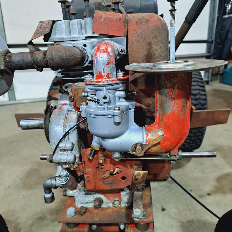

WHX?? 56,108 #7 Posted May 13, 2024 (edited) Just bought this one 18 clams in the jungle. Have yet to put gas to it. I've blown 18 bucks in worse ways and for this free tractor is appropriate. There is no name brand for off shore ones. According to our Simplecity bro there are three sizes of flo jets. Might have been able to save the old one at 40 for a rebuild kit. Be advised the mounting screws are 6mm. Not a concern at all. Edited May 13, 2024 by WHX?? 1 Share this post Link to post Share on other sites
Daniel_Heetderks 36 #8 Posted May 18, 2024 Well I got the carb on my tractor and when i start it the engine revs all the way up and the throttle doesnt do anything. Anyone know what's with that? I adjusted the screws to the same positions as the ones on the previous carb. Share this post Link to post Share on other sites
Rick3478 445 #9 Posted May 18, 2024 3 hours ago, Daniel_Heetderks said: Well I got the carb on my tractor and when i start it the engine revs all the way up and the throttle doesnt do anything. Anyone know what's with that? I adjusted the screws to the same positions as the ones on the previous carb. Sounds like governor issue. Share this post Link to post Share on other sites
Wayne0 1,557 #10 Posted May 18, 2024 (edited) 5 hours ago, Rick3478 said: Sounds like governor issue. Yup! Make sure all your springs are connected correctly. Edited May 18, 2024 by Wayne0 Share this post Link to post Share on other sites
Daniel_Heetderks 36 #11 Posted May 19, 2024 (edited) found out the plate on the end of the throttle shaft is on the wrong way. A common problem for those cheap aftermarket carbs from what I've heard. Edited May 19, 2024 by Daniel_Heetderks Share this post Link to post Share on other sites
