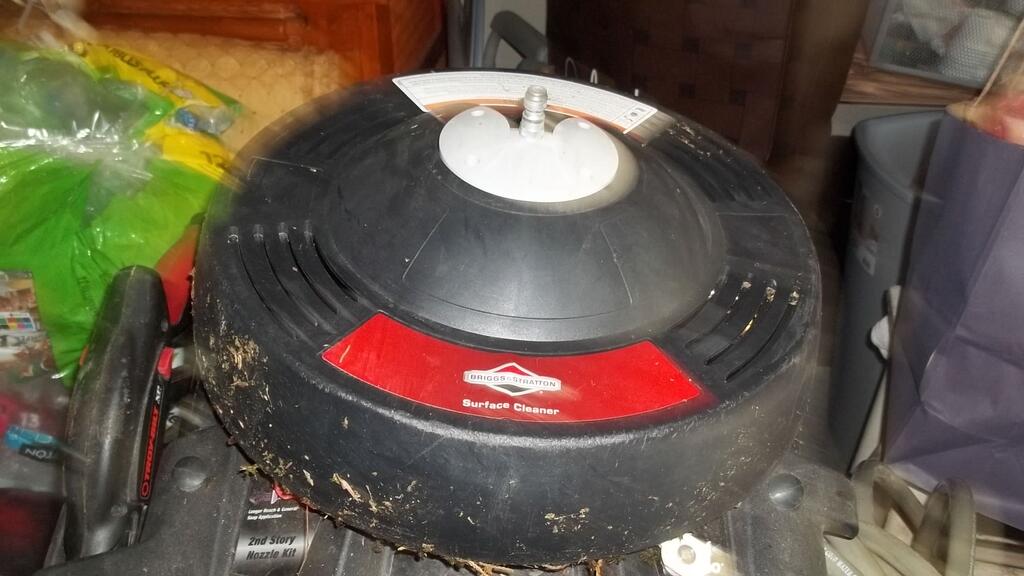

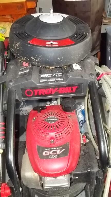

953 nut 65,324 #17 Posted April 13, 2024 I have had good luck with my ten year old Troy Bilt. The extra cost for the Honda engine was well worth the money in my opinion. If you are doing decks, sidewalks etc, the B&S Rotary head is a must. It gives a nice uniform finish and if you are working next to flower beds it won't blow mulch and dirt around. https://www.google.com/search?q=rotary+pressure+washer+attachment&rlz=1C1JZAP_enUS981US981&oq=rotary+pressure+washer&gs_lcrp=EgZjaHJvbWUqDwgDEAAYQxiABBiKBRjkBTIRCAAQRRg5GEMYgAQYigUY5AUyBwgBEAAYgAQyDwgCEAAYQxiABBiKBRjkBTIPCAMQABhDGIAEGIoFGOQFMg8IBBAAGEMYgAQYigUY5AUyDwgFEAAYQxiABBiKBRjkBTIKCAYQABiABBjkBTIKCAcQABiABBjkBTIKCAgQABiABBjkBTIKCAkQABiABBjkBdIBCTE4NzI5ajBqN6gCALACAA&sourceid=chrome&ie=UTF-8 1 1 Share this post Link to post Share on other sites
