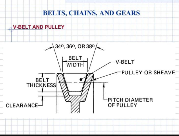

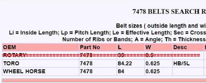

daveoman1966 3,884 #5 Posted April 13, 2024 I have (had) a Wheelhorse 1-0460 ... 1973 No Name 12hp Auto. Your best bet to resolve and belt problems is to get the OEM V-belt which is #7478. These older Wheelhorse tractors had proprietary pulleys ---requiring PRECISE fit of V-belts to PERFECTLY match the geometry of those pulleys. Get the OEM belt 7478 and be done with it....may be a few bucks more but should solve your problems----PRESUMING original pulleys are on the tractor. 1 Share this post Link to post Share on other sites
squonk 48,133 #6 Posted April 13, 2024 (edited) You don't need an OEM belt. I just put a new 5L840 belt on my 76 C 160 hydro . Basically the same tractor. Works fine. The belt that was on it was a 5L840. Sounds like you got something routed wrong. The 7478 belt crosses to a 5L840 Another possibility. Did the 84" belt you get actually say 84 on the belt? People return belts and get the sleeves mixed up all the time. Make sure it's an 84" belt. Also. Did you buy a "B84"? A B84 is actually a 81" belt. Here is a picture of my tractor with the 5L840 belt. Parking brake in the on position. Edited April 13, 2024 by squonk 2 Share this post Link to post Share on other sites
TJN 18 #7 Posted April 16, 2024 Messrs ebinmaine, wallfish, lee1977, daveoman1966, squonk, Hey guys many thanks for the responses! I'll try to answer in order to your posts. ORIGINAL (REALLY) belt measured 851/8". With park brake on the 84"belt is TOO TIGHT, (handle won't go down). With 85" belt it WILL go down, (brake off). Belt then COULD be tighter, but looks like original belt did. I don't see any cracks, ANYWHERE. EVERY part is original (I bought it new). Belts are Marked 5L840 & 5L850. The 5L840 is cross referenced with the stock #7478, but is TOO damn tight. I'll stay with the 85" belt. With the brake OFF (handle down) the 85" belt looks like it has more slack than necessary, but so did the original one and it didn't slip! The 84" belt is so tight that the brake handle will only stay in the up (on) position. NO way to push it down. Thanks again for the info, the no name horse and I will sleep better tonight! Wheel horse's are fun! Tom 1 Share this post Link to post Share on other sites
