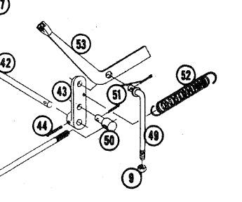

rmaynard 17,218 #2 Posted April 11, 2024 Are you referring to item #53? Check with our vendors for a good used one: K&B Horse Parts A-Z Tractors or RedMan's Wheel Horse Bone Yard 1 Share this post Link to post Share on other sites
Achto 31,898 #3 Posted April 11, 2024 10 hours ago, fourwheelhorseman said: I’m in need of the lever and plastic knob. I looked at Wheelhorse parts and more and came up with nothing. Here is a link to the knob. https://wheelhorsepartsandmore.com/product/early-60s-triangle-knob/ I cut a new lever out of some 10ga sheet metal, fortunately I had access to an original to use as a pattern. Share this post Link to post Share on other sites

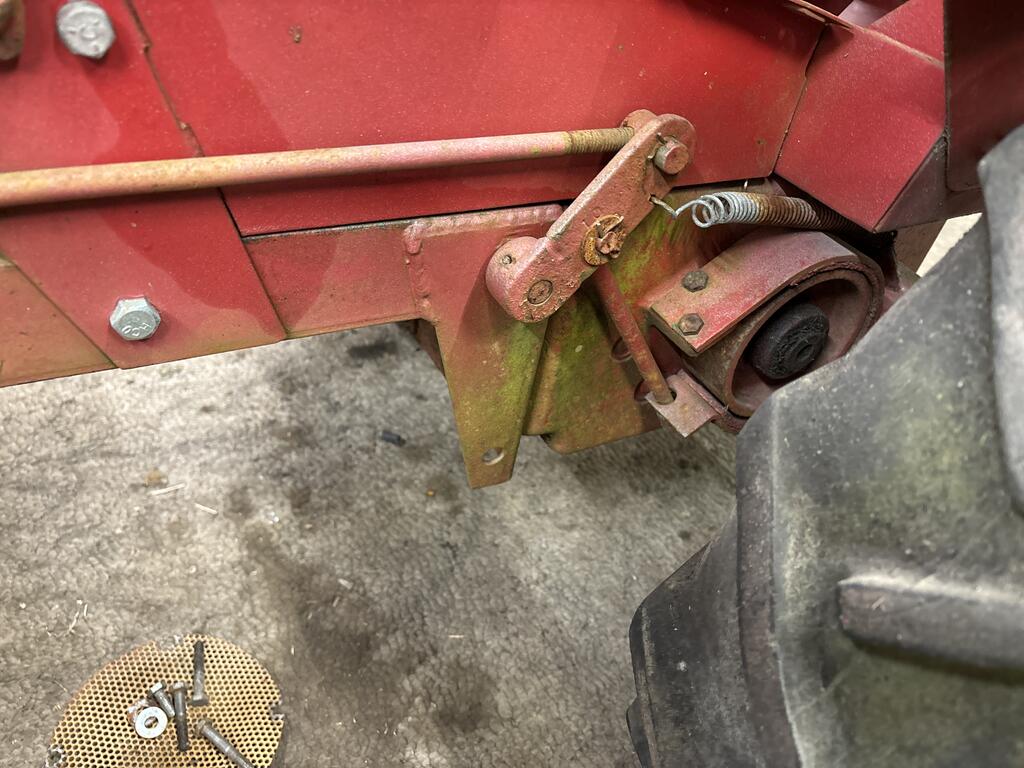

fourwheelhorseman 362 #7 Posted April 12, 2024 According to the diagram a few threads up.. what do I have? Or should I ask what am I missing besides the parking brake lever? Share this post Link to post Share on other sites
WHX?? 56,844 #8 Posted April 12, 2024 Definitely not the same as IPL and looks like nothin else missing. Shouldn't the spring be hooked to the brake lever fellas? Hang loose we'll get some pics of how should be or what works. Share this post Link to post Share on other sites

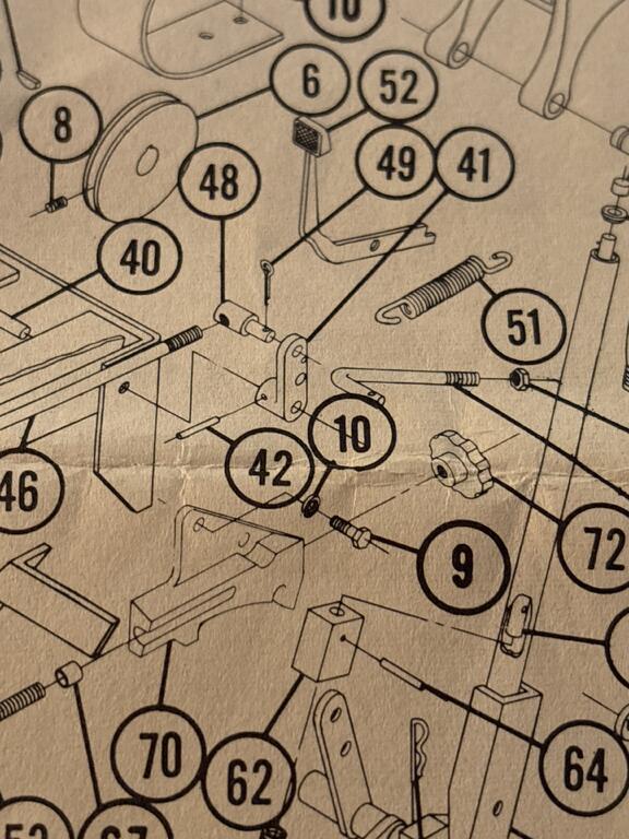

fourwheelhorseman 362 #9 Posted April 12, 2024 I think it’s a different set up, I’m starting to put two and two together, so the gentleman I got the tractor from sent me a couple of manuals in the mail, the manuals are for a 604,654 and 704, the belt guard says 854,I know it’s not an 854 for sure due to the hood length, anyhow look close at the schematics of this manual, it’s the correct one I think.. Share this post Link to post Share on other sites
fourwheelhorseman 362 #10 Posted April 12, 2024 Notice the brake lever, it has a step at the end, also a slight step in the middle where it bends. Compared to the diagram that was shown earlier in the thread.. I’m wondering if they will even interchange now? Share this post Link to post Share on other sites

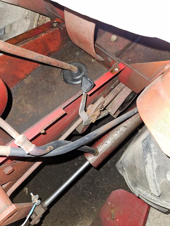

Mike'sHorseBarn 3,559 #11 Posted April 13, 2024 I think your tractor is a kind of a hodge podge of parts. I have an 854 that's cobbled together like that. I'm attaching a picture of what the original 753 setup looks like. 1 Share this post Link to post Share on other sites
