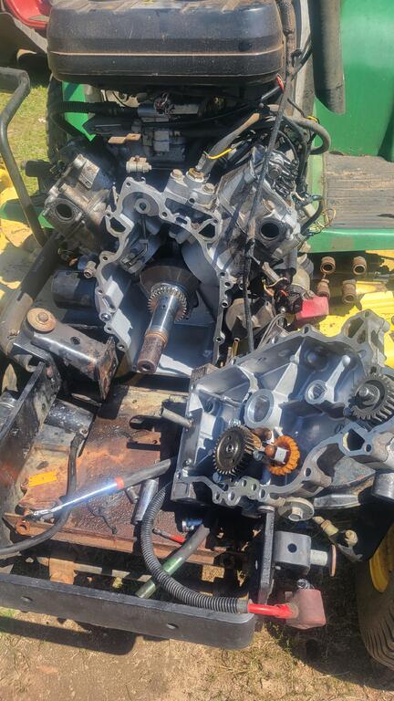

RED-Z06 2,718 #2 Posted April 9, 2024 FD engines produced prior to mid 1998 had plastic cam gears, the water pump gear, and oil pump gears are plastic. Water pumps last about 900hrs, dont let anything happen to the radiator...($$). If the oil gets diluted from fuel, or water, or just nasty from neglect..they would chew up the main bearings and seize. Share this post Link to post Share on other sites
