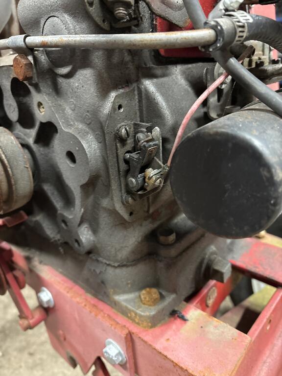

fourwheelhorseman 362 #1 Posted April 7, 2024 I was just looking at my fine new tractor reassembling the starter generator and noticed somthing I’ve not ever noticed till now… I’m missing g the points cover as well as the small screws to hold it on! Anyone have an extra that they would let go of? 2 Share this post Link to post Share on other sites
ebinmaine 80,081 #2 Posted April 7, 2024 What's the distance between the bolt holes? Share this post Link to post Share on other sites
squonk 47,733 #3 Posted April 7, 2024 All K series Kohler points covers are the same. I have a cover but no grommet or screws 1 Share this post Link to post Share on other sites

ebinmaine 80,081 #5 Posted April 7, 2024 53 minutes ago, fourwheelhorseman said: the screws are probably going to be the hardest thing to find. I'd bet if you borrowed a screw from another Kohler and took it to a good hardware store they'd have a few. Alternatively, I could get you the size and head type and you could get some from K. L. Jack or Bolt Depot or McMaster Carr. Share this post Link to post Share on other sites
ri702bill 12,696 #6 Posted April 7, 2024 New aftermarket cover and seperate gasket available on the "Jungle" site - not exactly cheap. No screws. (Same size screw as the 2 that mount the points...) Look on the wire going to the points - the grommet MAY still be there. 1 Share this post Link to post Share on other sites
Achto 32,251 #7 Posted April 8, 2024 5 hours ago, fourwheelhorseman said: I’m missing g the points cover as well as the small screws to hold it on! Those screws are 10-24 x 3/8". Phillips or Allen head, either one will work. Available at any hardware store. 3 1 Share this post Link to post Share on other sites
WHX?? 57,641 #8 Posted April 8, 2024 5 hours ago, squonk said: All K series Kohler points covers are the same. I have a cover but no grommet or screws There ya go ... grommets on flea bay & Kohler shops. 12 minutes ago, Achto said: Those screws are 10-24 x 3/8". Phillips or Allen head, either one will work. Available at any hardware store. Not that it makes any difference you may have a service motor ther. Horizontal coil mount is a tell tale. Share this post Link to post Share on other sites
