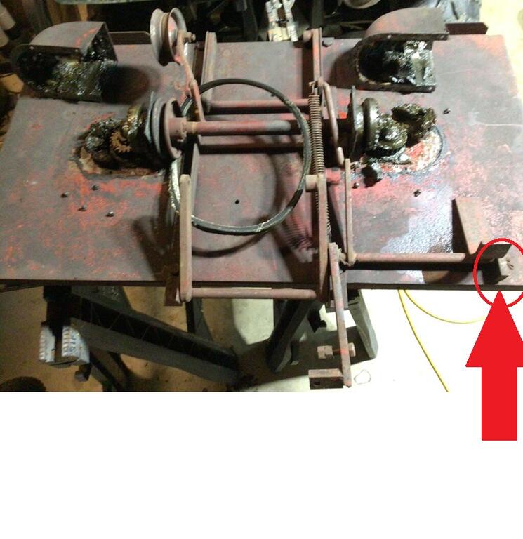

Rattlecan 68 #1 Posted April 6, 2024 Have not posted anything since y’all helped me out with Rj 58 I had just acquired. It’s still running fine, thanks to all the info I got here. I happened across a mower deck that I think fits it. (I learned the first time to post picture). Can anyone verify what deck this is and if it is for a Rj 58 and if it has all its parts. Also, does is there a schematic for it available. The spindles and gears appear to be in descent shape. One spindle has sone slop but haven’t taken it apart until I got some advice here. I don’t know if there are bearings or what under the flat gear on the spindle. I did not see anything in the manuals section here but I could have missed it. Any help will be greatly appreciated. Thanks in advance Share this post Link to post Share on other sites
wallfish 20,506 #2 Posted April 6, 2024 (edited) Yes, that's an RJ deck Maybe this will help Edited April 6, 2024 by wallfish Share this post Link to post Share on other sites
Rattlecan 68 #3 Posted April 6, 2024 That’s perfect. Looks like I have most of the parts intact. Looks fairly straight forward. You helped me out last time too. . Many thanks. 1 Share this post Link to post Share on other sites

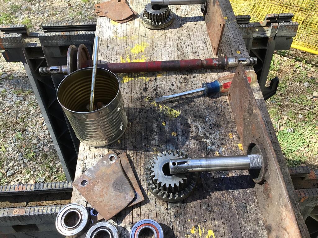

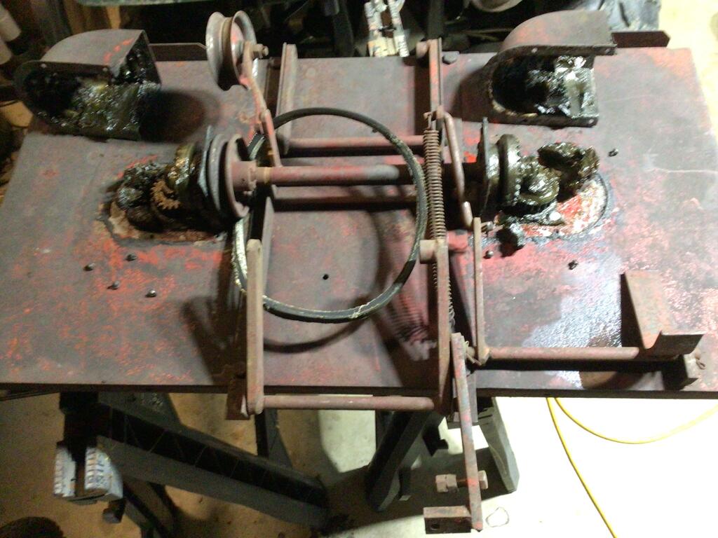

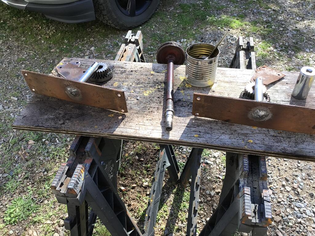

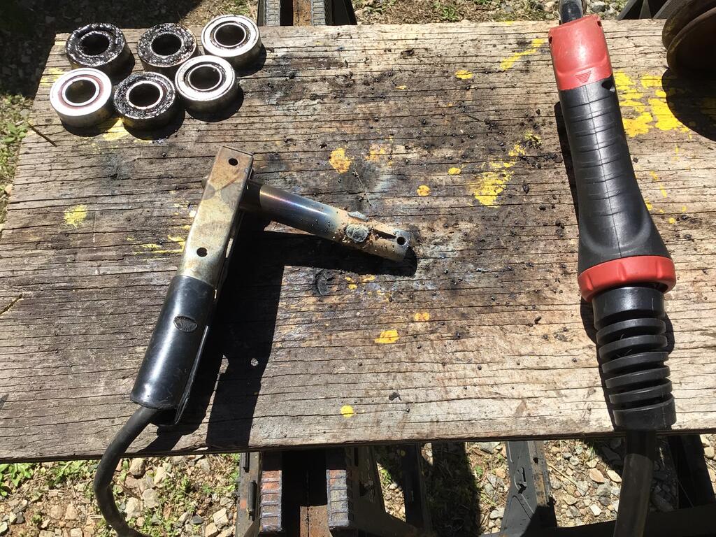

Rattlecan 68 #8 Posted April 7, 2024 Dug into the deck today. One of the spindles had some slop in it and the other one weld was broken at bottom of shaft where the blade is welded on. The spindle with the slop had a bad bearing and cut a groove in the spindle shaft about 1/16 deep and width of the bearing. On the same spindle the gears are worn a little due to the bad bearing but I think there is enough there for it to operate. Bearings on the cross shaft were good and no issues with it. I ground welds off bottom of blade to get the shafts out. I think I’m going to weld up the groove in the shaft and return it on the lathe to bearing ID. And then weld both spindle shafts to the blades again. I ordered 6 new bearings to replace all of them while it is in pieces. Bronze bushing in idler was shot. I think it should be 5/8 I’d and 7/8 old. Still looking for a bronze bushing. Does any one know of a source for the gears. Thanks again. Share this post Link to post Share on other sites

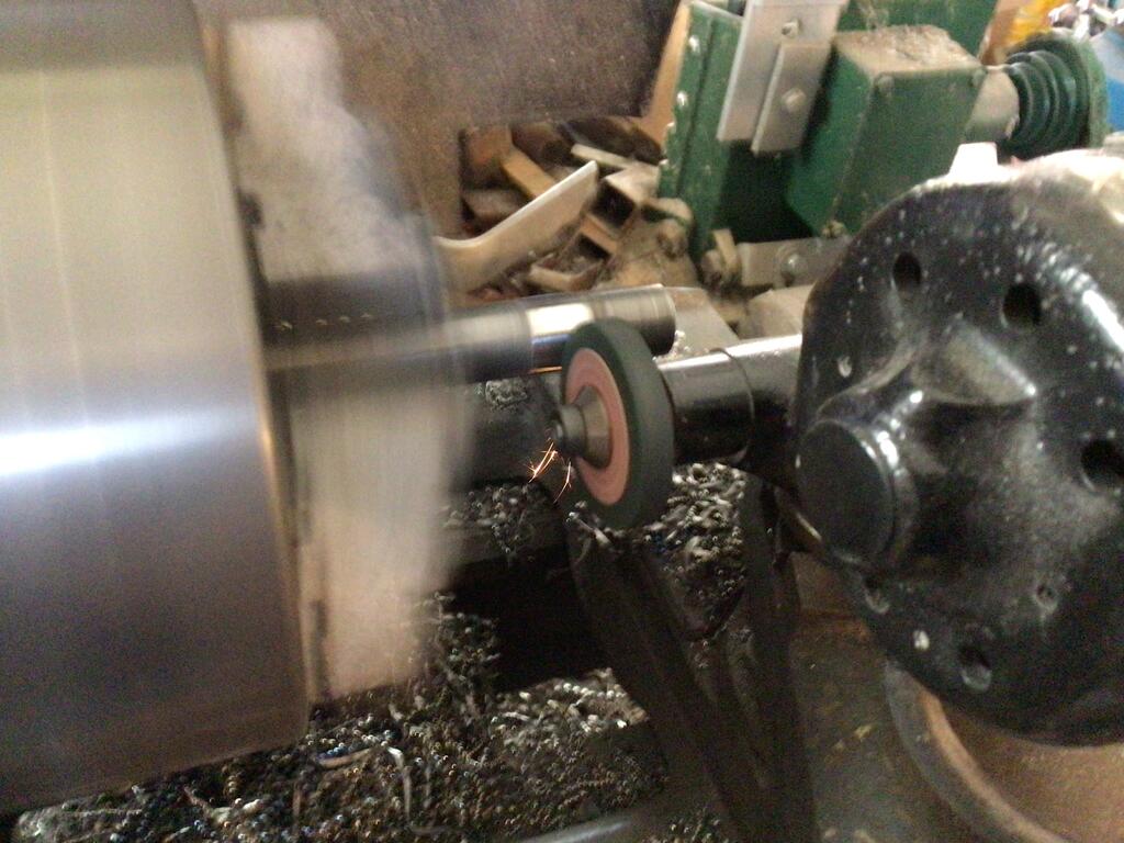

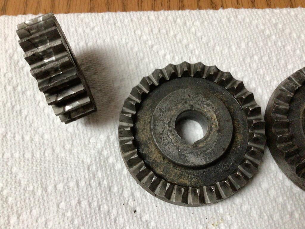

Rattlecan 68 #9 Posted April 8, 2024 Welded up gouged out spindle today. Ground it back down to bearing ID on the lathe and welded spindle shafts to blades. Hung deck shell under the Rj and I think I figured out how it mounts. Went to tractor store and bought idler and made bushing for it, I’m going to use it until I can find bronze bushing for the original. One of the gears is not in great shape, any help with finding one would be much appreciated. I included some photos in case anyone is interested. Thanks in advance for any help with gears. 1 Share this post Link to post Share on other sites
wallfish 20,506 #10 Posted April 8, 2024 (edited) How bad are the gears? Don't look too bad from the pic but... They would typically wear off one side of the teeth rounding the engaged side of the teeth. Could it work by swapping the gears to the other side as that would put the "good side" of the teeth on the engaged power side of them. At least until you can find replacements. Just kind of think'n out loud again. Tend to do that a lot. Those gears can be found on later Suburban decks too. Put a wanted ad in the classified section on here. Try calling AZ tractors from the vendor section. Edited April 8, 2024 by wallfish Share this post Link to post Share on other sites

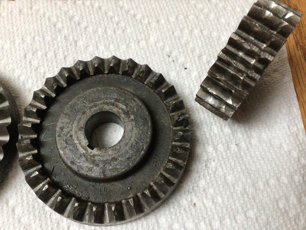

Rattlecan 68 #11 Posted April 8, 2024 First pic is the set I have concern with. Your thoughts Share this post Link to post Share on other sites
wallfish 20,506 #12 Posted April 8, 2024 (edited) Hmm. looks like it was tilted and digging in and wearing edges and skipping. Flip'em and run'em until you can find replacements. They're already broke so see if it works. Come to think of it, they might be same gears for any gear driven deck. I'll take a look and see if I have anything around but I give mower decks away since I don't use them. AZ should have gear drive decks that the shell is wasted Edited April 8, 2024 by wallfish Share this post Link to post Share on other sites

WHGuy413 2,859 #16 Posted September 20, 2025 Hey @Rattlecan any chance you are still active here and could get some up close of pictures of how your deck attaches and the idlers and how they are engaged? I have a deck just like yours. It’s missing the pedal is to engage the belt and I’m having a hard time finding quality pictures of how any of it goes together. Share this post Link to post Share on other sites
wallfish 20,506 #17 Posted September 20, 2025 19 hours ago, WHGuy413 said: Hey @Rattlecan any chance you are still active here and could get some up close of pictures of how your deck attaches and the idlers and how they are engaged? I have a deck just like yours. It’s missing the pedal is to engage the belt and I’m having a hard time finding quality pictures of how any of it goes together. Are you 100% sure what you have is an RJ deck? Suburban decks did not use a pedal on the deck but look very similar otherwise. It would have this pedal support block on it for RJ 1 Share this post Link to post Share on other sites
WHGuy413 2,859 #18 Posted September 21, 2025 16 hours ago, wallfish said: Are you 100% sure what you have is an RJ deck? Suburban decks did not use a pedal on the deck but look very similar otherwise. It would have this pedal support block on it for RJ I’m sure it’s a suburban deck. It has never had a pedal on it at all. There are no marks from welding and the paints all there. Share this post Link to post Share on other sites
wallfish 20,506 #19 Posted September 21, 2025 A 400/550 deck uses the rear hitch for the lift 401/551 deck would have 4 wheels on it Post a separate thread asking for the Suburban deck engagement stuff. I don't have one to help you out 1 Share this post Link to post Share on other sites
