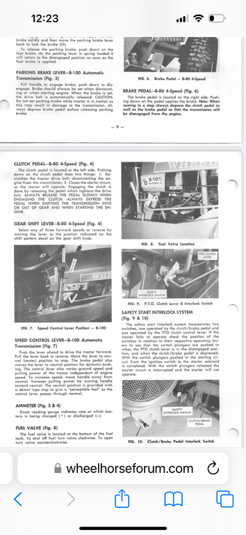

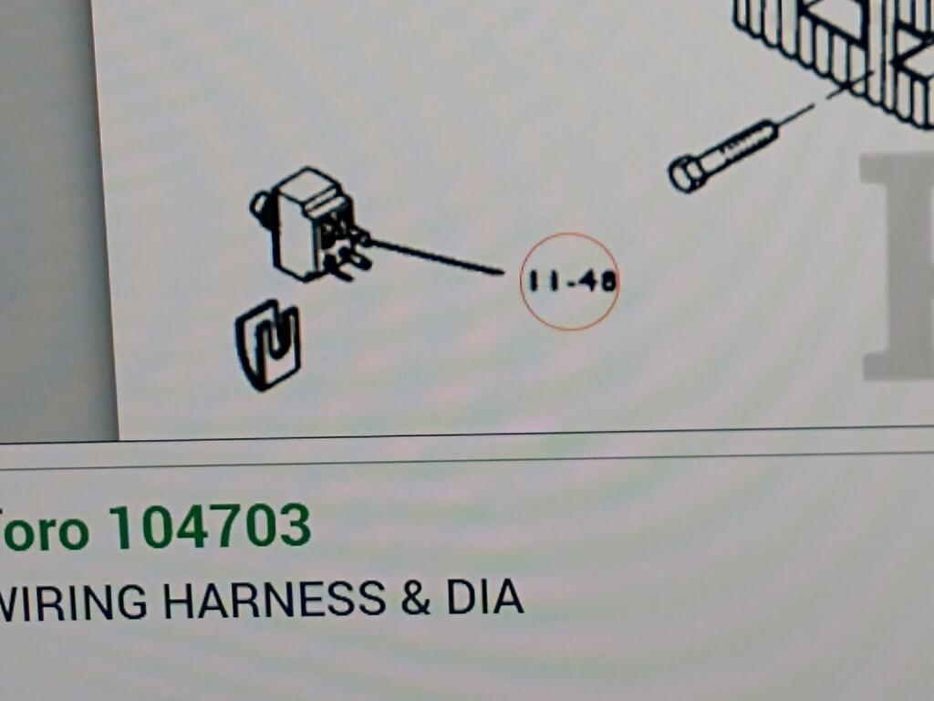

gwest_ca-(File Mod) 12,066 #6 Posted April 5, 2024 Just a guess. Click on the picture for more Share this post Link to post Share on other sites

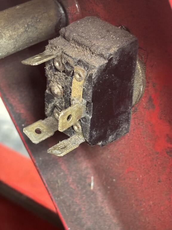

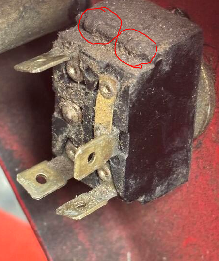

JoeM 9,675 #10 Posted April 5, 2024 (edited) Lane I have fixed those switches by removing the base from the housing and cleaning the contacts inside. just be careful small parts inside. Have to gently bend the circled tabs back. I believe one set of those contacts is for the seat start circuit ??? I have bought less expensive single pole switches for to stop the machine from starting with the pto on but not using the seat sw. Edited April 5, 2024 by JoeM 2 1 Share this post Link to post Share on other sites

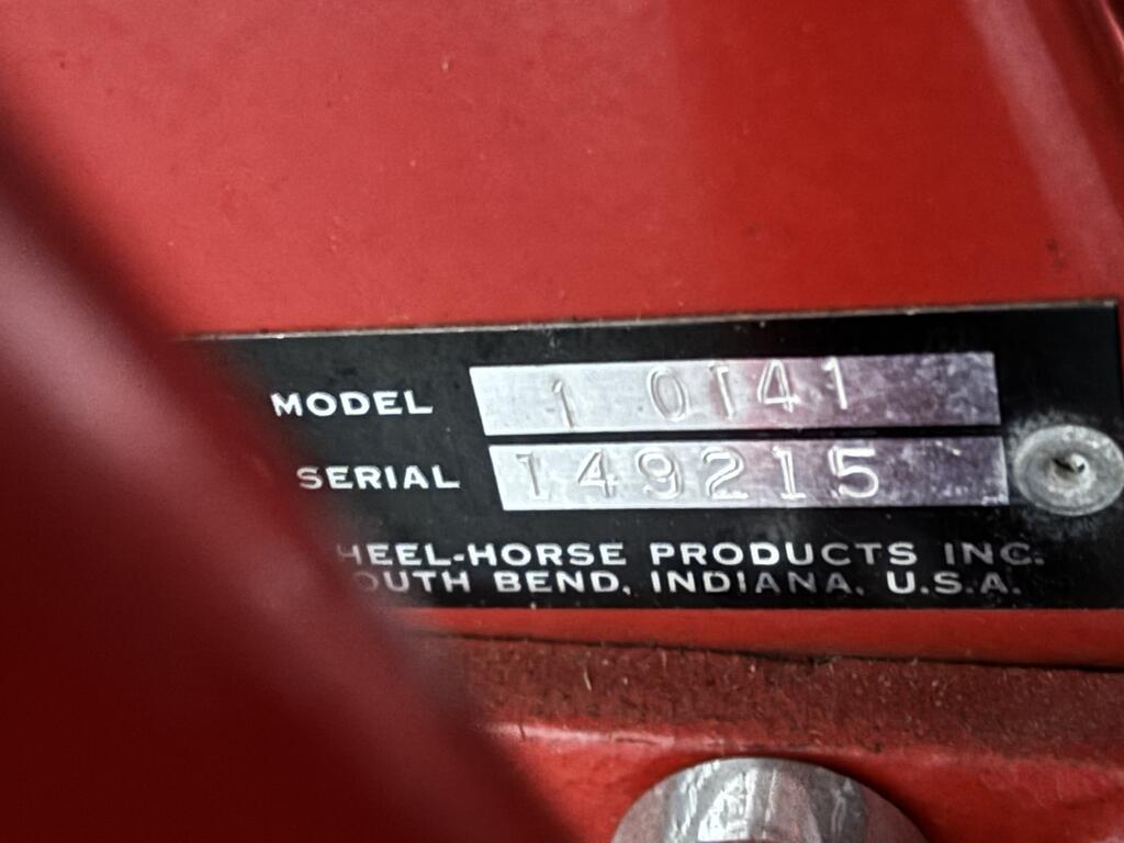

Lane Ranger 11,881 #11 Posted April 5, 2024 2 hours ago, gwest_ca said: Just a guess. Click on the picture for more yes that is it! My B-80 is a 1975 . 1-0141 ., 149215 Share this post Link to post Share on other sites
squonk 45,805 #12 Posted April 5, 2024 (edited) Parts tree lists that as the clutch switch. See what I mean about listings? Picture in the parts breakdown looks right at least! Edited April 5, 2024 by squonk 1 Share this post Link to post Share on other sites

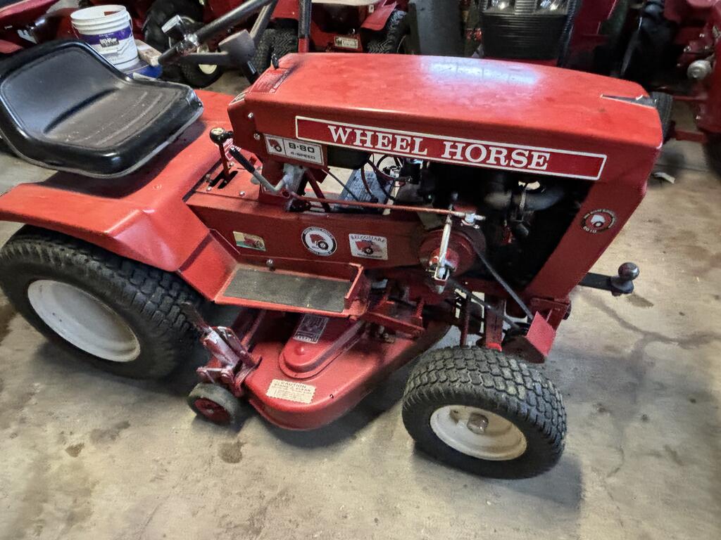

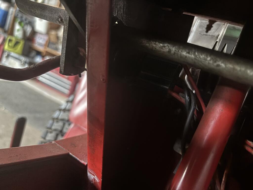

Lane Ranger 11,881 #14 Posted April 5, 2024 (edited) thank you guys! I found a brand new old stock one! so I will replace! I guess I will have to use my self propelled push mower tomorrow! This photo shows how it was installed on my 1975 B-80. Edited April 5, 2024 by Lane Ranger 1 Share this post Link to post Share on other sites
