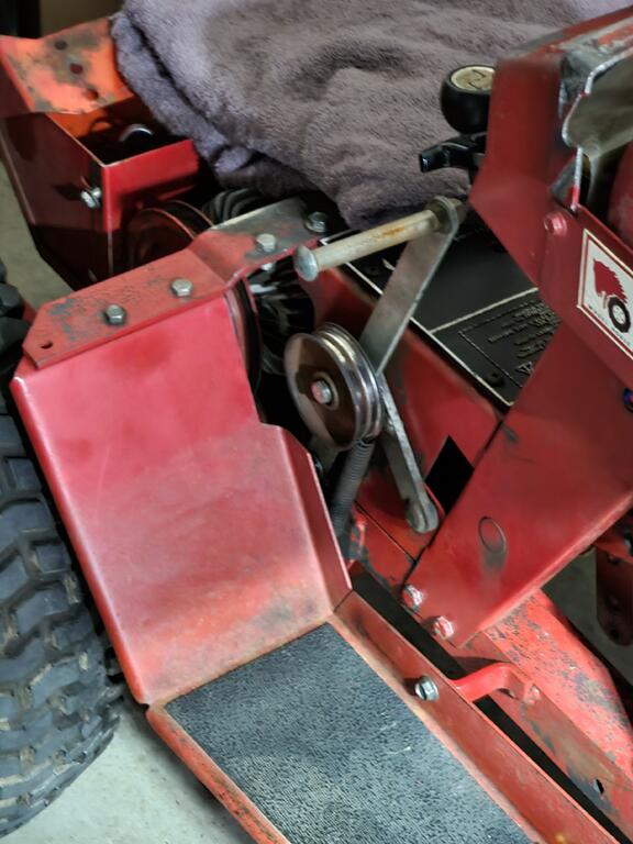

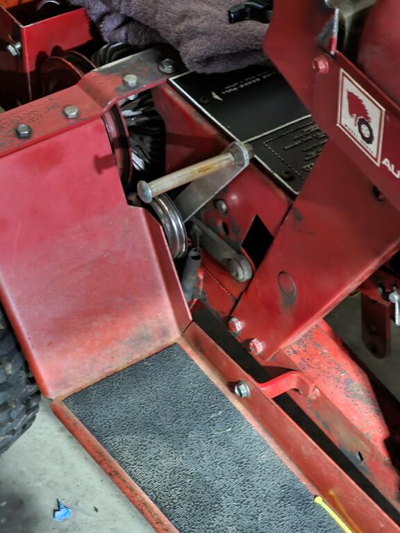

TJN 18 #8 Posted April 5, 2024 Hey guys, ebinmaine, 953nut,gwest_ca,wallfish, MANY THANKS! Thanks to you all I finally know what I have! It's bothered me since I purchased it in 1973! Now that all of the brains are gathered, please help with another issue. I replaced the drive belt with a 5/8"x84" unit. Now the damn thing is so tight, that the idler pulley is all the way Up as is the brake handle that it's connected to! I measured the outside DIAMETER (old belt) and got 851/8". The old one is oem (believe it or not), so it undoubtedly stretched a little. The Wheelhorse table called for the 84" belt, watcha all think? (no luck)..... TJN 2 1 Share this post Link to post Share on other sites
ebinmaine 77,276 #9 Posted April 5, 2024 1 hour ago, TJN said: Hey guys, ebinmaine, 953nut,gwest_ca,wallfish, MANY THANKS! Thanks to you all I finally know what I have! It's bothered me since I purchased it in 1973! Now that all of the brains are gathered, please help with another issue. I replaced the drive belt with a 5/8"x84" unit. Now the damn thing is so tight, that the idler pulley is all the way Up as is the brake handle that it's connected to! I measured the outside DIAMETER (old belt) and got 851/8". The old one is oem (believe it or not), so it undoubtedly stretched a little. The Wheelhorse table called for the 84" belt, watcha all think? (no luck)..... TJN Taking a quick poke around Redsquare I believe 5/8 x 84" is the correct size. But.. That doesn't mean the belt is sized right or something's not been changed along the way. Can you post a measurement and pics of the belt AND the belt idler pulley? Share this post Link to post Share on other sites

TJN 18 #16 Posted April 6, 2024 Look at the elevation differences between the tension pulley (up with the new belt, down without). I cut the damn belt off, it measures +/- 835/8", about 4" short! (measured required length by holding the belt in place and measuring the void between the ends.) Nothing I've seen calls for a +/-87"-88" belt. Tom. P. S. old belt measured 851/8", no doubt stretched bit. Share this post Link to post Share on other sites

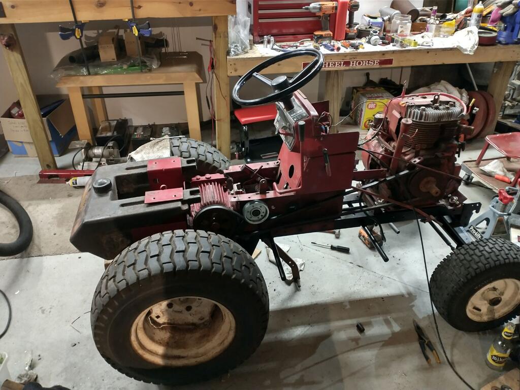

ebinmaine 77,276 #19 Posted April 7, 2024 What brand and type new belt did you buy? And how was it routed after installation? I've installed more than one incorrectly and had to fix my error. This image is a late 70s C121 we just built. It's a little dark but the only pic I have handy. Note the location of the idler OVER the belt and note the location of the belt routing near the middle. This tractor is slightly different from your own.. But the point is that your belt guides need to be properly oriented with the belt. The guides in this pic are on the steering tower whereas yours MAY be on the belt guard. Share this post Link to post Share on other sites
TJN 18 #20 Posted April 7, 2024 Ebinmaine, the belts (84"&85") are "USA/oem, 3 year warranty" . Should arrive in about a week. The belt will be routed around the trans and electric clutch pulleys, also UNDER the idler pulley as the former factory pulley did. That pulley is used to tighten the belt when moving (handle down) and as an "emergency" brake when pulled up. All of the sources that I've seen recommend an 84" belt, so I'm repurchasing same AGAIN. I'm also purchasing an 85" belt as insurance. One or both may be returned in favor of probably an 86" belt. As previously stated the factory belt (51 years old) measured 851/8", and surely was stretched a bit. The newly ordered belts are also Kevlar based. I hope that this answers your questions. Tom 1 Share this post Link to post Share on other sites

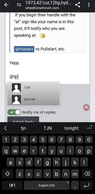

Pullstart 68,848 #21 Posted April 7, 2024 Hey @TJN It looks like the guys are helping you out how you need, and even teaching you ‘puter stuff too! If you begin their handle with the “at” sign like your name is in this post, it’ll notify who you are speaking at. @Pullstart vs Pullstart, etc. Share this post Link to post Share on other sites
ebinmaine 77,276 #22 Posted April 7, 2024 33 minutes ago, Pullstart said: Hey @TJN It looks like the guys are helping you out how you need, and even teaching you ‘puter stuff too! If you begin their handle with the “at” sign like your name is in this post, it’ll notify who you are speaking at. @Pullstart vs Pullstart, etc. Yepp. @TJN Here's screenshot of what happens when I use your handle. I then poke your name and it ads a "mention". That's how it comes up highlighted. Blue on my phone. Share this post Link to post Share on other sites
