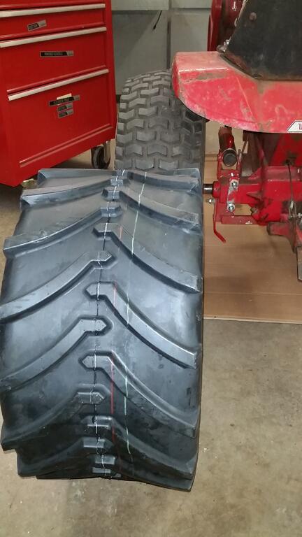

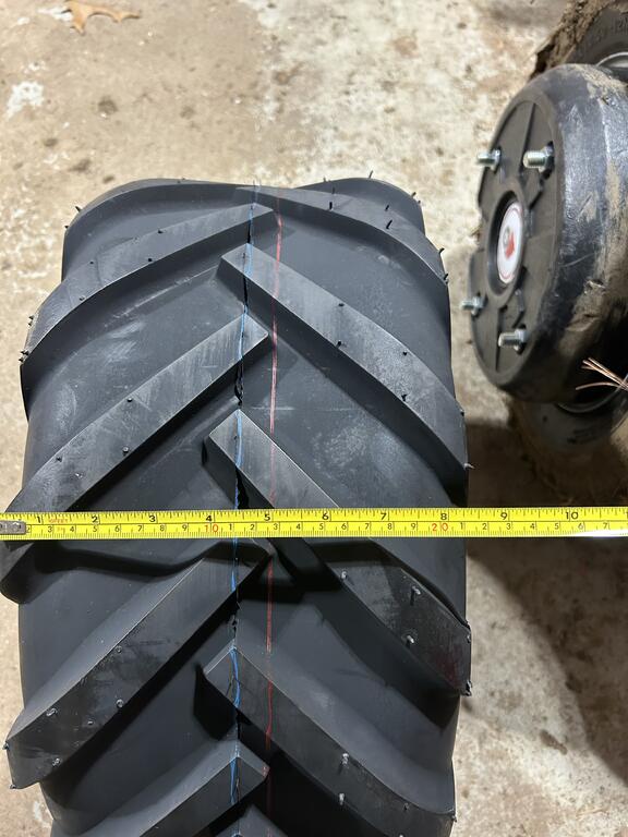

WheelHorseVH 110 #1 Posted April 4, 2024 What is this garbage? I ordered these highly rated Deestone ags off amazon and got them delivered today. These are supposedly 23x10.5x12 but they look absurdly tiny in front of my currently installed Dico turf tires. They measure barely over 8” of tread width uninstalled. Even if the sidewall balloons out I dont see how these will look right on my 520 wide wheel. I am thinking of sending them back tomorrow and coughing up the (much) extra dough for Carlisle Tru Powers instead. I hate to base this too much on looks but I REALLY like the squared aggressive look of the ags some of you have posted vs the rounded ones. Do I just go with the Tru Powers or what? 3 Share this post Link to post Share on other sites
ri702bill 13,077 #2 Posted April 4, 2024 Deestones are notorious for running on the small side...... 2 1 Share this post Link to post Share on other sites
mrc 1,119 #3 Posted April 4, 2024 i'll second what ri702bill said. if you can afford it, send them back and get what looks good on there. the reason is simple. they will be on there for a loooooong time! regards mike 3 1 Share this post Link to post Share on other sites
ebinmaine 80,755 #4 Posted April 4, 2024 I have no real world experience with Deestone AG tires but we do have a set of the 8" wheel tri ribs. The tri ribs run fairly true to size. As stated above, the AGs unfortunately are infamous for being absolutely tiny in comparison to every other tire of the same written size. As to quality, I can't say as I've read anything bad about the Deestones but it's important to note that they haven't been on the market long enough to compare to some others. Another thing important to note is that we here have aggressive terrain in sharp rocks 🪨 and sticks 🌳🌲🪵 but NO tire poking thorns as I understand some regions do. You could go several ways. Return the wee bitty tires and attempt to find a written/ stamped size that matches the physical attributes of your current tires. There are websites that list the ACTUAL size of some tires. Not all. It may be worth your time to contact a few sellers like Simpletire.com to see what they list for ACTUAL sizes. Note, I capitalized again. Find a (mid-grade??) tire that'll be a compromise between the great pricing of the Deestone and the correct but expensive Carlisle. Was it me? I know this isn't my money to spend but I'd get the Carlisle Tru Power tires and never look back. I "found" them because of my work. We've used them (and others) on off-road forklifts. They're tough, they wear well, a good tire. I have a set here that's been on at least 4 of my own tractors as they switch chores. I think maybe 6 or 7 seasons of year round work combining forest and snow plowing duties. I bought mine heavy-duty on purpose. 6 ply Commercial grade. That's not the right decision for everyone. Mine were fluid filled when new. I've never added air. 1 Share this post Link to post Share on other sites
JoeM 10,289 #5 Posted April 4, 2024 (edited) The Deestone 405 tires they are pretty tough 6 ply. Yes, they run smaller to size and don't have that monster tire look. There probably is several threads here covering the smaller to size issue. The jungle site reviews can be dicy. I have run them on a couple FEL machines with no issues. i have also ran the tru powers. I seen no difference in traction or durability other then the later is much more expensive for the look. Really can't tell you what to do just what I know. These are the deestones on the loaders. Pretty sure I put them on 7 inch wide rims. Edited April 4, 2024 by JoeM 3 Share this post Link to post Share on other sites
Pullstart 71,264 #6 Posted April 4, 2024 They are indeed smaller, but we have covered this subject many times, enough that it shouldn’t be much a surprise to anyone any more. I love the way my Deestones perform and have held up, but they are indeed smaller than they claim to be. 1 Share this post Link to post Share on other sites

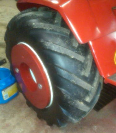

Sparky-(Admin) 26,385 #9 Posted April 4, 2024 I had a set of the 8.5 Deestone AG’s …they were tough and wore well. They are smaller as we all know and I feel they are better suited, as far as looks go, on a 60’s short frame and not a 520/H (for example). The folks who bought em off me installed them on a 60’s short frame and I think they look proportional and great. Share this post Link to post Share on other sites

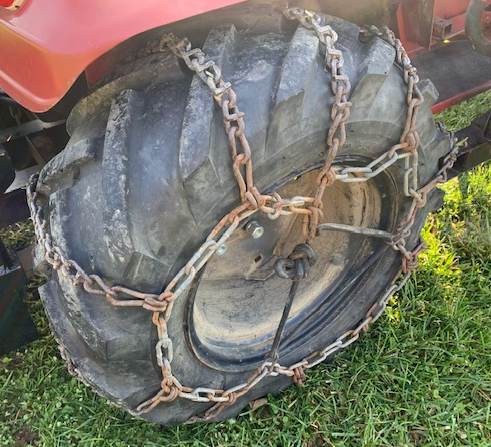

rmaynard 17,582 #13 Posted April 4, 2024 Interestingly, I had a set of Carlisle 23 x 9.5 x 12 tires on the rear of my 416-H. I had a set of snow chains that fit perfectly. When the time came to replace the tires, I did so with Deestone 23 x 9.5 x 12's. I could not get the show chains on because the Deestones were wider than the Carlisles. Go figure. 1 Share this post Link to post Share on other sites

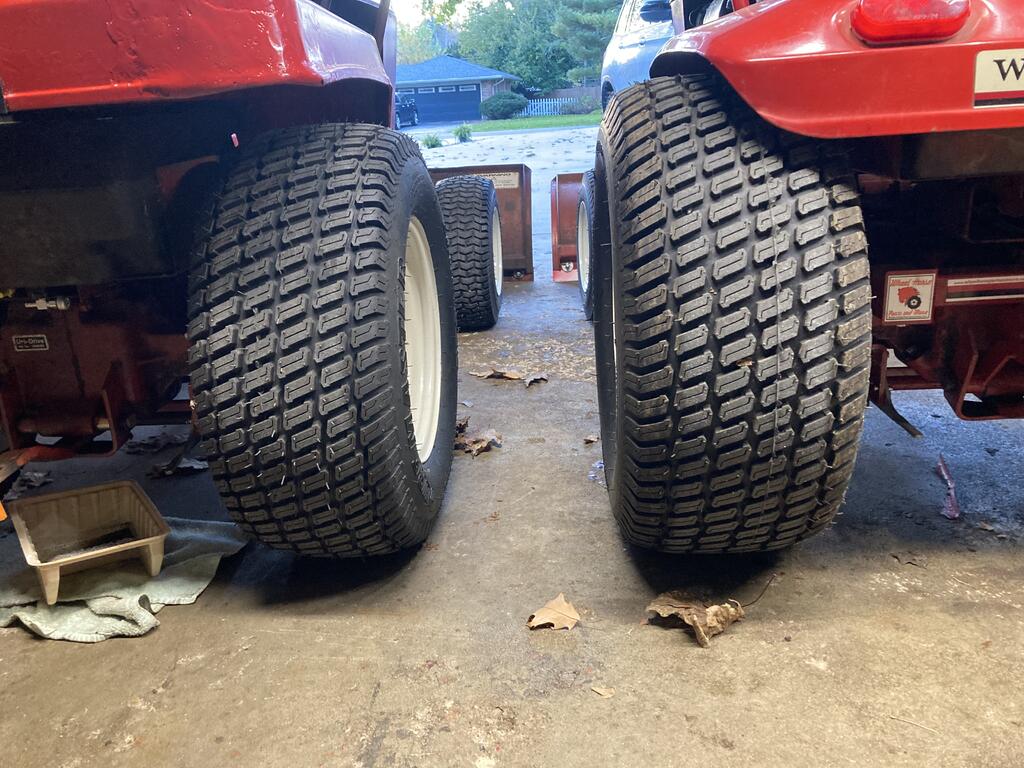

SylvanLakeWH 32,568 #15 Posted April 4, 2024 It's not just Deestones... 23x10.5x12 Carlisle's same size bought about 2 years apart... Right - made in USA... Left - not made in USA... 1 Share this post Link to post Share on other sites
JoeM 10,289 #16 Posted April 4, 2024 3 hours ago, SylvanLakeWH said: It's not just Deestones... 23x10.5x12 Carlisle's same size bought about 2 years apart... Right - made in USA... Left - not made in USA... That is interesting. big difference. Share this post Link to post Share on other sites

Sparky-(Admin) 26,385 #18 Posted April 4, 2024 5 hours ago, ebinmaine said: Hey thanks for the reminder!! I'd forgotten... those were what's on Millie tractor right? Correct! 1 Share this post Link to post Share on other sites
ebinmaine 80,755 #19 Posted April 4, 2024 1 hour ago, Sparky said: Correct! Me n my memory..... So yeah....... 7 hours ago, Sparky said: The BBT who bought em off me installed them on a 60’s short frame and I think they look proportional and great Agreed. 18 hours ago, WheelHorseVH said: Deestone For the record, Trina does like the performance of these tires. But Mike's right. They look sized about right for a small 60s short frame rig. Share this post Link to post Share on other sites

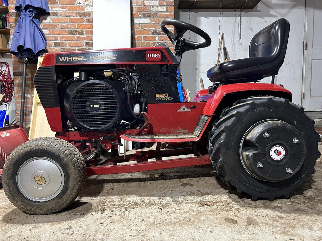

WheelHorseVH 110 #21 Posted April 6, 2024 I decided to return the Deestones and get Carlisle tru powers. Fortunately they arrived before I got the Deestones sent back so I could truly compare. Heres a picture of them side by side. I guess I never knew that tire sizes had become “nominal sizing”. I always thought that it was exact. Like 235/45r15 was supposed to represent the exact amount of rubber used in the cross section, height, etc. If that is not the case, manufacturers should be required to put ACTUAL dimensions on every tire. @mrc Mike you are right, these are gonna be on there a very long time so I decided to bite the bullet instead of being unhappy every time I look at them installed. 1 2 Share this post Link to post Share on other sites
ebinmaine 80,755 #22 Posted April 6, 2024 4 hours ago, WheelHorseVH said: manufacturers should be required to put ACTUAL dimensions on every tire Absolutely agreed 4 hours ago, WheelHorseVH said: 235/45r15 was supposed to represent the exact amount of rubber used in the cross section, height, etc Vehicle sizes have always been much closer but still vary some, depending on tire type in particular, and manufacturer. The cross section measurement is usable for the total outside width so an aggressive tread with squared edges can appear quite different than a more traditional All season. That same difference in tread design can affect the diameter as well. Certainly nothing like the obvious lack of reasoning behind this thread's subject. Share this post Link to post Share on other sites
mrc 1,119 #23 Posted April 7, 2024 hi wheelhorseVH, in the past i bought carlisles for two reasons: #1....USA made #2....ran true to size or very close. not too long ago though i bought some carlisles and they were made offshore. carlisle put "made in XXX" on the bead lip. that way once mounted you could not tell where they were made. pretty sneaky! i did not like that. you made the right decision. over time as you look at your 520 you will say to yourself 'boy those ag's look good' each time that happens the extra money will seem smaller and smaller. BTW, where were the carlisle ag's made? regards mike 1 Share this post Link to post Share on other sites
WheelHorseVH 110 #24 Posted April 9, 2024 @mrc Mike, thankfully they say Made in USA on mine. I got Firestone to mount them for me today. Let me tell you, putting those wheels back on is a chore! Definitely need a studded hub for sure. I am probably not the first person to do this but I got so fed up after trying for 5 min to line up the holes that i put one of the bolts in from the backside of the hub so it kinda stuck out like a stud, hung the wheel on it and threaded the other four bolts in before backing it out and putting it in the right way. Here are the beautiful results: 1 Share this post Link to post Share on other sites
