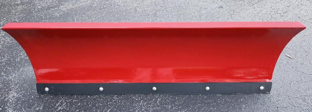

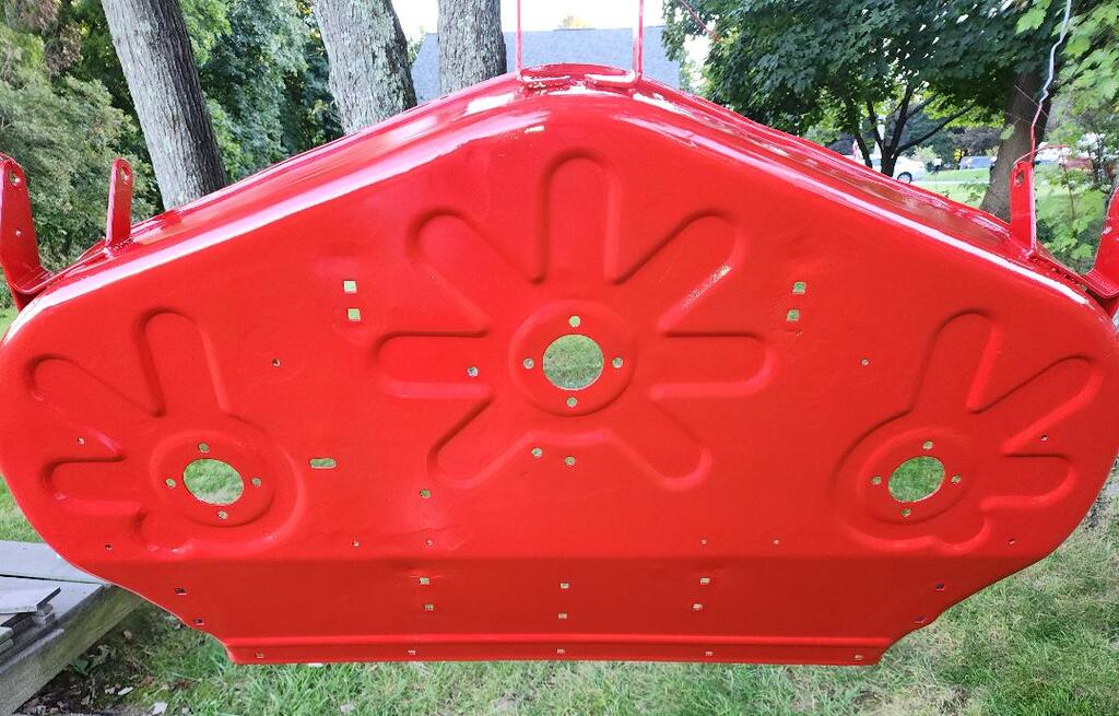

Brockport Bill 2,449 #6 Posted April 2, 2024 i have cleaned rust and paint from mower decks and plows as well as some seat pans and hoods with angle grinder pads as well as had done by professional sand blaster. Angle grinder pads or hand/machine sanding for tins like a hood or seat pan etc may not produce a high quality appearance -- for tins it appears sand blasting is best for the best final appearance. Mostly, I have rehabbed mowers and plows that do not need a perfect "pretty appearance" but still want a fair quality look. I plan to try out sourcing a test project using the laser stripping technology to clean rust and paint -- maybe then I will try some clear coat and other techniques to see the comparison?? Some of the restoration projects we see here on R Sq are spectacular - - far beyond my capabilities - - and the fact some members have professional body work career skills makes me only wish i had that knowledge and ability 6 Share this post Link to post Share on other sites

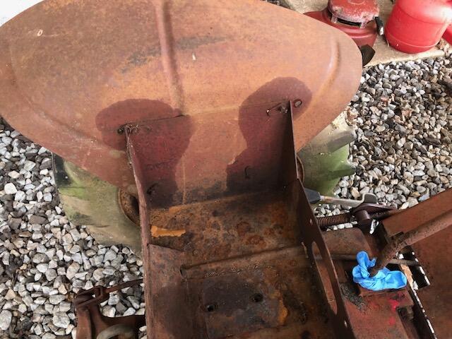

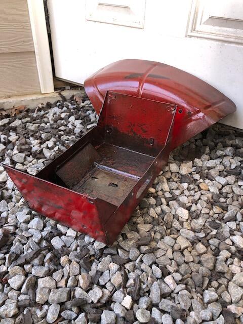

Sailman 1,307 #7 Posted April 2, 2024 (edited) Depends on what you want the finish to be. Full restoration or preserve the patina. I had a horrible finish on a 704 that I used some Loews Rust stripper on first and then finished with Penetrol. Was amazed how much of original paint it salvaged and gave it the patina I was looking for. Great rust inhibitor too. Before - After - Edited April 2, 2024 by Sailman 5 Share this post Link to post Share on other sites

peter lena 9,993 #10 Posted April 2, 2024 @Sailman thats what i,m talking about ! personally think that the average age of a horse , today would call for a patina save , that oil staining is what you want to do , when ever I pick up wheel horse anything , the first thing I do is , give it a lubrication soak / sit . brought back a lot of horse paint , to me its period correct , @Brockport Bill , your recovery paint work is just right , period correct . looks better than just about anything , I run across , pete 2 Share this post Link to post Share on other sites

Sailman 1,307 #16 Posted April 3, 2024 3 hours ago, ebinmaine said: Any chance you can post a pic of that label? It is the Klean Strip Concrete and Metal prep from Lowes - https://www.lowes.com/pd/Klean-Strip-Concrete-and-Metal-Prep-1-GAL/1001456348 The trick is to use it on the tins and let sit for just a couple hours, then scrub it clean with water and brush, then very light wet sand. Dry it good and add the Penetrol. Amazing results. If you leave the Klean Strip over night as they recommend it will leave a blackish film which then needs to be painted. Just a couple hours of Klean Strip removes most of the rust. I was amazed there was actually finish under that rust! Here is what I started with.... . 4 1 Share this post Link to post Share on other sites
