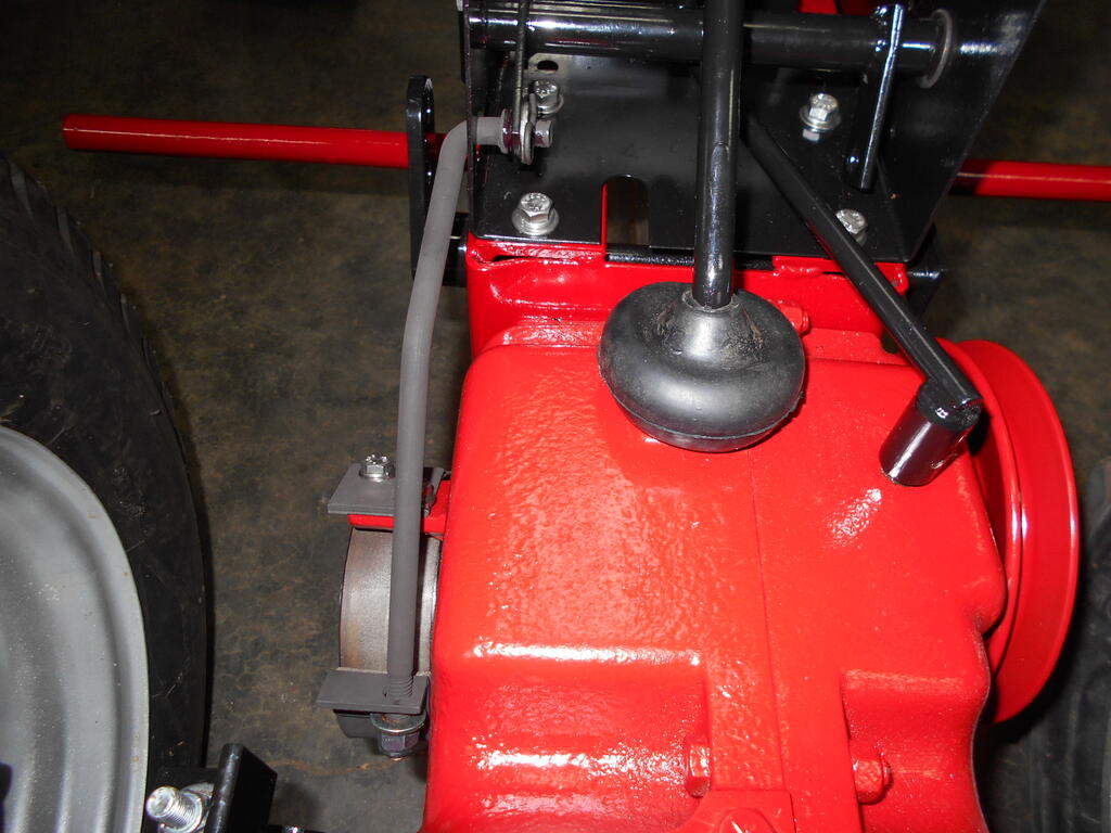

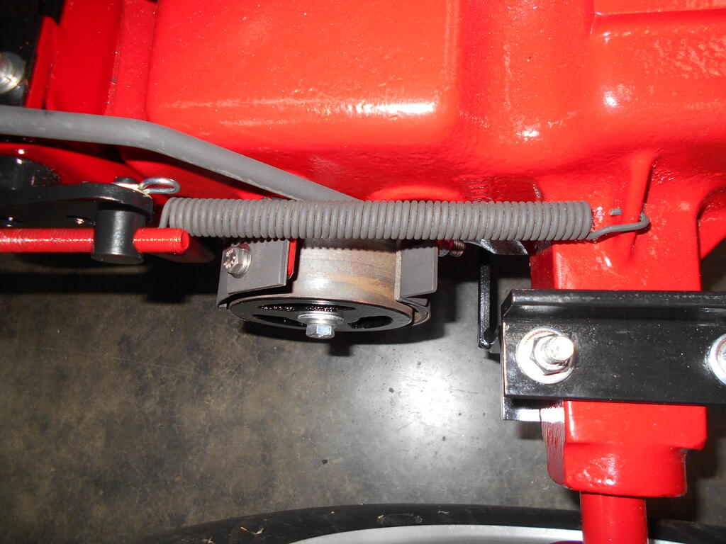

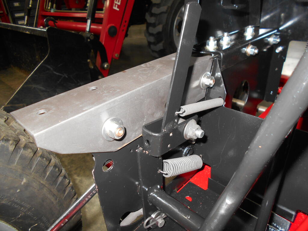

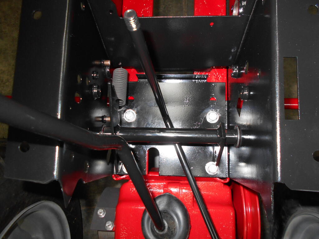

cleat 9,451 #5 Posted April 1, 2024 Brake return spring hooks to the brake bellcrank about half way up on the left side and hooks to the bottom of the reinforcement plate as shown. Parking brake spring hooks from the parking brake latch to the top of the reinforcement plate as shown. Hope this helps. 2 Share this post Link to post Share on other sites
Elwood 1 #6 Posted April 1, 2024 Cleat. Thanks for the great pictures. Looks brand new. Mine has both of the springs attached in the proper locations. The one long skinny spring is for the parking brake lever. (pulls forward) The small spring on the bottom actually pulls the brake pedal back and not to the forward return position. Neither of the springs will pull the pedal back its forward resting position. So somewhere some how something has to pull the pedal back after the brakes are applied and the foot is off the pedal. Share this post Link to post Share on other sites

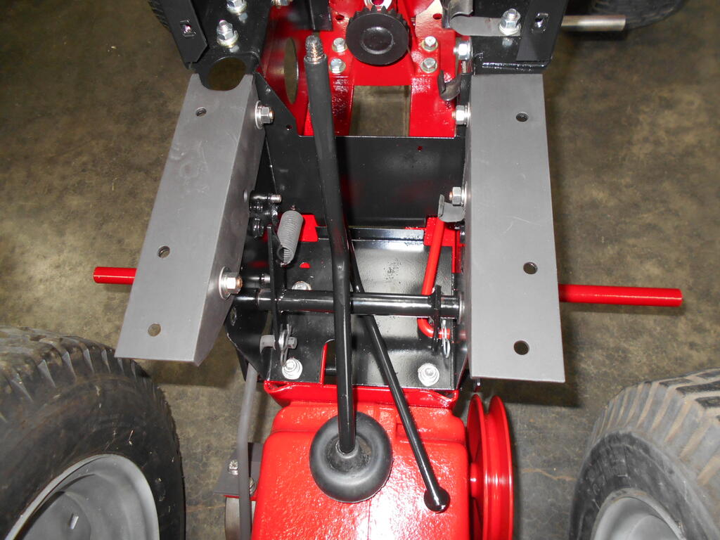

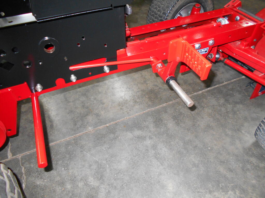

cleat 9,451 #7 Posted April 1, 2024 As you can see, pushing the brake pedal causes the rod above the brake pedal to move forward. The other end of that rod connects to the bottom of the brake bellcrank on the right hand side causing it to rotate forward at the bottom. That in turn pulls on the brake rod on the left side causing it to tighten the brake band. The spring on the bellcrank is above the pivot so it pulls in the opposite direction releasing the brake and moving the brake pedal back to it's released position. Here is an exploded parts diagram showing how everything connects. Tractor 1990 520-8 41-20O801 Brake.pdf 1 1 Share this post Link to post Share on other sites
Racinbob 13,290 #8 Posted April 2, 2024 Those small springs under the console are for the parking brake operation and have nothing to do with pulling the pedal forward. With the brake pedal 'flopped' back something is messed up with the linkage. The 108035 (on the traditional setup) does all the work and the linkage simply puts the pedal back in position. That small spring in the picture is to release the parking brake. To set it you push the brake pedal and pull the parking brake lever back. That blocks the linkage so the brake remains engaged, To release it you simple push the brake pedal again which allows the little spring to pull the parking brake lever back to release it. I don't see a 108035 spring on the pictured tractor which leads me to believe that tractor has the hydraulic strut and the parts drawing isn't for that tractor. The damper shown on the diagram (p/n 53) in one of their attempts to ease the clutch engagement and usually just causes headaches. 2 Share this post Link to post Share on other sites
cleat 9,451 #9 Posted April 2, 2024 1 hour ago, Racinbob said: Those small springs under the console are for the parking brake operation and have nothing to do with pulling the pedal forward. With the brake pedal 'flopped' back something is messed up with the linkage. The 108035 (on the traditional setup) does all the work and the linkage simply puts the pedal back in position. That small spring in the picture is to release the parking brake. To set it you push the brake pedal and pull the parking brake lever back. That blocks the linkage so the brake remains engaged, To release it you simple push the brake pedal again which allows the little spring to pull the parking brake lever back to release it. I don't see a 108035 spring on the pictured tractor which leads me to believe that tractor has the hydraulic strut and the parts drawing isn't for that tractor. The damper shown on the diagram (p/n 53) in one of their attempts to ease the clutch engagement and usually just causes headaches. If you are talking about this spring, it is for the clutch and has nothing to do with the brake. 1 1 Share this post Link to post Share on other sites
Racinbob 13,290 #10 Posted April 2, 2024 49 minutes ago, cleat said: If you are talking about this spring, it is for the clutch and has nothing to do with the brake. Correct. I didn't word that very well. I'll blame it on the model the op has, pictures of a different tractor and a download for yet another tractor. 1 Share this post Link to post Share on other sites
