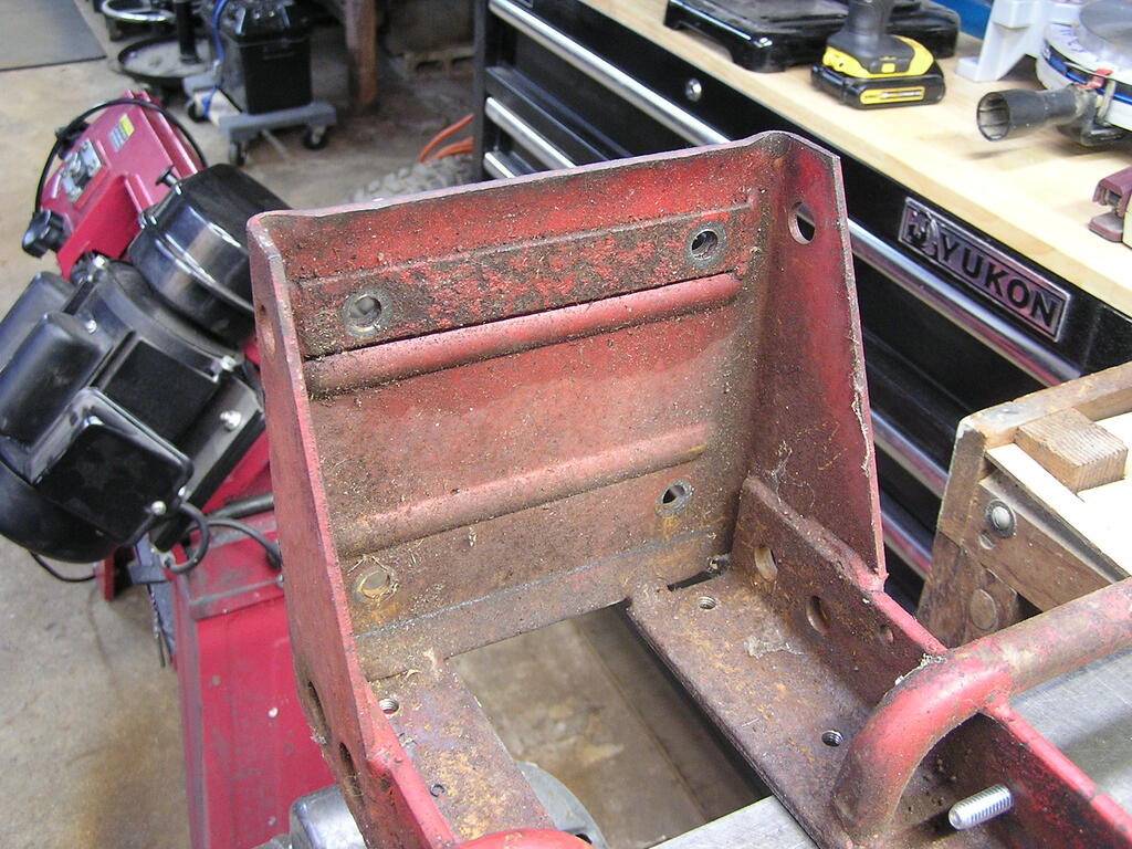

FreeBilly 23 #3 Posted March 30, 2024 10 minutes ago, ri702bill said: Welcome!! All Normal. Those holes do go thru - be careful if you chase them with a tap..... Do you have a picture of the damaged "F" plate and the finished repair?? Hope it does NOT look like this 854 frame... Been plowing with this one?? Check the cast iron lower steering block for broken off mounting tabs - those 2 problems go hand-in-hand.... The second file is the way I do the repair AND the triangular braces to stop the frame flex for good..... Ouch, unfortunately mine was worse than this. It was cracked at around every hole and was starting to twist on the bottom. I wish I took some photos before. I managed to heat it and get it pretty flat. I drilled the ends of the cracks and welded them up. I think I need to do a repair similar to this one as I may of compromised the plate by welding it. My mounting plate on the frame is stamped steel and has two high ridges on the plate from the stamp. I may need to weld in some flat stock before adding that plate. 1 Share this post Link to post Share on other sites
ri702bill 13,396 #4 Posted March 30, 2024 (edited) Some folks use 1/8" flatwashers - I weld two strips of flatstock to the back of the plate so you don't need to do the "Fishing Dance"!!! Been doing this type of fix for a while now - no issues. Best to strip the frame bare and gouge & weld BOTH sides at the cracks - ALL the welds need to be dressed flat do do the repair. The absolute BEST repair is to then drill a series of holes in the frame plate and plug weld it to the plate from behind - a "forever" fix... Edited March 30, 2024 by ri702bill 1 Share this post Link to post Share on other sites
ri702bill 13,396 #5 Posted March 30, 2024 19 minutes ago, FreeBilly said: My mounting plate on the frame is stamped steel and has two high ridges on the plate from the stamp. I may need to weld in some flat stock before adding that plate. Yup - looks like this.... Share this post Link to post Share on other sites

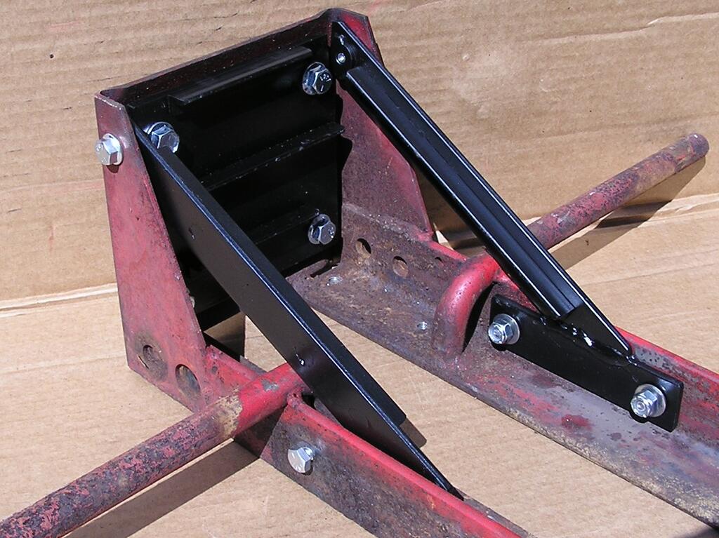

Achto 32,964 #6 Posted March 30, 2024 (edited) @FreeBilly Broken F-plates happen, specially when using a dozer blade plow. I'm in the process of building a pulling tractor and built this reinforcement to save my F-plate from the abuse. Edited March 30, 2024 by Achto 4 Share this post Link to post Share on other sites
ri702bill 13,396 #7 Posted March 30, 2024 1 hour ago, FreeBilly said: My mounting plate on the frame is stamped steel and has two high ridges on the plate from the stamp. I may need to weld in some flat stock before adding that plate. Yup - looks like this.... Share this post Link to post Share on other sites
