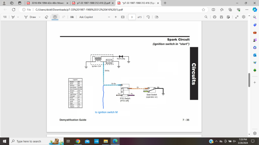

gwest_ca-(File Mod) 12,066 #3 Posted March 27, 2024 Download this file. The ignition has it's own diagram Share this post Link to post Share on other sites
953 nut 64,642 #4 Posted March 27, 2024 There is a dark blue wire (or a black wire with a dark blue line on it) that goes to a plug heading to the engine. That plug has wires for the charging system and low oil switch. Check the condition of the dark blue wire going both ways from the plug, probably have a broken spot on it. If you don't find a bad spot then you may want to test the "M" terminal on the switch by grounding it with a small jumper connected to ground. 2 Share this post Link to post Share on other sites

953 nut 64,642 #6 Posted March 28, 2024 There is a blue wire that connects the magneto to the ignition switch and the PTO switch. If it is broken or not connected to the magneto it will not shut the engine off. Share this post Link to post Share on other sites
