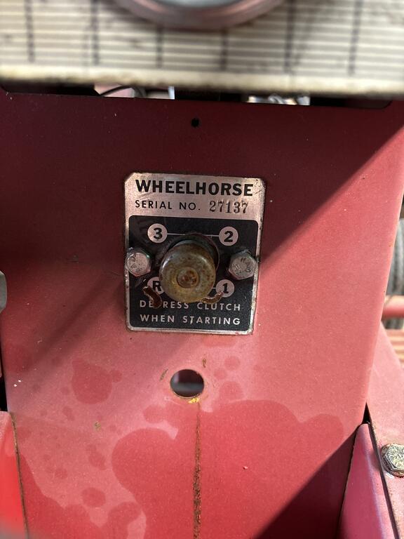

fourwheelhorseman 362 #1 Posted March 25, 2024 (edited) This is supposed to be an 854, however, I doubt it is, some one painstakingly went through it and replaced every bolt and nut after they painted it. I beleive they put the wrong model decal on it. Anyhow, here is the serial number.. any idea? Push button starter switch in the middle of the gear pattern sticker… sticker looks to be original Edited March 25, 2024 by fourwheelhorseman I can’t spell.. 🙄 Share this post Link to post Share on other sites

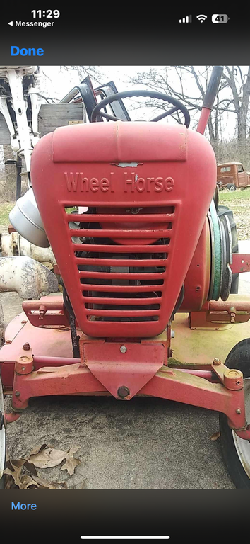

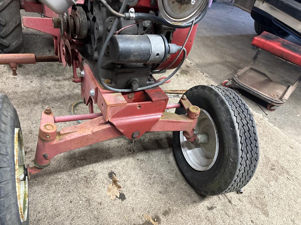

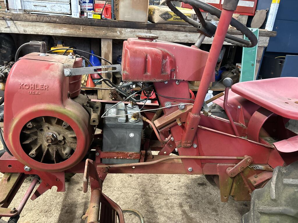

fourwheelhorseman 362 #4 Posted March 25, 2024 Ok here’s a couple more.. Share this post Link to post Share on other sites
fourwheelhorseman 362 #5 Posted March 25, 2024 13 minutes ago, ri702bill said: OK - need MORE pictures. Steering, battery box, front axle, wheels, AND a measurement of the hood from the gas tank to the joint at the grill - 854 is longer by 1" than 7HP models..... Also a side view of the air cleaner. Momentary starter push button is NOT what an 854 had originally. Keyswitch - 2 or 3 positions???? Hood to gas tank is 15-1/4 inches, it has a toggle instead of a key switch.. someone decided that was better I spose… the batter box has no bottom on it. The serial decal looks to be original as does the push button for the starter. Two piece gas tank as well. Share this post Link to post Share on other sites
gwest_ca-(File Mod) 12,485 #6 Posted March 26, 2024 27137 looks like a 1963 serial number. Share this post Link to post Share on other sites
fourwheelhorseman 362 #7 Posted March 26, 2024 1 minute ago, gwest_ca said: 27137 looks like a 1963 serial number. Thanks! I was thinking it was a 753. Share this post Link to post Share on other sites
gwest_ca-(File Mod) 12,485 #8 Posted March 26, 2024 Maybe a model 633? Share this post Link to post Share on other sites
ri702bill 12,992 #9 Posted March 26, 2024 I'm leaning towards a 753. Definitely 1963 or later. Engine is not all red - service replacement?? The oil drainplug is in front, not on the back as usually found. The 15-1/4" dimension is not correct for an 854. The 854 measured 16-1/4 to clear the taller (thicker) air cleaner. Is there a tag or decal on the fltwheel housing?? Share this post Link to post Share on other sites
fourwheelhorseman 362 #10 Posted March 26, 2024 1 hour ago, ri702bill said: I'm leaning towards a 753. Definitely 1963 or later. Engine is not all red - service replacement?? The oil drainplug is in front, not on the back as usually found. The 15-1/4" dimension is not correct for an 854. The 854 measured 16-1/4 to clear the taller (thicker) air cleaner. Is there a tag or decal on the fltwheel housing?? I havnt found any engine identification at all. Is there a way to identify visually between an 8 and 7 hp? Share this post Link to post Share on other sites

fourwheelhorseman 362 #18 Posted March 26, 2024 21 minutes ago, squonk said: 161 uses a #20 and 181 uses a # 22. In most applications it won't matter. Only if you're pulling would you might see a difference. I doubt I ever pull with it.. now to start gathering the parts I need, throttle c cable and choke cable, two way ignition switch, front tire, battery and that should do it. The throttle cables plastic that’s on it currently got melted by the exhaust, I’m not sure how to keep that from happening. Does someone have a picture of what the routing should look like for the throttle cable? If not I’ll figure it out… thanks! kary Share this post Link to post Share on other sites
Moparfanforever 938 #19 Posted March 26, 2024 This is how I did the exhaust on a 702 and 854. No pics of the throttle cable, but they both run under the crank and up the front of the engine. Share this post Link to post Share on other sites

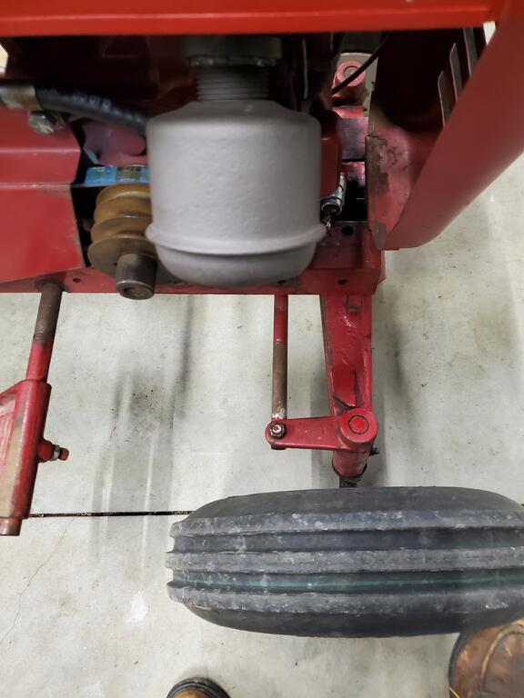

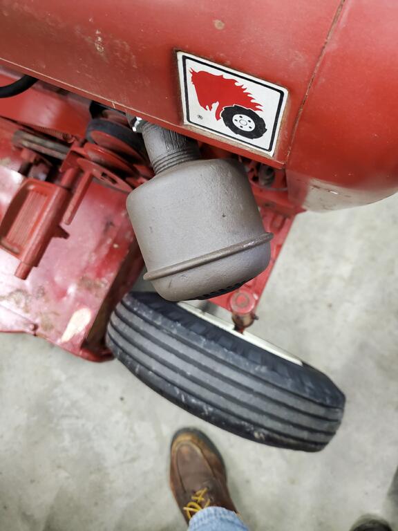

DeezEazy 6 #20 Posted March 26, 2024 That looks like a 753 all day. That’s mine in my photo. I took it completely apart and rebuilt it. On the front of your hood are the “wheel horse” letters “bubbled out” to the touch with white stickers on them? I can upload pictures of mine taken apart if it help you? Just let me know. Share this post Link to post Share on other sites
fourwheelhorseman 362 #21 Posted March 26, 2024 9 minutes ago, DeezEazy said: That looks like a 753 all day. That’s mine in my photo. I took it completely apart and rebuilt it. On the front of your hood are the “wheel horse” letters “bubbled out” to the touch with white stickers on them? I can upload pictures of mine taken apart if it help you? Just let me know. I’d like to see that! Share this post Link to post Share on other sites
fourwheelhorseman 362 #22 Posted March 26, 2024 The wheel horse letters are indeed raised, there are no stickers however, except for in the side of the hood and belt guard. 1 Share this post Link to post Share on other sites
DeezEazy 6 #23 Posted March 26, 2024 Here’s a link to my 753 build for you to do some comparing friend. Hopefully this helps. https://photos.app.goo.gl/D2LPo48MaWctVraR7 Share this post Link to post Share on other sites
DeezEazy 6 #24 Posted March 26, 2024 6 minutes ago, fourwheelhorseman said: The wheel horse letters are indeed raised, there are no stickers however, except for in the side of the hood and belt guard. Yessir! That’s a 753. Now that I think about it I had to order the white “wheel horse” and 753 stickers when I finished painting mine. 👍🏾 Share this post Link to post Share on other sites
