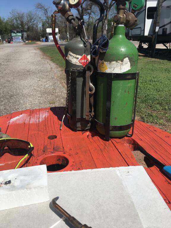

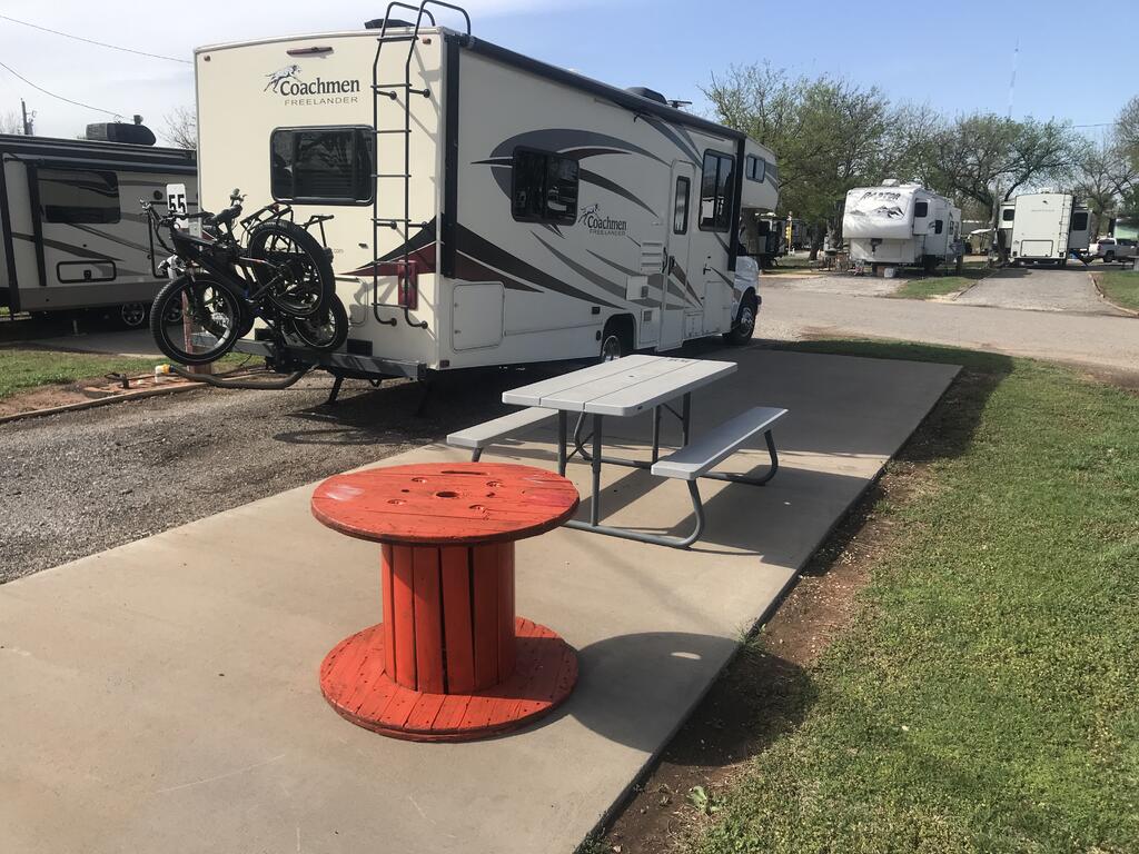

oliver2-44 10,817 #1 Posted March 25, 2024 (edited) The picture says it all! But theirs a story. So my wife is a Family Nurse Practicer and recently semi-retired from Texas Tech University teaching Family Nurse Practitioners. She had always enjoyed counseling and decided to get her Psychiatric Nurse Practitioner Degree/License. She had completed her course work and had to do 500 hours of Intern work. It’s a challenge to find clinics that will work with Interns. We took our RV to Wichita Falls Tx where she will she will work for 10 days at a clinic The lower storage of the RV is packed with several projects I’ve brought along. We also brought along my sons Electric Bikes for me to have some transportation since my wife will have the car. Goya love a working girl, but no pay for intern hours. We arrived in Wichita Falls at 6:20 last night just as the radio issued a weather bulletin warning of heavy rain, hail and a tornado threat. Before I could hook the RV up rain and small hail began. We watched slow circulation in the very dark cloud and identified the nearby cinder block RV Park Community Center as our safe place if needed. Thankfully the lite hail only lasted 5 minutes. But the rain continued. I funky hooked up the RV this morning. We’ve been working on a major addition at my oldest sons house. Thankfully he had contractors doing 50% and we are doing 50% It’s now ready to move the existing electric,water, sewer and natural gas to new connections. Since his house will be without utility services for a few days, his family moved to our house while we’re gone. Follow along for the next 10 days as I do some projects out on that big orange cable spool workbench and do some exploring on the electric bike. Edited March 26, 2024 by oliver2-44 8 3 Share this post Link to post Share on other sites

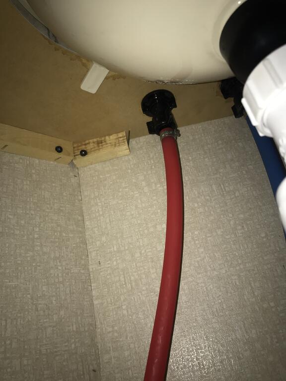

oliver2-44 10,817 #5 Posted March 26, 2024 The wind was still this morning after last nights rain. But by noon it change to 10-20mph wind gust for the rest of the day. So not much outside project work. We’re at the start of the Texas Panhandle and a stones throw from Oklahoma. Still about 3-1/2 hours from @ClassicTractorProfessor I brought a small box of Kohler stators and coils I’ve been needing to test, and my manual. Two good stators and 3 junk 12v coils. One of the RV LED lights began flickering so I replaced it with a spare as this is not the first one. LED bulbs may last 1000’s of hours, but it’s the cheap drivers that fail. As I was changing the light I noticed water on the floor. Did some investigating and found the bathroom sink faucet connection has a very slight seep. Snugging it up didn’t help. So when my wife returned I ran to an RV Supply and got several .69 cent special RV cone washers. Thankfully that did the trick. Ya Gota love RV,s quality construction. 4 1 Share this post Link to post Share on other sites

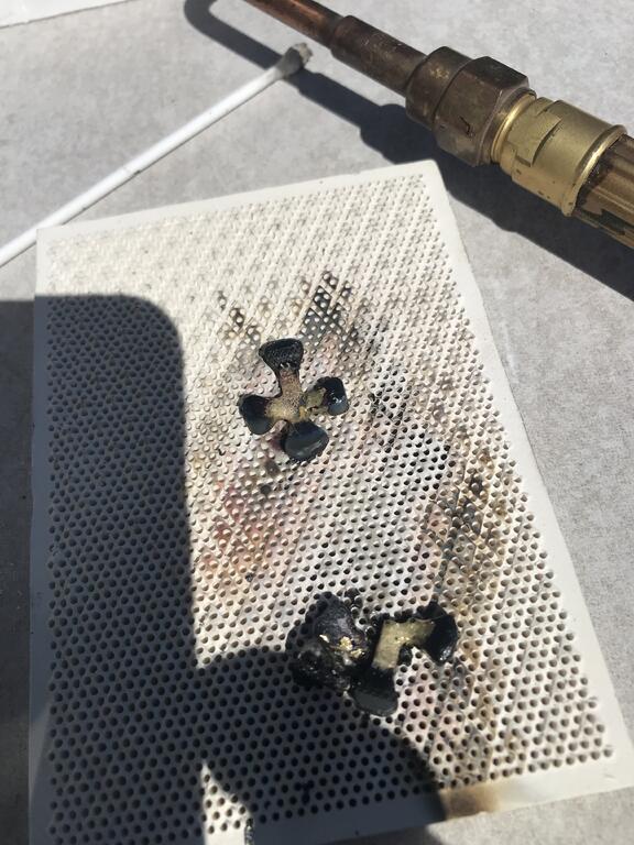

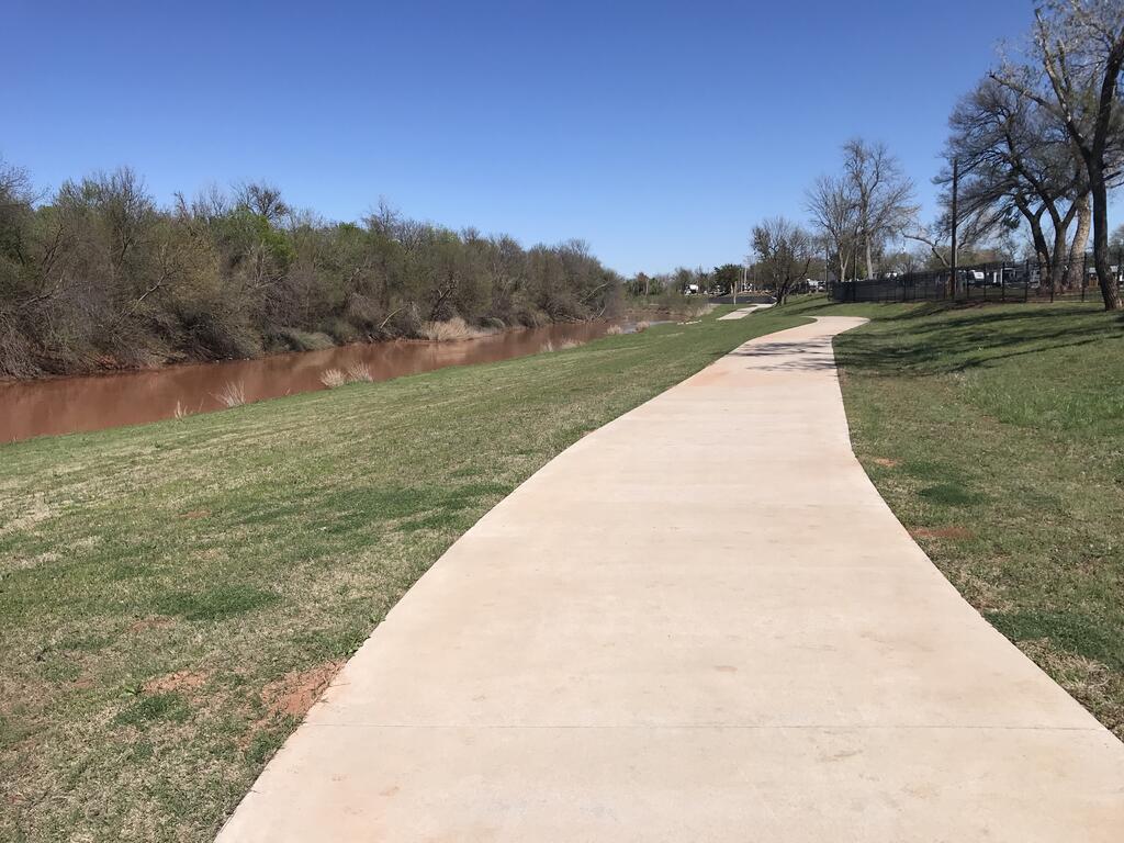

oliver2-44 10,817 #8 Posted March 27, 2024 (edited) Tuesday adventure started with it being 35 degrees, where has my Texas spring gone to? Do I working on my taxes inside for the morning. Awhile back I picked up a small torch set at an estate sale. I did some practice brazing on my Horse shoe nail cross projects. I had bought a mini torch of Amazon, but it just didn’t put out enough heat for the nails size. So I went back to my regular torch. But I have trouble with the torch pressure pushing the little pieces around. I sort of got one out of 4 brazed together and stopped for the day. The city has about 20 mile of concrete trail not quite in a full circle yet. I took the electric assist bike and rode about 8 miles. The “assist” featuresite is nice on the rolling up an down the river bank sections The Wichita river is always sandy reddish brown color from the red soil found here. It is a shot river that flows into the Red River that separates Texas and Oklahoma. Another project I brought along was a drill bit sharpener and a bunch of drill bits. It does a good job, but I wonder if it will last through all of them. Edited March 27, 2024 by oliver2-44 4 2 Share this post Link to post Share on other sites

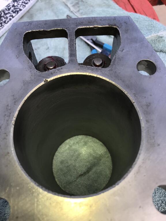

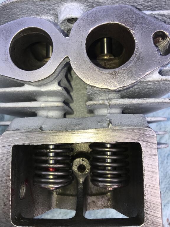

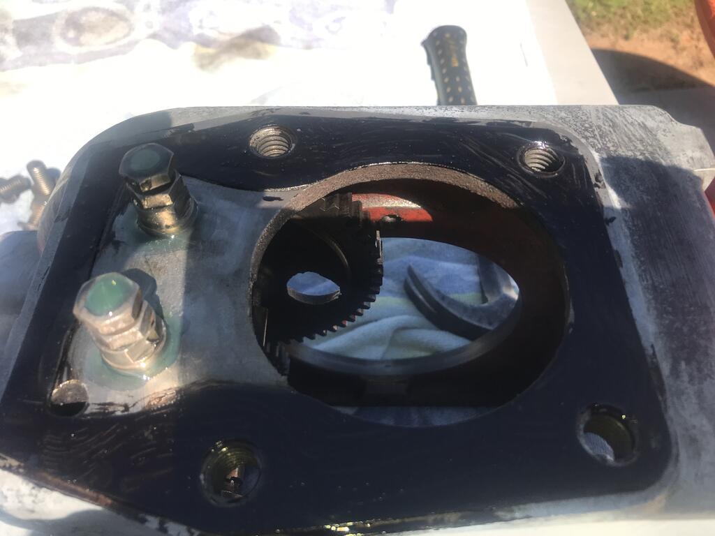

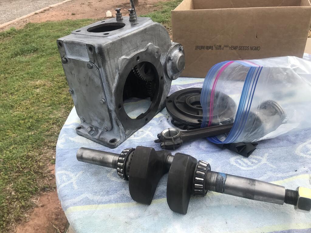

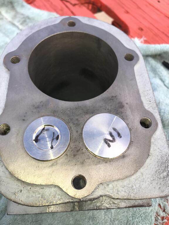

oliver2-44 10,817 #10 Posted March 29, 2024 Any Wisconsin guru’s out there? Yesterdays project was starting to do a final clean up to head toward reassemble of this Wisconsin Engine. It started life as a Wisconsin ADH, 3.6hp. The ADH, AE, AEH, AEHS are the same engine except the cylinder and piston. Sine the cylinder needed to be bored along with a new piston, I bought a AEH cylinder and 0.020 piston for it. I really have no current use for this engine. I got it free and haven’t worked on a Wisconsin engine or a Magneto since high school. Why convert it to an AEH? Well a WH Sr, Gibson, Shaw, and some of the other older late 40’s early 50’s garden tractors used AEH engines. So if it’s going to be on the shelf that make it more comparable with something I’m interested in finding. This engine had the most sludge almost tar build up I’ve ever seen There’s actually a crankshaft tapered roller bearing under the black crud on the left side of the picture This cover is on the back of the magneto shaft connection The engine got a lot of initial cleaning at home when I partially disassembled it. The cylinder has been at a machine shop to be bored, new valve guides, and valves and seats ground. They finally got to it right before this trip, so I brought it along. 4 Share this post Link to post Share on other sites

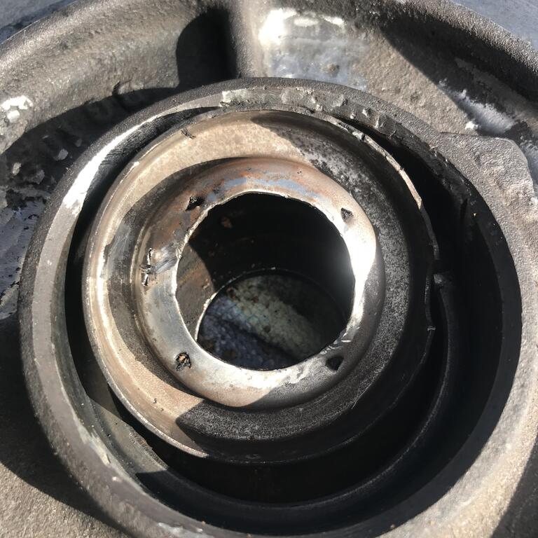

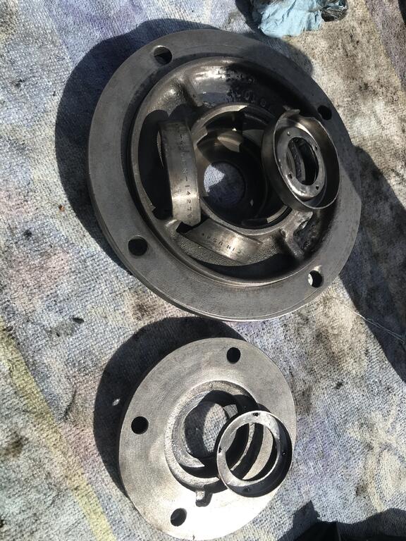

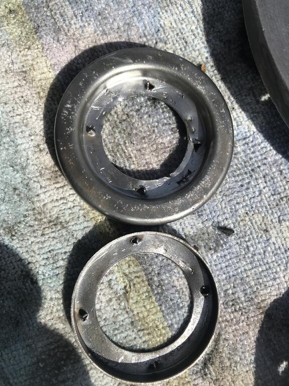

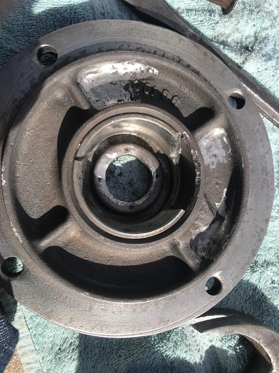

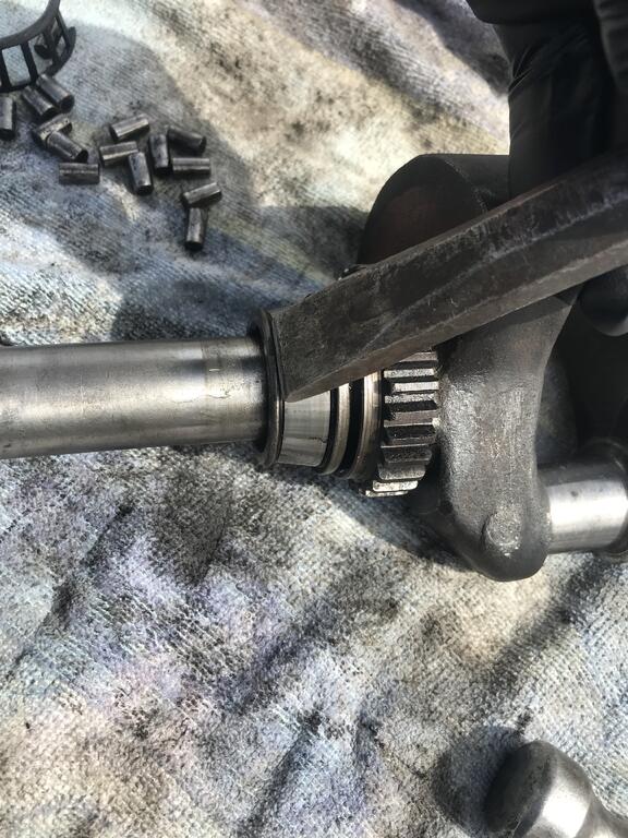

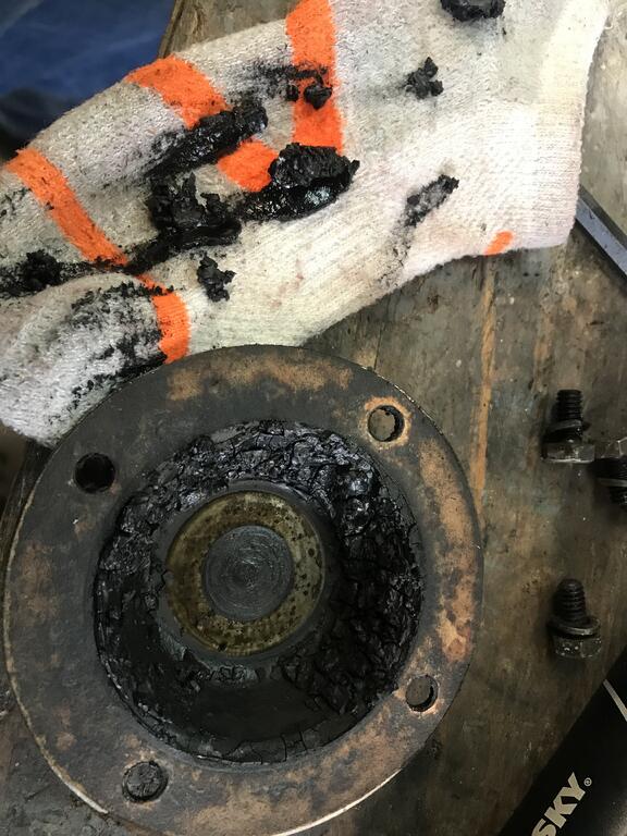

oliver2-44 10,817 #11 Posted March 30, 2024 (edited) There was no way to drive this bearing cut out of the main crankcase bearing cover. After trying to pry it out a few different ways I decided Ed to color it with my Dremel cut off tool. It took 3 slots not quiet all the way through to get it to collapse/pry out Next under the race is the metal cork seal holder. After digging the cork out of it with a screwdriver I was able to drive it out It got a little bent up but I really didn’t se any other way A little hammer tapping and it looks better/usable now. If you look close you can see 4 little bent up prongs on the inside that keep the cork from rotating. I read when installing the cork to coal it in water or oil to keep it from crumbling. I was surprised to find the gasket set didn’t include the cork seals. I’ve read where some people have replaced them with modern rubber seals. Monday I plan to carry the seals housing to an Industrial Bearing Supply and see if they have or can get seals to fit. There wasn’t a good surface to drive the crankshaft bearing off. Both sides were a tight fit. So I removed the cover and rollers with my Dremel cut off wheel and used this front ledge to drive it off. I’m going to measure the journal and bearing to decide if I need to put the crank in the freezer and bearing in hot water to make them a little easier to install. I cleaned up the ends of this copper rod I use as a punch to discover someone has built up each end with brass. I think I picked it up at a yard sale. Well thats a Saturday mornings work. Edited March 30, 2024 by oliver2-44 2 Share this post Link to post Share on other sites

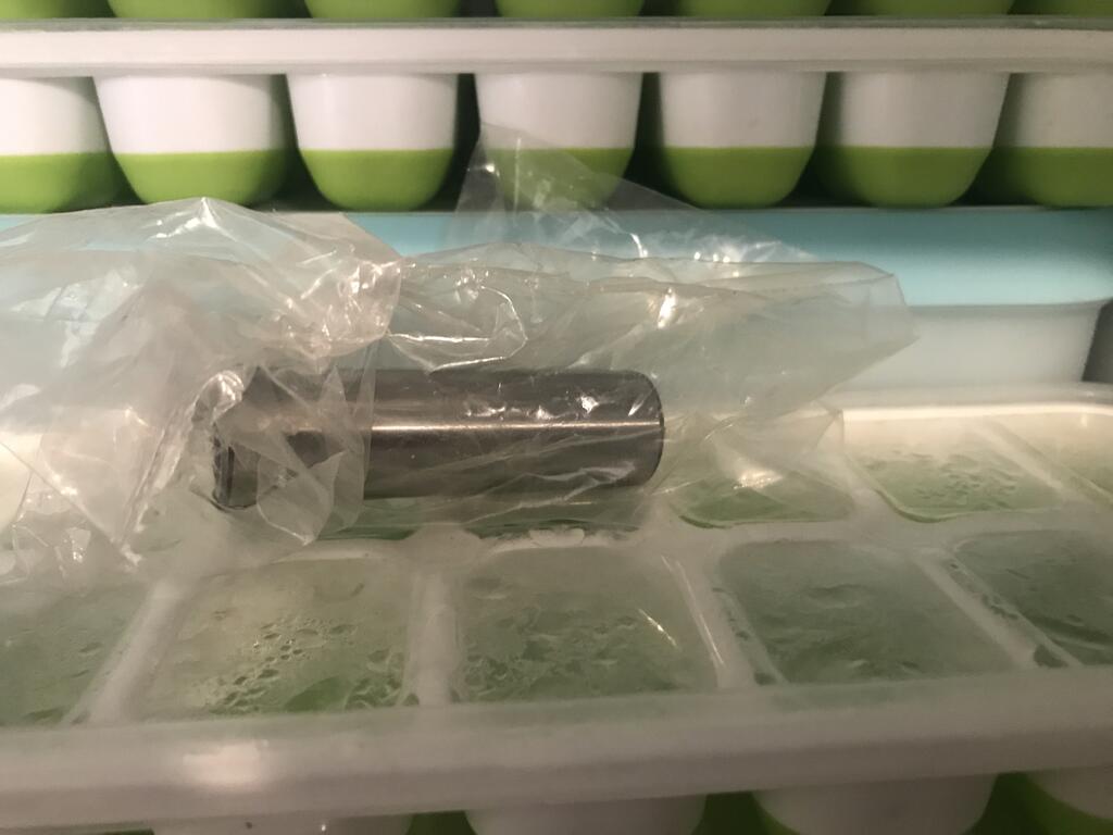

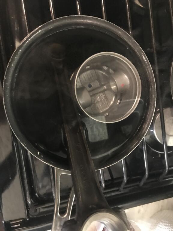

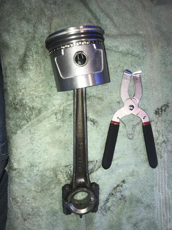

oliver2-44 10,817 #13 Posted April 4, 2024 (edited) Monday mid morning I took a 12 mile round trip ride the opposite direction. This took me along the river and down town open space that connect 2 small and one very large park. They have a lot of colorful flower beds in their parks Monday afternoon/evening was drizzly rain. So a good indoor job was to install the piston on the rod & rings. The manual recommends warming the piston in hot water to expand it a little. I also warmed the pin end of the rod. I also put the piston pin in the freezer The freezer caused a distraction since the parts needed to soak a while The manual says the new pin in a new piston is a light press fit. I used an oak dowel as a driver and it took more than tapping, but not hard hammering. I’m always glad when the pin and rings installation is done. Wednesday I continued some assembly. I used Aviation Permatex on the gasket between the crankcase and cylinder. I’m using the green Lucas Assembly Lube on the valve tappers and everywhere. This is the cylinder with valves installed On the cylinder to crankcase bolts I used Permatex thread seal and lock since these bolts go all the way through the crankcase. Valve tappers clearance is 0.004 to 0.011. I like to set the intake valve clearance on the low side of the middle and got 0.007. I like to set the exhaust valve clearance on the high side of the middle since it has more expansion and got 0.009. Edited April 4, 2024 by oliver2-44 2 Share this post Link to post Share on other sites
ebinmaine 73,304 #14 Posted April 4, 2024 5 hours ago, oliver2-44 said: freezer caused a distraction since the parts needed to soak a while Freezers. Getcha every time. Been enjoying this thread. Thanks for taking the time to post it. Share this post Link to post Share on other sites
953 nut 60,628 #15 Posted April 4, 2024 The biggest shortcoming with an RV is the freezer is too small and you can't get enough ice cream in them! The parks you visited look beautiful, glad you are enjoying the trip and taking us along. Share this post Link to post Share on other sites
