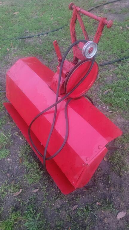

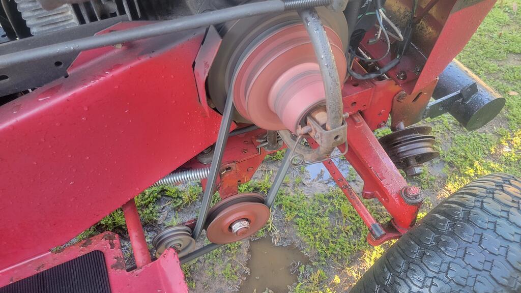

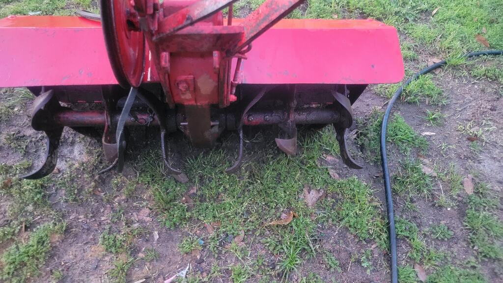

RED-Z06 2,718 #1 Posted March 24, 2024 Last used it in 2015, pulled it out the shed and power washed it, I know the tines are worn but thats some $$ there. I cant find a number on the belt but I remember it was slightly too short, anyone know the correct length to go on a 400series so i can compare it? Is there a go-to tension spring, the one i had was not right and if there's a right one id like to do that. Im going to change the oil, im assuming 90wt or 80w90 will work? 1 1 Share this post Link to post Share on other sites
RED-Z06 2,718 #2 Posted March 24, 2024 I think..141" on the belt, being a Twin? Spring is supposed to be 3.5" long "light tension"? 1 Share this post Link to post Share on other sites

Moparfanforever 933 #4 Posted March 24, 2024 I use a 141" belt on my C160. Are you asking about the helper spring for the tiller?? Not sure of the length off hand, but Lowell sells them. 1 Share this post Link to post Share on other sites

RED-Z06 2,718 #7 Posted March 24, 2024 1 hour ago, Moparfanforever said: I use a 141" belt on my C160. Are you asking about the helper spring for the tiller?? Not sure of the length off hand, but Lowell sells them. The tensioner spring for the belt. The hydro lift doesn't need a helper i dont believe. 1 Share this post Link to post Share on other sites
Moparfanforever 933 #8 Posted March 24, 2024 30 minutes ago, RED-Z06 said: The tensioner spring for the belt. The hydro lift doesn't need a helper i dont believe. Sorry, I missed the hydro part. No helper spring needed. Lowell sells that spring also I believe. I have a bunch of random springs that I went thru and found one that works well. It is pretty stiff. I can see about pics/measurements if needed . May take a few days, windy and chilly right now . 1 Share this post Link to post Share on other sites

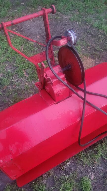

RED-Z06 2,718 #9 Posted March 25, 2024 Old belt measures 139 so the 141 should be just the ticket. I ordered a couple springs to try. Got gear oil coming, have to figure out how to change it, i see a plug on top and on bottom..but nothing that would be a conventional side plug to check level. Ill pull the upper and see if its a dipstick. 2 Share this post Link to post Share on other sites
ebinmaine 80,089 #10 Posted March 25, 2024 6 hours ago, RED-Z06 said: Old belt measures 139 so the 141 should be just the ticket. I ordered a couple springs to try. Got gear oil coming, have to figure out how to change it, i see a plug on top and on bottom..but nothing that would be a conventional side plug to check level. Ill pull the upper and see if its a dipstick. I don't have a manual to look at but keep in mind that might be a capacity fill by the ounce. Not a check to dipstick type fill. 1 Share this post Link to post Share on other sites
lynnmor 8,971 #11 Posted March 25, 2024 It takes one quart of 90-140 gear oil. Get the manual here to see where and how to check the oil level. 1 1 Share this post Link to post Share on other sites

Brockport Bill 2,449 #14 Posted March 25, 2024 the tiller belt number for model 07-36TL03 listed is 141" @ 1/2 " -- the manual lists gear oil at SAE 90-140 at 1 qt volume 1 Share this post Link to post Share on other sites

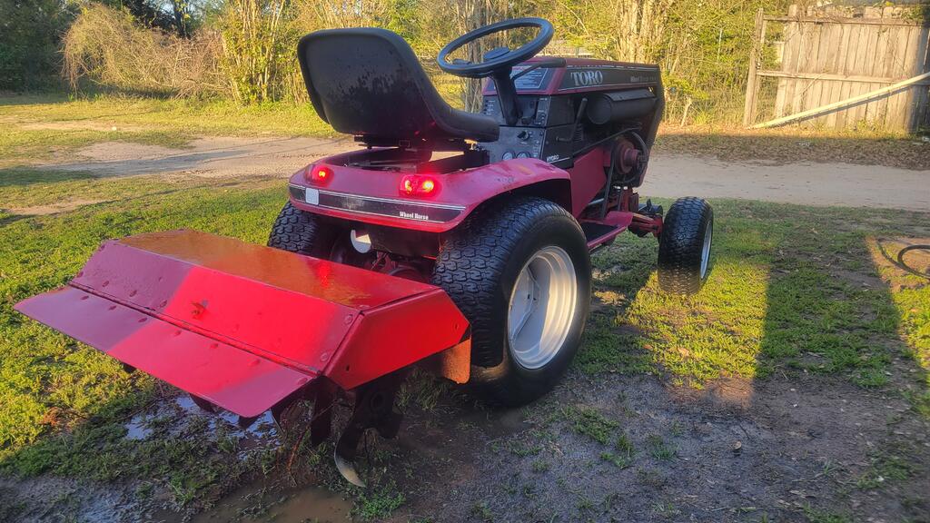

RED-Z06 2,718 #15 Posted March 25, 2024 I got the filler plug off, looked inside; had something in there as far as lube..not great looking but not milky. I put some 20w50 in to curculate for a bit, ill drain it well when the gear oil gets here, i ordered a 5gallon bucket, going to do the 312-8, C100, 702 and Tiller all at once. I did get the Tiller mounted though 3 Share this post Link to post Share on other sites

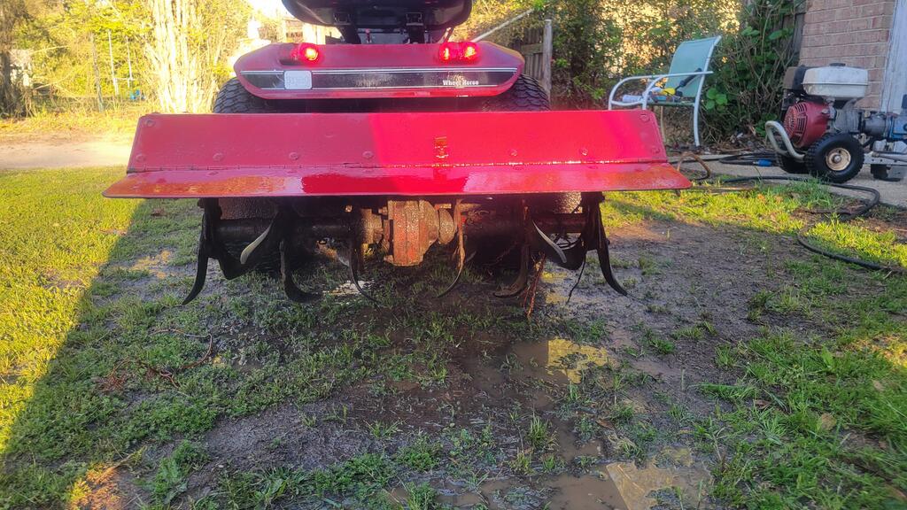

RED-Z06 2,718 #19 Posted March 28, 2024 141" belt on, spring on, massaged the rear idler into perfect alignment...gear oil drained and changed. I tilled for a good 45 minutes with no drama at all. The only drama came from my 5gallon bucket of 85w140 gear oil and the manual bucket pump...it had no hose clamp on the hose, and there wasn't one provided..so about the 3rd pump, i painted the shed wall with gear oil. Tomorrow hopefully C100 gear oil swap, and 702 gear oil swap. Saving the 312 for last because its going to make a mess. 2 3 Share this post Link to post Share on other sites
cod 135 #20 Posted March 29, 2024 21 hours ago, RED-Z06 said: 141" belt on, spring on, massaged the rear idler into perfect alignment...gear oil drained and changed. I tilled for a good 45 minutes with no drama at all. The only drama came from my 5gallon bucket of 85w140 gear oil and the manual bucket pump...it had no hose clamp on the hose, and there wasn't one provided..so about the 3rd pump, i painted the shed wall with gear oil. Tomorrow hopefully C100 gear oil swap, and 702 gear oil swap. Saving the 312 for last because its going to make a mess. Looks great and I'm sure you'll get plenty of use from it. Maybe you should use this rig to "mow" the back yard that eats your mower decks. At least the tines will hold up longer... ;-) 1 2 Share this post Link to post Share on other sites
RED-Z06 2,718 #21 Posted March 29, 2024 Gave it some paint and put her up til (till?) next time. https://youtube.com/shorts/pfoegcpGqJM?si=6XZ037QHssLnHlKG 2 Share this post Link to post Share on other sites
