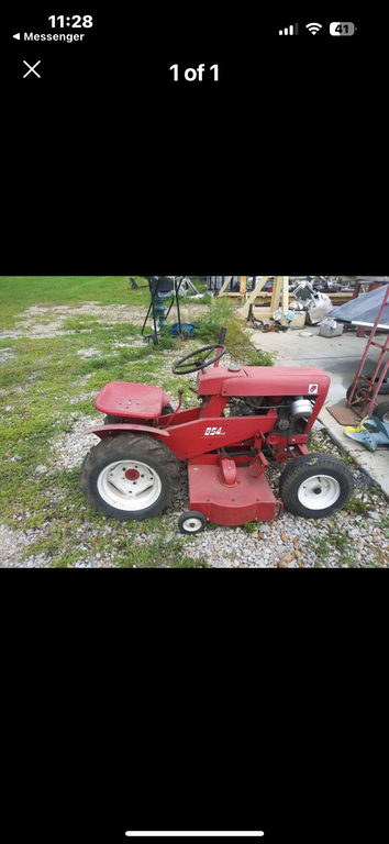

fourwheelhorseman 362 #1 Posted March 23, 2024 I know the steering wheel isn’t correct or could possibly be a model change over thing? But is there any other things you guys see besides the missing guards, that would confirm that this is an 854? 2 Share this post Link to post Share on other sites

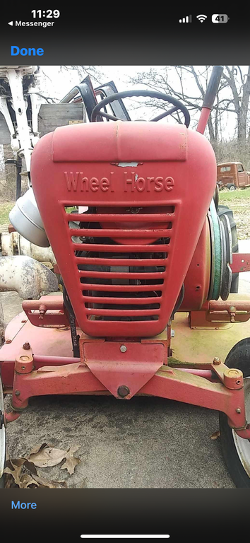

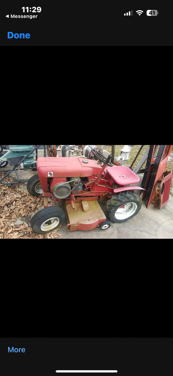

Sparky-(Admin) 26,898 #2 Posted March 23, 2024 That double pulley setup on the engine and starter/gen was unique to the 1961 model 701. But it’s not a 701 going by the slotted grill, newer style footrests and the type of tie-rods. Plenty of guys here that are better at identifying these older models than me…hopefully they chime in soon. 2 Share this post Link to post Share on other sites
ri702bill 13,398 #3 Posted March 23, 2024 Plus - later than 1962 frame and front axle. Check the length of the hood in the middle from the notch at the gas tank forward to the joint where the grill meets the hood body. OFF THE TOP of my head - 854 IS 1" longer than other round hoods - that dim would be 16-1/4, not 15-1/4" Share this post Link to post Share on other sites
fourwheelhorseman 362 #4 Posted March 23, 2024 Great.. it’s a mutt! Lol so I’m gong. To be in search of a SG belt guard.. would a standard 854 guard fit this set up? 1 Share this post Link to post Share on other sites
ri702bill 13,398 #5 Posted March 23, 2024 NO - as mentioned, the 701 is a one-year-wonder. the ONLY model to use double pulleys - a regular S/G guard will not fit..... Share this post Link to post Share on other sites

fourwheelhorseman 362 #9 Posted March 23, 2024 I was thinking it could be a 753 rather than an 854. My main concern is that belt guard for the S/G… will that be terribly hard to find? Or would it be easier to find single pulley for the crank and generator? 1 Share this post Link to post Share on other sites
Pullstart 71,564 #10 Posted March 23, 2024 2 hours ago, fourwheelhorseman said: I was thinking it could be a 753 rather than an 854. My main concern is that belt guard for the S/G… will that be terribly hard to find? Or would it be easier to find single pulley for the crank and generator? Yes, a guard and single pulley would be your best bet. That’s for any s/g K-141, 161 or 181. Not an 854 part. 2 Share this post Link to post Share on other sites
ri702bill 13,398 #11 Posted March 23, 2024 Agreed. The 701 is one year, one model only - there are no known reproductions.. Depends on the engine - the 7 HP 701 had NO ACR, that's why the 2 belts. 1962 and later did have the Automatic Compression Release ( that gives it that wonderful "putt-putt" sound at low idle.....) Got a later engine?? Go with the single belt setup. Share this post Link to post Share on other sites
