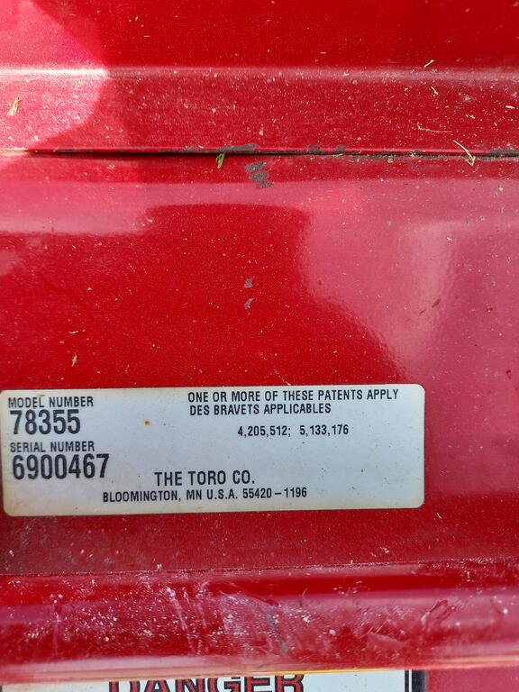

Blasterdad 3,168 #27 Posted March 25, 2024 4 hours ago, DEMO812 said: Here is the link to your deck manual...Click om the fuzzy picture. If you post the numbers on your ID plate on the tractor I can look it up for you too. 1 Share this post Link to post Share on other sites
DEMO812 19 #28 Posted March 25, 2024 Thank you! I will post the ID tag for for the mower tomorrow... 1 Share this post Link to post Share on other sites
WHX?? 58,079 #29 Posted March 25, 2024 21 minutes ago, DEMO812 said: Thank you! I will post the ID tag for for the mower tomorrow... The tag for the tractor. We then can get you a O&M manual... operation & maintaining manual as well as a IPL ... illustrated parts list. 1 Share this post Link to post Share on other sites

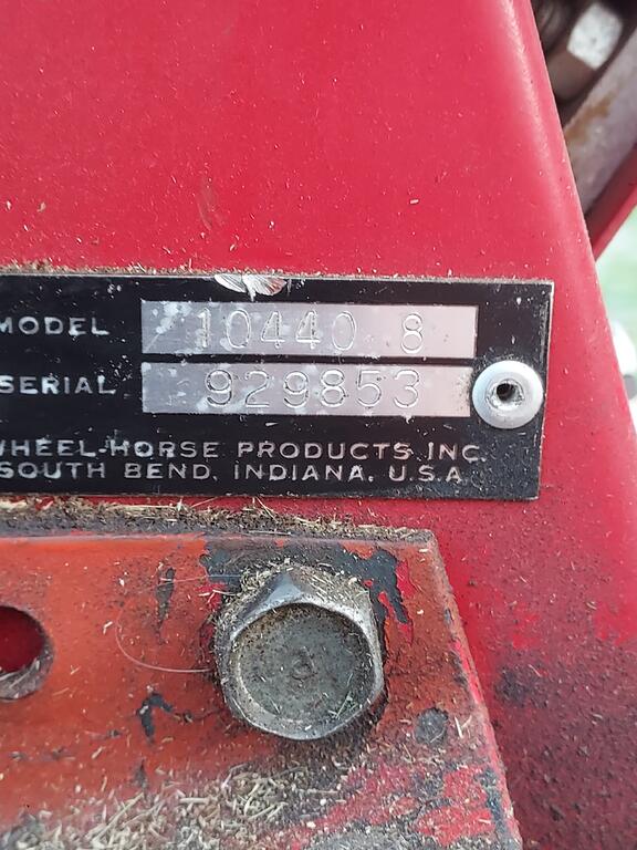

Blasterdad 3,168 #34 Posted March 26, 2024 (edited) 1-0440 1973 Lawn & Garden Tractor 16 Hp Automatic Kohler K341S-71113A 16 Sundstrand 90-2046 It seems you have a bit of a Frankentractor going on. According to the model number it's a '73 "no name" automatic, not a C-160.... But here's where it gets interesting, it has the correct sticker on the steering tower, but the sticker on the hood is wrong for both tractors. The '73 also had the motion control lever in the center of the tunnel below the steering wheel, but yours has the motion control lever high up on the right side like a C-160, but the C-160 wasn't made until 1974. My best guess is it is a C-160 that a PO replaced the tower with a 73, they are known to crack where they bolt to the frame. I have a C-160 someone put a 1971 Bronco tower on it, so it's not uncommon. The '73 no name & the C-160 are pretty much the same tractor, just different motion lever locations. Both are great tractors but I prefer the C-160's motion lever location like yours. The spec number on the engine & the model tag on the transmission might help to narrow it down to what it actually is... Edited March 26, 2024 by Blasterdad 3 Share this post Link to post Share on other sites
DEMO812 19 #35 Posted March 26, 2024 14 hours ago, Blasterdad said: 1-0440 1973 Lawn & Garden Tractor 16 Hp Automatic Kohler K341S-71113A 16 Sundstrand 90-2046 It seems you have a bit of a Frankentractor going on. According to the model number it's a '73 "no name" automatic, not a C-160.... But here's where it gets interesting, it has the correct sticker on the steering tower, but the sticker on the hood is wrong for both tractors. The '73 also had the motion control lever in the center of the tunnel below the steering wheel, but yours has the motion control lever high up on the right side like a C-160, but the C-160 wasn't made until 1974. My best guess is it is a C-160 that a PO replaced the tower with a 73, they are known to crack where they bolt to the frame. I have a C-160 someone put a 1971 Bronco tower on it, so it's not uncommon. The '73 no name & the C-160 are pretty much the same tractor, just different motion lever locations. Both are great tractors but I prefer the C-160's motion lever location like yours. The spec number on the engine & the model tag on the transmission might help to narrow it down to what it actually is... He did tell me the hood was retrofitted... but the rest I didn't know about... interesting.... thanks you! 1 Share this post Link to post Share on other sites

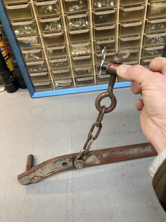

DEMO812 19 #40 Posted March 28, 2024 (edited) On 3/24/2024 at 6:53 PM, Blasterdad said: This is the trunnion and chain you will need for the lift arm, the trunnion goes in the rear hole on the rock shaft & the chain hooks into the rear hole on the lift arm. Do you happen to have a P/N or know a good place to look for one? If not I'll look through the manual to see if I can find it... Edited March 28, 2024 by DEMO812 Share this post Link to post Share on other sites
Blasterdad 3,168 #41 Posted March 28, 2024 12 hours ago, DEMO812 said: Do you happen to have a P/N or know a good place to look for one? If not I'll look through the manual to see if I can find it... Lowell has them, (Wheel Horse Parts & More) in the vendors section. I buy the eye bolt & chain at Tractor supply. https://wheelhorsepartsandmore.com/product/104524-toro-wheel-horse-lift-trunnion/ 1 Share this post Link to post Share on other sites
