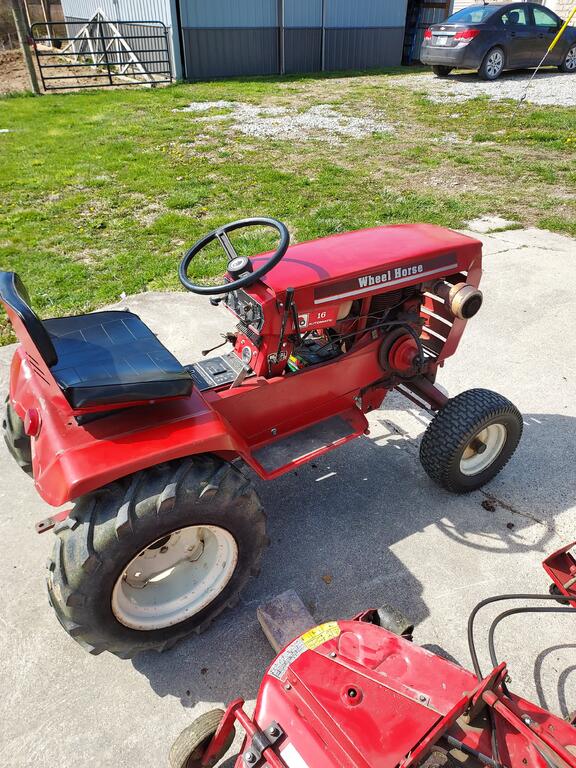

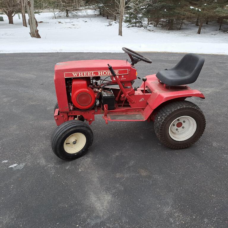

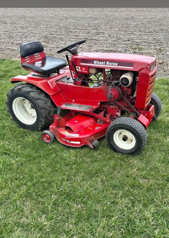

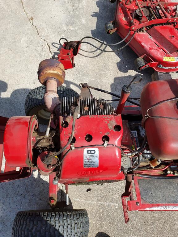

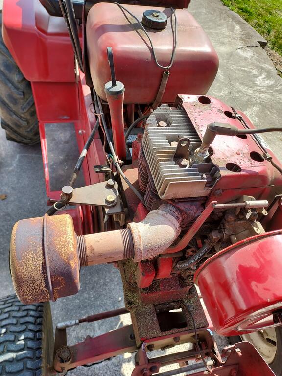

DEMO812 19 #1 Posted March 21, 2024 Hello everyone! And thanks for the wealth of knowledge here! I hope it continues for years to come, as I am just about to purchase my first horse. I had planned to buy a B 80 that I came across on Craigslist, since I am not on fb ( where everyone seems to sell everything now...) so I had plans to pick up the B80 8 h.p Koehler this weekend after doing lots of research which always led me here, so I finally decided to join... I was told though, if I wanted to do much tilling to try n find at least a 12 horse so I browsed marker place on the wife's account and came across a beautiful C160 16 h.p Koehler for about the same money... so I changed my plans and made a deal to pick it up this weekend.... I don't know a lot of ppl with knowledge or history of wheel horses, so any opinions would be cool to have.... lmk if I am making the right choice... and I will update when I officially become a newbie Sunday! Looking forward to it.... I just plan to mow some... plow a garden eventually.. when I get the attachments.. but for now, I will enjoy pulling the kids around in a wagon.... just maintain a "mini farm"... 5 acres... thanks in advance and sorry for the long post.. I know you like pics and im not sure if these sellers are already on here so I apologize for posting your horse if you are....the first pic is the 8 h.p. B 80 and second is the C160 2 6 Share this post Link to post Share on other sites

953 nut 70,661 #5 Posted March 21, 2024 10 hours ago, DEMO812 said: I am just about to purchase my first horse. The C-160 is a very desirable and a great first tractor. Both of the pictures look like great, let us know if we can help with any specific information. 1 Share this post Link to post Share on other sites

Horsin'round 508 #7 Posted March 21, 2024 The C-160 was my first, and still my favorite. Been hauling that tractor around for 25 years now. Welcome and good luck! 1 Share this post Link to post Share on other sites

WHX?? 58,388 #11 Posted March 21, 2024 13 hours ago, DEMO812 said: since I am not on fb Endeavor to keep it that way. Best and friendliest advice is right here. Yes beware of dinguses sporting mohawks and tilling in flip flops tho... A C-160 in hydro or gear jammer is a bucket list tractor around here. You can till with a hydro once you get the feel for it. B-80 great for chore work. We are all amazed what a eight can do! I field plow with mine. In other words get both! 4 1 Share this post Link to post Share on other sites

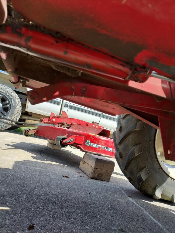

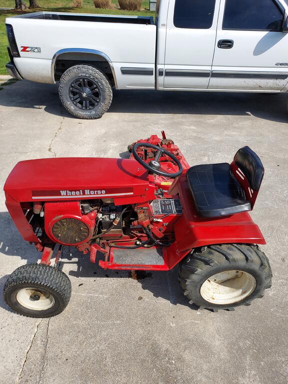

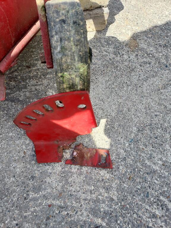

DEMO812 19 #15 Posted March 24, 2024 Well... its official.. I bought my first wheel horse.. I went a day early and got home with it last night.. 5 hour round trip.. took it straight to my parents to mow their yard I was eager to try it out.. it seems to cut very well and I was impressed with the power it has... although it does cut lower than i am used to... I now know that's pretty typical for these tractors... I took it a trip around my yard when I got home after dark... (lights don't work yet...) but when I got back up to the house I realized the deck was dragging.. so I already have my first repair.. although it should be an easy one... the manual deck adjustment broke.. it is a newer 42 inch deck I believe around 1995... and the guy said that he only used it to mulch leaves, and never used the hyd. Lift only the manual... so I'm not sure it was even hooked up right.. the hydraulic lift never seemed to raise or lower the deck.. sorry for the long post but just wanted to update... I will post pics if anyone has any input I'll take it.. 3 Share this post Link to post Share on other sites

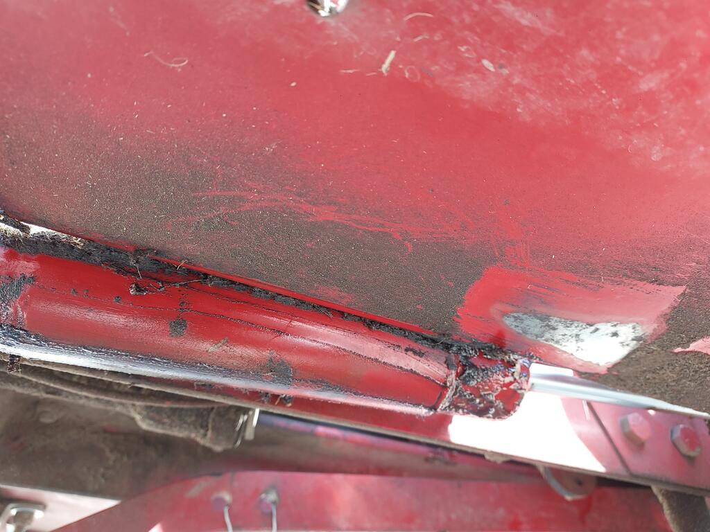

DEMO812 19 #16 Posted March 24, 2024 The lift cylinder leaks are they able to be rebuilt? Share this post Link to post Share on other sites

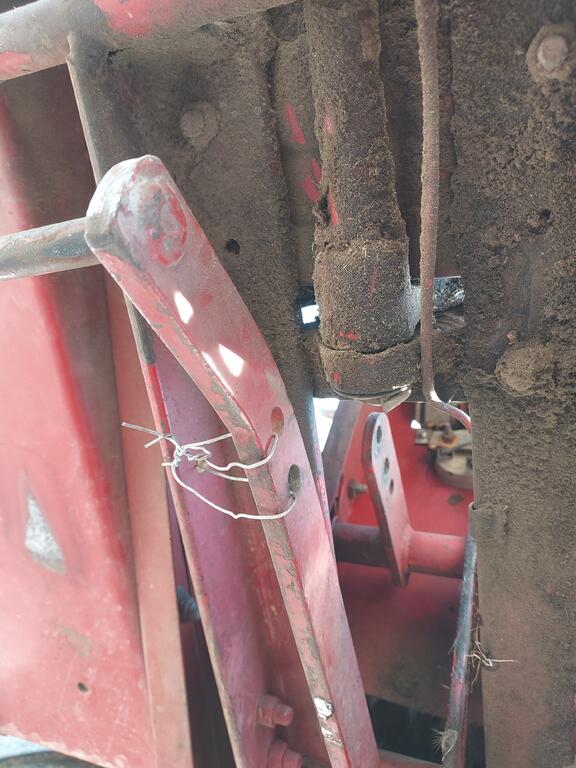

DEMO812 19 #18 Posted March 24, 2024 What holds this arm up when the deck isn't attached? Share this post Link to post Share on other sites

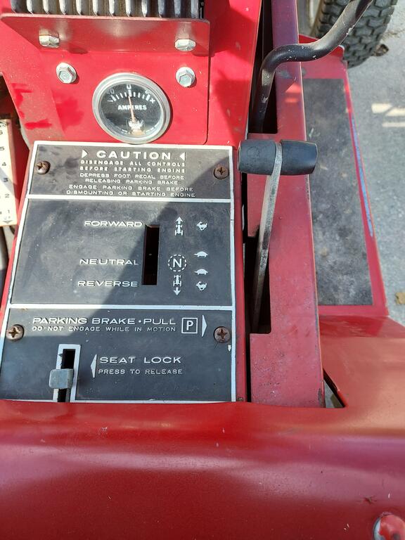

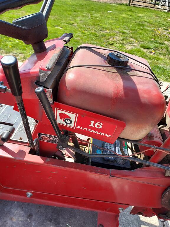

DEMO812 19 #19 Posted March 24, 2024 What's the deal with this panel were they just the same on gear drive and hydro units? Or has it been retro fitted.. the parking brake lever does nothing and .. the other lever isn't even there..... sorry for all the questions just want to get to know my tractor better .. lol .. and I will be able to pass info on someday.... thanks from a newbie Share this post Link to post Share on other sites
Blasterdad 3,168 #23 Posted March 24, 2024 2 hours ago, DEMO812 said: What holds this arm up when the deck isn't attached? This is the trunnion and chain you will need for the lift arm, the trunnion goes in the rear hole on the rock shaft & the chain hooks into the rear hole on the lift arm. 1 2 Share this post Link to post Share on other sites
Maxwell-8 4,371 #24 Posted March 24, 2024 (edited) 2 hours ago, DEMO812 said: The parking brake lever works like this: first press the brakepedal, then pull the brake lever and then let go of the brake pedal. Edited March 24, 2024 by Maxwell-8 1 Share this post Link to post Share on other sites
Blasterdad 3,168 #25 Posted March 24, 2024 2 hours ago, DEMO812 said: What's the deal with this panel were they just the same on gear drive and hydro units? Or has it been retro fitted.. the parking brake lever does nothing and .. the other lever isn't even there..... sorry for all the questions just want to get to know my tractor better .. lol .. and I will be able to pass info on someday.... thanks from a newbie The "parking brake" lever engages/disengages the hydro unit, lifting it up disengages the belt to the pump, DO NOT lift up lever when the tractor is in motion, it WILL damage the transmission. There's not a missing lever, there should be a little metal tab under the forward reverse neutral slot that moves back & forth, just an indicator of of the motion control lever 1 Share this post Link to post Share on other sites
