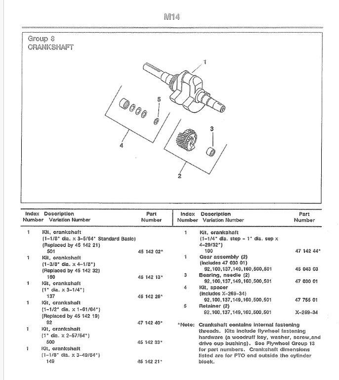

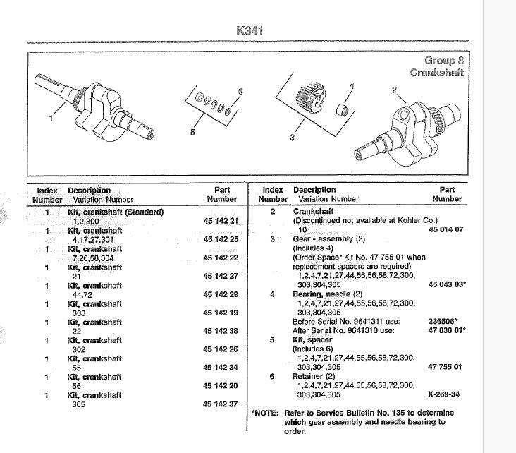

Handy Don 17,735 #8 Posted March 22, 2024 Curious... Are balance gears unique to the K341? Do all K341s have them? Share this post Link to post Share on other sites
pfrederi 21,342 #9 Posted March 22, 2024 Balance gears could be used in any Big Block K series and Magnums. They show with lots of variations, but I have to assume not all engines had them. I really think a lot of people leave them out as they are not easy to get installed correctly. Share this post Link to post Share on other sites

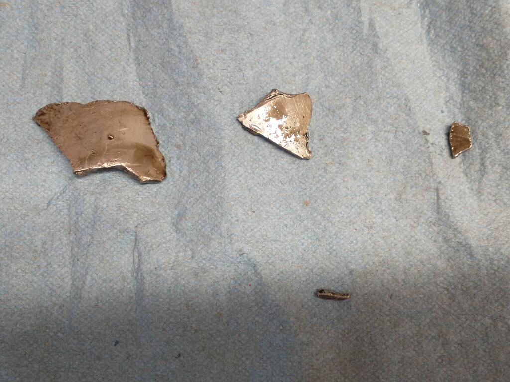

squonk 48,429 #10 Posted March 22, 2024 I have a rebuilt K321 in my 953 with the balance gears out. It has a slight vibration but it's a tractor by jimminy not a highway cruiser! The 341 that was in my C160 with the broken piston skirt had the balance gears ready to let go. Glad I tore it down. 1 bearing needle was found in the pan. Share this post Link to post Share on other sites

Bill D 3,213 #13 Posted April 16, 2024 On 3/22/2024 at 9:22 AM, pfrederi said: Balance gears could be used in any Big Block K series and Magnums. They show with lots of variations, but I have to assume not all engines had them. I really think a lot of people leave them out as they are not easy to get installed correctly. I believe most John Deere spec engines came without them. I was looking a blocks on eBay and you can clearly see that the John Deere blocks weren't machined for balance gears. Share this post Link to post Share on other sites
kpinnc 19,107 #14 Posted April 17, 2024 On 3/22/2024 at 8:43 AM, Handy Don said: Are balance gears unique to the K341? Do all K341s have them? I've never seen them in a K241/ M10, but every other big block I've opened had them. My Bronco's K321 got "degrenaded" last year. At idle, I absolutely can feel more vibration. Above idle, I can't feel anything. Personally, I'd rather leave them out. Share this post Link to post Share on other sites
953 nut 70,661 #15 Posted April 17, 2024 Not all engines came with the balance gears, I have a K-301 from a Simplicity that had none from the factory. Looked up the Spec number and the parts manual said they didn't put them in that number. None are shown for any spec number K-241. Share this post Link to post Share on other sites
