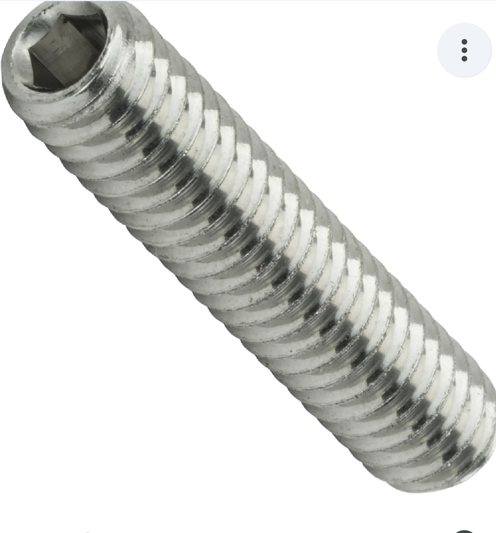

ri702bill 13,077 #7 Posted March 20, 2024 Original fasteners were Grade 5 - setscrews usually are, threaded rod is NOT. 3 Share this post Link to post Share on other sites

kpinnc 18,970 #9 Posted March 20, 2024 (edited) 1 hour ago, ebinmaine said: switched over to using grade 8 for almost all of our fasteners a few years ago. Likely I'll just take a couple of those bolts and cut the heads off to use as studs. I can certainly see the benefit. Use thread locker just in case. Or... Use long setscrews so they can be torqued when needed. Edited March 20, 2024 by kpinnc 1 1 Share this post Link to post Share on other sites
