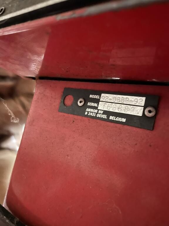

Simon WU 2 #1 Posted March 19, 2024 Hi, I recently bought a B-81 from 1979, made in Belgium and am searching for the correct V-Belt, I‘d like to buy it in Europe…I hope somebody can help me with specifications. ….Thanks! Simon 2 Share this post Link to post Share on other sites

gwest_ca-(File Mod) 12,519 #4 Posted March 20, 2024 Model number 92-08BP92 - Serial 166882 if I'm reading it correctly. 9 = 1979 2 = lawn tractor model size 08 = engine horse power B = Briggs and Stratton engine P = Peerless transmission 92 = parts list identifier with the 9 common on Belgium production with a 1, 2, 3 or 4. Most of what we see in North America have an F for Foote transmission so the belts will likely be different. We do have a 1979 B-111 4-Speed model 92-11BP01 which may use the same drive belt as the 8hp. Transmission drive belt 106518 - (HA/4L x 87.12" or 1/2" x 87-1/8") 1/2" x 87" is what we have available here and the belt should be wrapped with fabric - no raw rubber sides. There is a 92-08BP01 in a service manual but not recognized by Toro 1 Share this post Link to post Share on other sites
