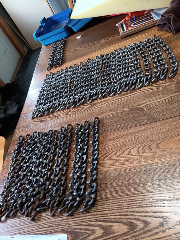

ebinmaine 78,437 #1 Posted March 19, 2024 Can anybody point me towards a chart or maybe take measurements from a set of chains that should fit a 23 x 10.5 x 12 or slightly larger tire? 1 Share this post Link to post Share on other sites

ri702bill 11,948 #12 Posted March 19, 2024 (edited) 18 minutes ago, Racinbob said: That being said if someone with that size could give you the measurements you'd be off to a good start. My picture above has the 23-8.50-12 rears on the left. You can count the sidelinks and the number of cross links... Edited March 19, 2024 by ri702bill 1 Share this post Link to post Share on other sites
