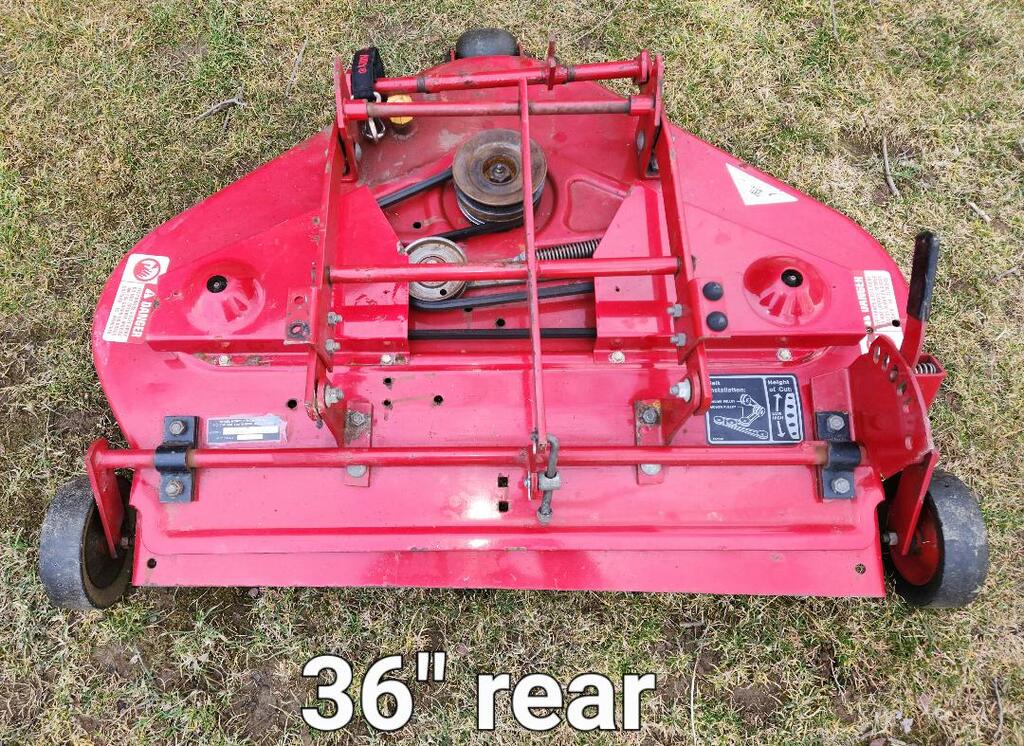

peter lena 10,089 #4 Posted March 18, 2024 @mattg those 37,s are at best a nightmare waiting to happen , so many idler , lubrication failures , along with belt tracking , angular belt twist , typical , stress cracking , lift points , pulled from deck . personally , think a R/D 36 deck , would be perfect , on that . sell off the 37 , e bay , Craig's list . if you get another deck , do a base line service on it , lubrication , blades . used a 36 for years , bombproof . also look at the mule drive PTO drive for easy movement . just my own experience , pete Share this post Link to post Share on other sites

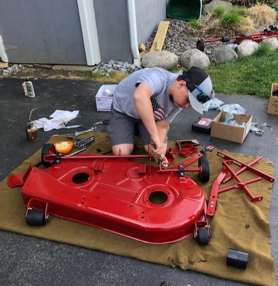

Brockport Bill 2,481 #5 Posted March 18, 2024 1 hour ago, peter lena said: @mattg those 37,s are at best a nightmare waiting to happen , so many idler , lubrication failures , along with belt tracking , angular belt twist , typical , stress cracking , lift points , pulled from deck . personally , think a R/D 36 deck , would be perfect , on that . sell off the 37 , e bay , Craig's list . if you get another deck , do a base line service on it , lubrication , blades . used a 36 for years , bombproof . also look at the mule drive PTO drive for easy movement . just my own experience , pete hey Pete -- i had one of the 36 rd mower decks used for one season ( see photo) -- loved it -- terrific cut plus manuverable - lawn looked great - I would recomend a 36 r.d. to anyone - - i sold it because i have moved to the hydro tractors so wanted to avoid the messy rear discharge clippings to the tranny fins --------------------------- I have had a 312-8 since bought new in '89 -- including the 37 sd mower - bought it for the bagger feature which i use routinely for spring mowing lawn clean up as well as fall leaves -- the 37 has been good to me - - none of the 37 s.d. issues you noted -- i did replace one pulley unit a bunch of yrs ago -- and then 2 yrs ago even tho deck shell etc was in good condition, I had the deck sandblasted and professionally primed and painted to get another 30 plus yrs from it - ( see photo ) Share this post Link to post Share on other sites
peter lena 10,089 #6 Posted March 18, 2024 @Brockport Bill had a couple of those 37 " decks , came with the unit , they were both trashed , heavy rust , broken mounts , pulleys frozen , ended up selling the entire , set up and rear bagger unit too , for parts . guy from new York , came down for it , was glad to get it ! agree with you on the R/D deck discharge issue , but have 3 of those in the 42 " size . thanks for the shout , pete 1 Share this post Link to post Share on other sites

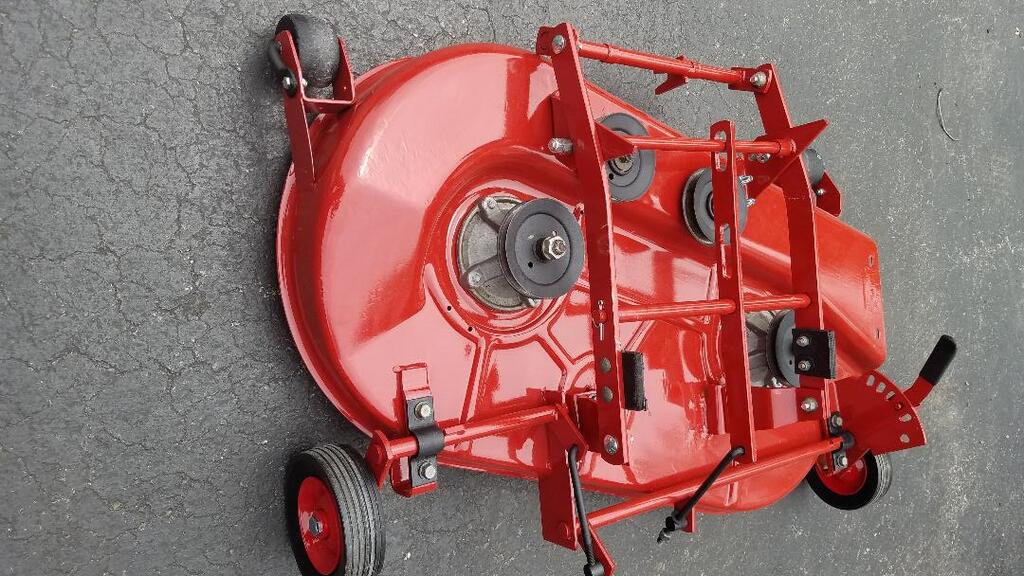

Brockport Bill 2,481 #7 Posted March 18, 2024 1 hour ago, peter lena said: @Brockport Bill had a couple of those 37 " decks , came with the unit , they were both trashed , heavy rust , broken mounts , pulleys frozen , ended up selling the entire , set up and rear bagger unit too , for parts . guy from new York , came down for it , was glad to get it ! agree with you on the R/D deck discharge issue , but have 3 of those in the 42 " size . thanks for the shout , pete i really like the 42 r.d. mower -- nice cut -- maybe it's just the agility of the 36 r.d. manuvering that i liked so much -- last summer i found 2 of the 42 rd's for sale together that had been left outside and were in horrble condition -- but one shell was solid -- the other had holes - I had to swap a spindle and some pulleys but was able to clean up the mess and make one nice mower I rehabbed ( photos ) and then sold -- the one item i would like to locate is a 42 recycler to use for fall leaf mulching - i found one i got in a package 3 yrs ago but never used it and didn't really understand or appreciate its ability and usefulness so i regretfully sold it -- wish i had it -- that's why i am on the lookout for another 42 r.d. recycler - - but they are apparently rare and not something i frequently see posted . 1 1 Share this post Link to post Share on other sites
