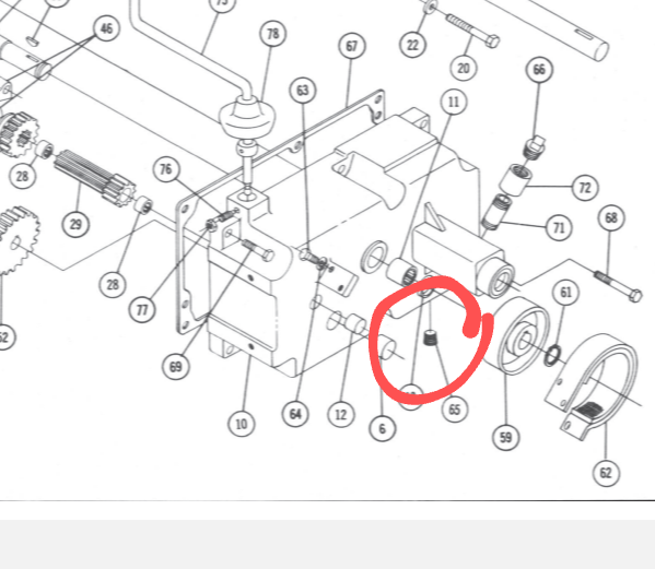

gwest_ca-(File Mod) 12,142 #10 Posted March 27, 2024 The boot on the shifter (item 78 above) will crack and allow water into the transmission so good to check it's condition. Water will follow the shifter directly into the case. If you remove the shifter that is the best place to add oil. Share this post Link to post Share on other sites
giant_g2 24 #11 Posted March 27, 2024 I was draining from 65 and filling from 66. The boot looks like it's in good condition. There wasn't a ton of water in it (all suspended, nothing separated) but enough to make it look like chocolate milk. I think I'll run it around the yard again and check the level. If the level is good, then I'll give it a mow and change after that mow. If it's looking decent after that, I think it'll be fine. Share this post Link to post Share on other sites
rmaynard 17,102 #12 Posted March 27, 2024 Draining from 65 is correct, filling at 66 is wrong. You will be at least ten ounces short. Fill at dip stick hole or shifter hole. 8-speed will take 2 quarts. Share this post Link to post Share on other sites
giant_g2 24 #13 Posted March 28, 2024 That's odd. Why would they put a fill plug on it and how can you check the level without draining? I don't see a dipstick on my trans or in the diagram above. I don't knownif I'm missing 71 and 72 - it looks like my plug screws right into the body. This is a 4 speed, so it should be 1.5 qt. I was able to add 1 qt through 66. I guess I can add another half a qt through the shifter, but that seems odd that I can't fill through the fill plug up to the full amount. Share this post Link to post Share on other sites
rmaynard 17,102 #14 Posted March 28, 2024 I forgot that you mentioned that it was a 4-speed. All mine were 8-speed. Earlier models had 71 & 72. I've not seen them on 1974, 75, 76, or 77 models. 1 Share this post Link to post Share on other sites

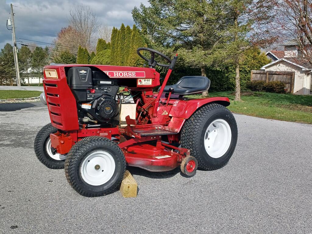

giant_g2 24 #16 Posted March 31, 2024 Thanks for all the help! I thought the least I could do is post a picture of it for you guys. Share this post Link to post Share on other sites
