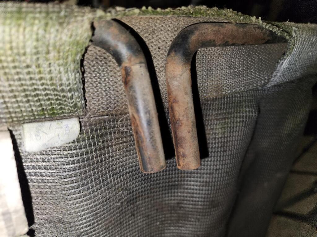

Brockport Bill 2,427 #1 Posted March 17, 2024 this may be one of the silliest questions asked here - Anyone ever replaced their mower bagger system bags? It's not, what I've done with my WH today, but what I have NOT done because I can't solve a seemingly simple challenge???? I have a 37" SD deck that has a rear bagger system I have used since 1989 -- the bags are worn but usable -- However, I came across a new set of bags that as best I can tell is a compatible match -- However, I can not determine how to slide the existing bags off the steel rim frame brackets at the top of the bags?? I asked my wife who has better dimensional and spatial brain skills than I do to look at the bagger frames -- so i asked, " how do i slip these bags off" - - her answer was "cut them off" -- sure, simple solution -- but how would I slide/thread the new bags onto the bagger frames? Duh!!!! -- Could WH really have sewn the top of the bags onto the frame brackets? NAH !!! Then how would they be selling new bags if they can't be replaced onto the brackets??? Is it my aging brain -- or is there a solution I am just not seeing? Any ideas?????????????? thanks. Share this post Link to post Share on other sites

Rick3478 454 #3 Posted March 17, 2024 1 hour ago, Brockport Bill said: " how do i slip these bags off" - - her answer was "cut them off" -- sure, simple solution -- but how would I slide/thread the new bags onto the bagger frames? Duh!!!! -- Could WH really have sewn the top of the bags onto the frame brackets? NAH !!! Then how would they be selling new bags if they can't be replaced onto the brackets??? Is it my aging brain -- or is there a solution I am just not seeing? Any ideas?????????????? thanks. If it's like mine, the part of the bag hoop that hangs on the tractor is also a clamp that holds the ends of the steel hoop rod together. Remove two bolts and separate the clamping clamshell, and now the bag slips off and on the open hoop gap like a curtain on a rod. Do them one at a time if it helps you to see how it goes back together. Share this post Link to post Share on other sites

Brockport Bill 2,427 #6 Posted March 17, 2024 5 hours ago, gwest_ca said: Look like this one? https://www.partstree.com/models/07-11bc01-toro-37-rear-bagger-1989 that parts tree diagram image in the link you provided is the model tractor and bagger i have ---- the 312-8 - with that bags and hardware frame -- the problem is the two "tongues" pointing down on the front of the steel frame do not fit or slide through the cloth slots that go around in the top of the cloth bagger!! As was mentioned earlier in the thread it should function to slide off as a shower curtain to slide the bags around and off the frame - - however, frame hardware at top of bagger does not fit through? See the photo with the length of the "tongues" with the smaller size of the slot openings? And the new bags I have are dimensionally the same slot size as old bags??? Too small for the tongues to go through --- Weird!! Share this post Link to post Share on other sites
Rick3478 454 #7 Posted March 18, 2024 41 minutes ago, Brockport Bill said: that parts tree diagram image in the link you provided is the model tractor and bagger i have ---- the 312-8 - with that bags and hardware frame -- the problem is the two "tongues" pointing down on the front of the steel frame do not fit or slide through the cloth slots that go around in the top of the cloth bagger!! As was mentioned earlier in the thread it should function to slide off as a shower curtain to slide the bags around and off the frame - - however, frame hardware at top of bagger does not fit through? See the photo with the length of the "tongues" with the smaller size of the slot openings? And the new bags I have are dimensionally the same slot size as old bags??? Too small for the tongues to go through --- Weird!! They don't go through sideways. Turn the corner. Share this post Link to post Share on other sites
