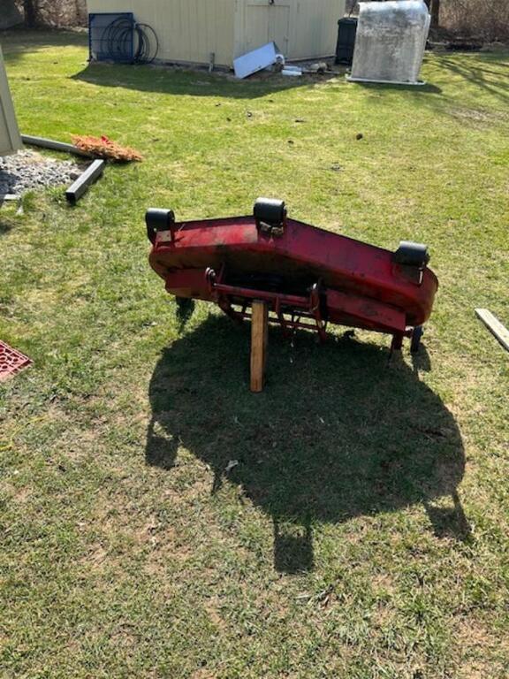

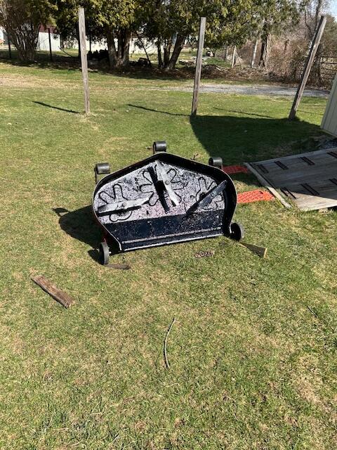

peter lena 10,087 #1 Posted March 15, 2024 been doing this for years , most important to BREAK THE GRUNGE CLCLE , any collective , moist grass , debris . personally like the open gear and chain spray , it stains the metal black with protection , another vital part is your , sun mounting point , you want hours on this ,to dry and soak in . did an initial , spindle bearing swap on it , Lucas 550 deg grease , also did related pulleys , very quiet , solid , deck actually gets very warm . proof of moisture elimination , just one of the things , I regularly do to ensure solid reliable usage . also did any related bearing , in the mule drive / pto set up , engagement is quiet and squeal free . keep it greasy , pete 3 Share this post Link to post Share on other sites

peter lena 10,087 #3 Posted December 26, 2024 @Rowan thank you for the shout ! regularly state the repetition of a problem , is your greatest opportunity , to make that problem go away , my initial mower deck bearing failure / set up , made me look at what was going on , obviousely , spindle lubrication was foundational , easily corrected , at removal time , also break the wet / clogged deck under side , issue , went step by step , on break down , correction , always cut at highest setting , for better deck discharge , regularly see how things are working , that deck removal , clean out , hot sun stand , and lubrication , bake in , really saves a deck , stains the underside black with lubrication , always choose a related lubricant that exceeds , what was there , the lateral belt drive on related pulleys is brutal , locas 550 deg flash point , chassis grease , in cleaned out bearings , is the answer, also have that in the 12 related , mule drive bearings , the operational running ease , is dramatic . if you repair something make a change to the original set up, lubrication/ detailing , is the cure , pete Share this post Link to post Share on other sites
peter lena 10,087 #4 Posted August 27 was just out snoopin around , talked to a couple of other people with deck issues , one had the deck down / off , literally packed , with wet grass, and very bad rust / rot , not a sign of anything to break the grunge cycle ? guy had no clue ? for me this is a no brainer , proof is beyond question , as stated , also added my , lucas green bearing grease, to EVERY RELATED BEARING , AFTER CLEAN OUT , then added my pto lever detailing , very smooth easy spin up , never burned up a pto clutch disc , WHAT IS THAT TELLING YOU ? have this on 3 horses , because it works , not had a REPEDITIVE FAILURE ? put this side by side to plow frame swing quadrant detailing function, virtually invisible in place , can you say SHOULDER BOLTS ? make a change , pete Share this post Link to post Share on other sites
