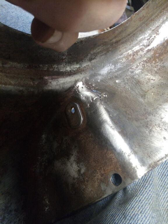

ohiofarmer 3,481 #1 Posted March 14, 2024 So here as you can see the hole closed up nicely. It hit at a bad spot close to where the captured threaded nut is on the cowling 1 Share this post Link to post Share on other sites

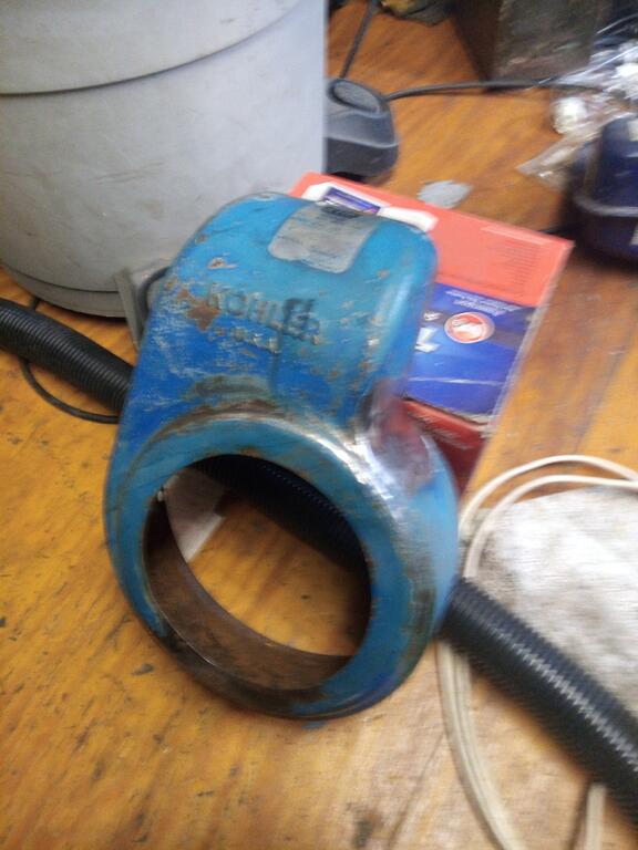

ohiofarmer 3,481 #2 Posted March 14, 2024 It's right at the corner of the round fan shroud joining the riser 1 Share this post Link to post Share on other sites

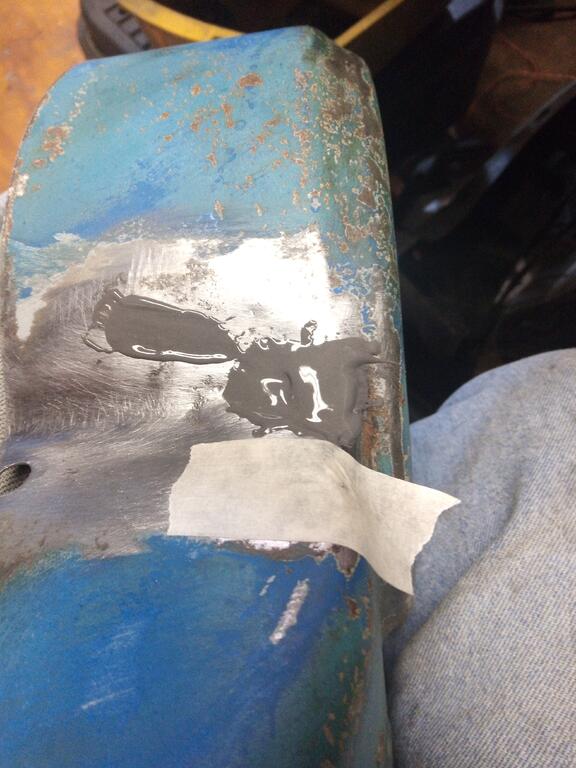

ohiofarmer 3,481 #3 Posted March 14, 2024 So I buffed it off thoroughly and roughed it s bit with sandpaper, taped the crack closed with masking on the back and applied JB to the face. Three tape you see covers the threaded hole 1 Share this post Link to post Share on other sites

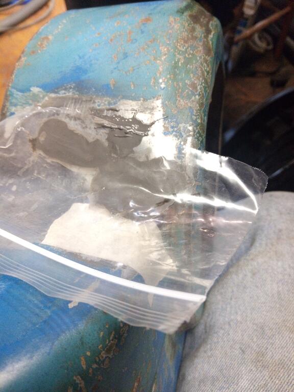

ohiofarmer 3,481 #4 Posted March 14, 2024 (edited) But that's not the secret I want to share. I placed a sandwich bag over the JB Weld to get the shape of the original fan shroud. It's suprisingly easy to do it by feel . Your finger can discern what is a low spot and fill it in.JB really makes good body filler for tiny spits like this and also repairs the split metal. Sorry I don't have the original hole but it took quite a few shrink sessions with a body hammer to close it up. Of course the secret sauce is the sandwich bag which allows you to finger tool the JB and keep it from sagging out if place. Edited March 14, 2024 by ohiofarmer 4 5 Share this post Link to post Share on other sites
