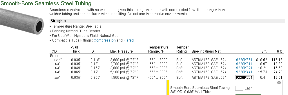

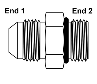

JoeM 9,642 #6 Posted March 13, 2024 Like the others have said replacing the line with hydraulic hose is and option but on some machines there is just not enough room. The tubing is much cleaner. That line doesn't have super high pressure. It runs at 700 lbs and can be spliced with a compression fitting for steel tubing. if need be or just replacing one end. A new line can be made. Just like the brake lines but just a tad different. If you want to change the entire line you can get new steel tubing and form it. I have found changing the fitting over to JIC and using steel tubing is good way to go. I have these style tubes on my front end loader works good there too. I have used JIC 37 degree fittings and flared the tube ends To convert the line to JIC tube or for that matter hose. You will have to change the fittings 33, and 19 to JIC to O-ring the fittings are in the block and hydro are O-ring boss so you will need one 90 and on straight I believe (going from memory here) the oring in the main lines is a #6 but please double check. The 90 Degree Elbow 6801-06-06 The straight part number is 6400-6-6 McMaster Carr sells the tubing and the ends. The ends will need a single flare sliding on the nut on the tube and then the sleeve and single flare the end. this will allow it to connect to the JIC fitting. 50695K218 is the MMC number for the sleeve. and 50695K226 is the MMC nuber for the nut this is the tubing I used. 2 Share this post Link to post Share on other sites

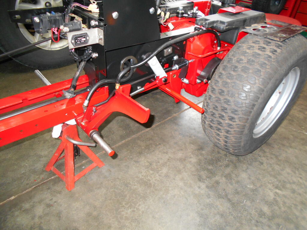

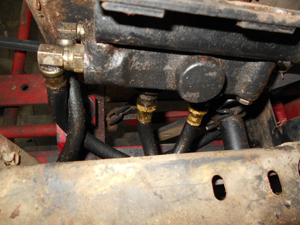

cleat 8,746 #11 Posted March 14, 2024 (edited) Here are a couple of pictures of my 312H hydraulic rubber lines showing the fittings and routing. Top picture is as found and I assume factory routing. Bottom is during the rebuild of that machine. Hoses were all re-used with just new 'O' rings installed on the hose ends. My 520's are a mix of rubber and hard lines from the factory depending on year. Both work fine. Edited March 14, 2024 by cleat 1 Share this post Link to post Share on other sites
