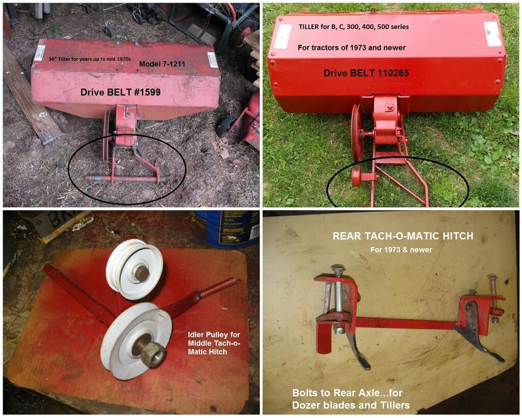

gwest_ca-(File Mod) 12,557 #2 Posted March 12, 2024 Is this the setup you have? Your tractor is a long frame model. Click on the picture 1 Share this post Link to post Share on other sites
siebenaler 114 #3 Posted March 12, 2024 1 hour ago, gwest_ca said: Is this the setup you have? Your tractor is a long frame model. Click on the picture Yep that's the setup I have long frame 76 inch belt thank you Share this post Link to post Share on other sites

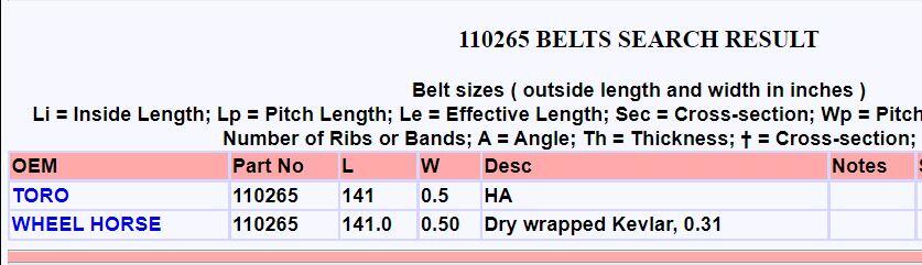

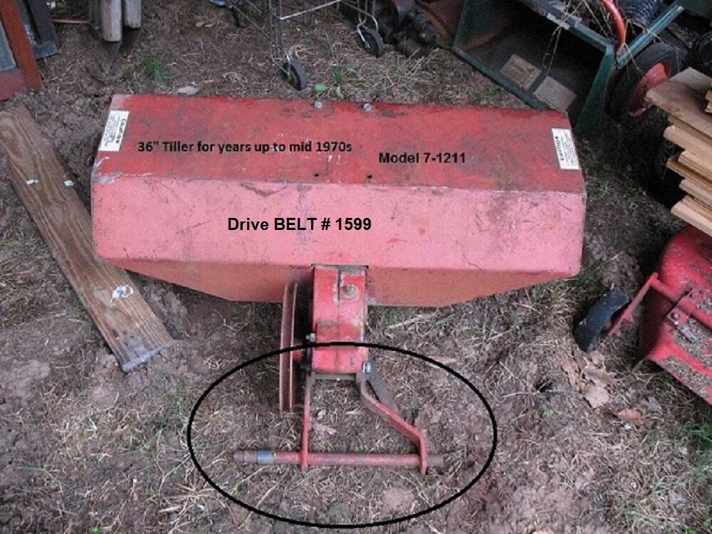

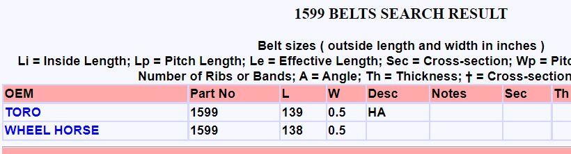

daveoman1966 3,885 #4 Posted March 12, 2024 1972 & prior older tiller model 7-1211 uses drive belt #1599 (139") 1973 and later models use drive belt 110265. 2 Share this post Link to post Share on other sites
siebenaler 114 #5 Posted March 12, 2024 5 hours ago, daveoman1966 said: 1972 & prior older tiller model 7-1211 uses drive belt #1599 (139") 1973 and later models use drive belt 110265. I have a electro 12 wheelhorse which was made from 68-70 . So I'm guessing I need a 138 inch belt part number 1599 1 Share this post Link to post Share on other sites
gwest_ca-(File Mod) 12,557 #6 Posted March 12, 2024 The 7-1211 used 2 belts to drive the tiller. The idler was a double pulley. A later model on an older tractor would use the longer single belt 1 Share this post Link to post Share on other sites
