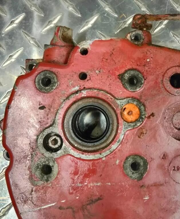

MSBiker 49 #11 Posted March 14, 2024 New, related topic: anyone have a good way to remove the oil seal so I can remove the clip behind it and pull the cover off? I have another oil seal on order because, I assume you have to destroy this one taking it off. No big deal, just seems kinda backwards seal then clip... Share this post Link to post Share on other sites
ebinmaine 79,718 #12 Posted March 14, 2024 31 minutes ago, MSBiker said: New, related topic: anyone have a good way to remove the oil seal so I can remove the clip behind it and pull the cover off? I have another oil seal on order because, I assume you have to destroy this one taking it off. No big deal, just seems kinda backwards seal then clip... We're you able to download and peruse the manual from a few posts back? Not sure if that info is in there... Here's a couple other videos I'd saved: Share this post Link to post Share on other sites
RED-Z06 2,718 #13 Posted March 14, 2024 40 minutes ago, MSBiker said: New, related topic: anyone have a good way to remove the oil seal so I can remove the clip behind it and pull the cover off? I have another oil seal on order because, I assume you have to destroy this one taking it off. No big deal, just seems kinda backwards seal then clip... What clip? Im assuming there is a snap ring over a bearing? 1 Share this post Link to post Share on other sites
MSBiker 49 #14 Posted March 14, 2024 10 minutes ago, ebinmaine said: We're you able to download and peruse the manual from a few posts back? Not sure if that info is in there... Here's a couple other videos I'd saved: The manual just says you have to remove it. Unfortunately both videos don't show how they removed the seal they just show it after it was removed. Thanks! I will do some more searching. Share this post Link to post Share on other sites
MSBiker 49 #15 Posted March 14, 2024 28 minutes ago, RED-Z06 said: What clip? Im assuming there is a snap ring over a bearing? Yeah, the snap ring. Share this post Link to post Share on other sites
RED-Z06 2,718 #16 Posted March 14, 2024 36 minutes ago, MSBiker said: Yeah, the snap ring. I just dont recall ever having to pull a snap ring on one. What does it retain? 1 Share this post Link to post Share on other sites
RED-Z06 2,718 #17 Posted March 15, 2024 (edited) 4 minutes ago, RED-Z06 said: I just dont recall ever having to pull a snap ring on one. What does it retain? Thinking back, i usually just unbolted the cover, turned the bearing retainers, then pulled the cover off, if the ball bearing stayed on the crank, fine...if it stayed in the cover...also fine. Edited March 15, 2024 by RED-Z06 1 Share this post Link to post Share on other sites
MSBiker 49 #18 Posted March 15, 2024 According to the book there is one behind the seal. The cover definitely won't come off easily. So there must be a snap ring back thers. Share this post Link to post Share on other sites
RED-Z06 2,718 #19 Posted March 15, 2024 14 minutes ago, MSBiker said: According to the book there is one behind the seal. The cover definitely won't come off easily. So there must be a snap ring back thers. Pictures of the book? 1 Share this post Link to post Share on other sites
pfrederi 20,874 #20 Posted March 15, 2024 Part Manual for H60 HH60 Models 75117 and 75118 show only a seal Tecumseh Manual 2.bmp 1 Share this post Link to post Share on other sites
