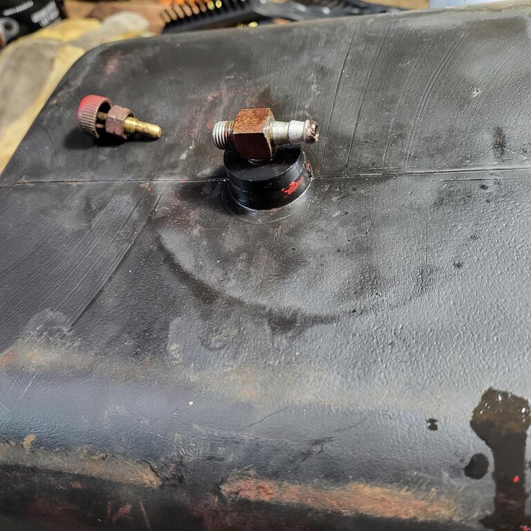

loudtractor 50 #1 Posted March 6, 2024 Maybe someone can shed some light on this situation. This tank is off a C-120 that I recently got in non running condition. Needs a little help in a few areas, but today I'm trying to get this tank working. First, is there supposed to be some packing\o-ring in that gland nut,(I think that's what it is) the hollow nut on the left? It does not shut off the fuel. Second, the whole assembly spins around on the bottom of the tank. Is that normal? It definitely leaks. Does it pop out, or.... I can't figure out how it seals Hopefully someone has run into this and can help a guy out. Thanks for any help! Matt Share this post Link to post Share on other sites
ebinmaine 80,288 #2 Posted March 6, 2024 The rubber piece that rotates in the bottom of the tank is a grommet. Replace the valve and the grommet together as a set. I buy mine here: https://www.aircraftspruce.com/catalog/appages/fueltankvalve.php?clickkey=8569 I DO NOT advise buying the cheap stuff that is available all over fleeebay and the jungle site. 1 5 Share this post Link to post Share on other sites

WHX?? 57,804 #5 Posted March 7, 2024 That is a good price... and looks to be a 1/4 turn valve. Clean & grease every thing up before installing. Check tank bung for cracks & burrs. Install grommet first. 2 Share this post Link to post Share on other sites
ebinmaine 80,288 #6 Posted March 7, 2024 Just now, WHX?? said: That is a good price... and looks to be a 1/4 turn valve. Mighta been yo buddy @Achto I got that info from...(?) I REALLY like the 1/4 turn. No more trying to stuff my meat bear paws up under the tank to spin the knob. 1 1 Share this post Link to post Share on other sites
