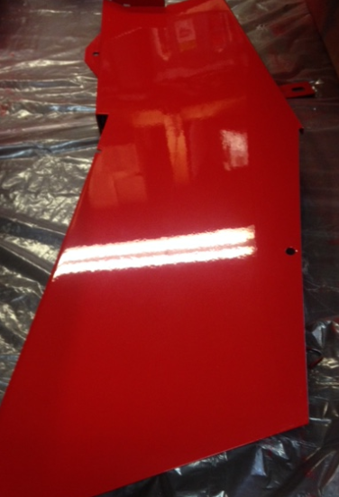

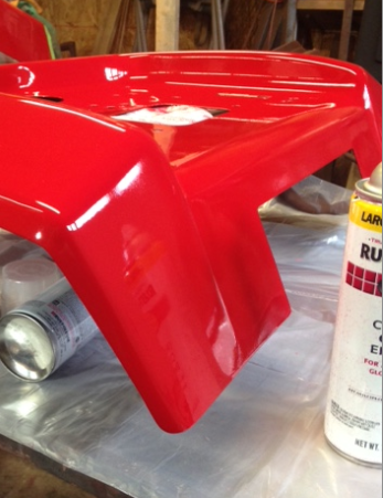

kpinnc 18,969 #3 Posted March 1, 2024 2 hours ago, TJN said: Prefer Rust-oleum as it's available locally. Can't speak for longevity yet, but the IH red "Farm Implement" Rust-Oleum has higher gloss than regular rattle cans. It's a bit slower to fully cure, but worth the wait IMO. 2 3 Share this post Link to post Share on other sites

squonk 48,130 #8 Posted March 2, 2024 (edited) If your going to Rattle can it. Rust oleum Regal Red. When you spray the last coat of color immediately spray a coat of Rust oleum Chrystal clear. when the first coat of clear dries (15 min) spray a 2nd coat of clear. In an hour you will be able to touch it . NOTE: EVERYONE'S EYES SEE COLORS DIFFERENTLY!!! Regal red looks good to me. Other's like Sunrise Red. To me sunrise red makes a tractor look like a pumpkin!! Edited March 2, 2024 by squonk 1 1 Share this post Link to post Share on other sites
