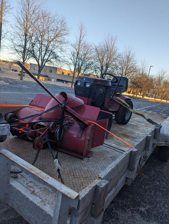

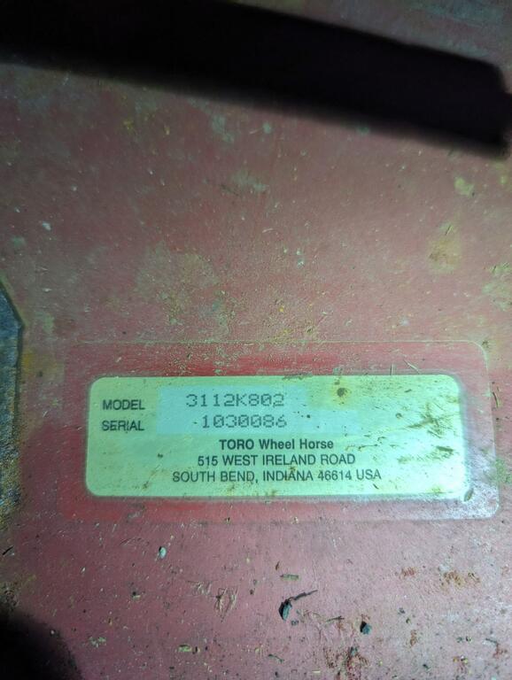

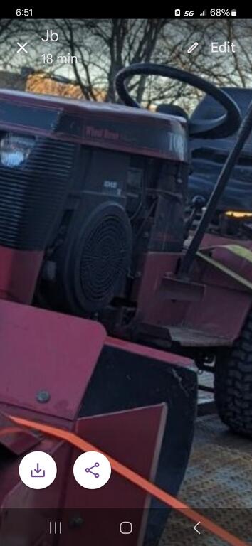

ericforster 69 #1 Posted February 29 (edited) A friend just sent me a picture of a wheelhorse he aquired. I dont have any identifying info. I only have a picture. He needs to locate a deck but he needs to id the machine first. I was hoping someone can help. Edited February 29 by ericforster Wrong picture 1 Share this post Link to post Share on other sites

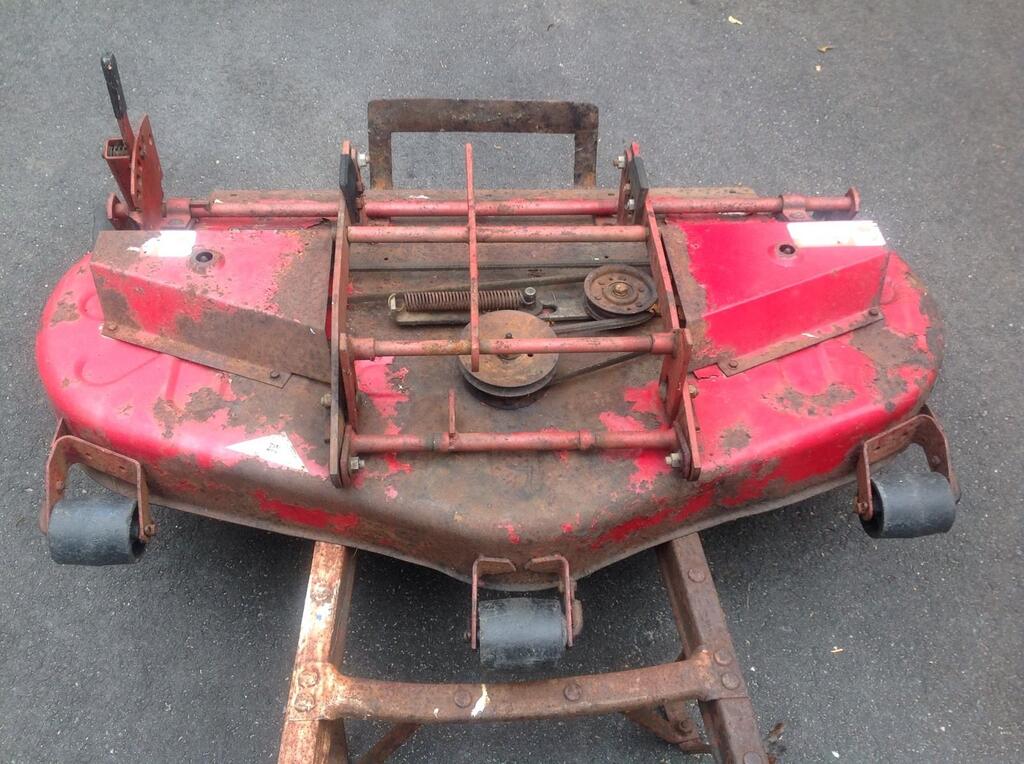

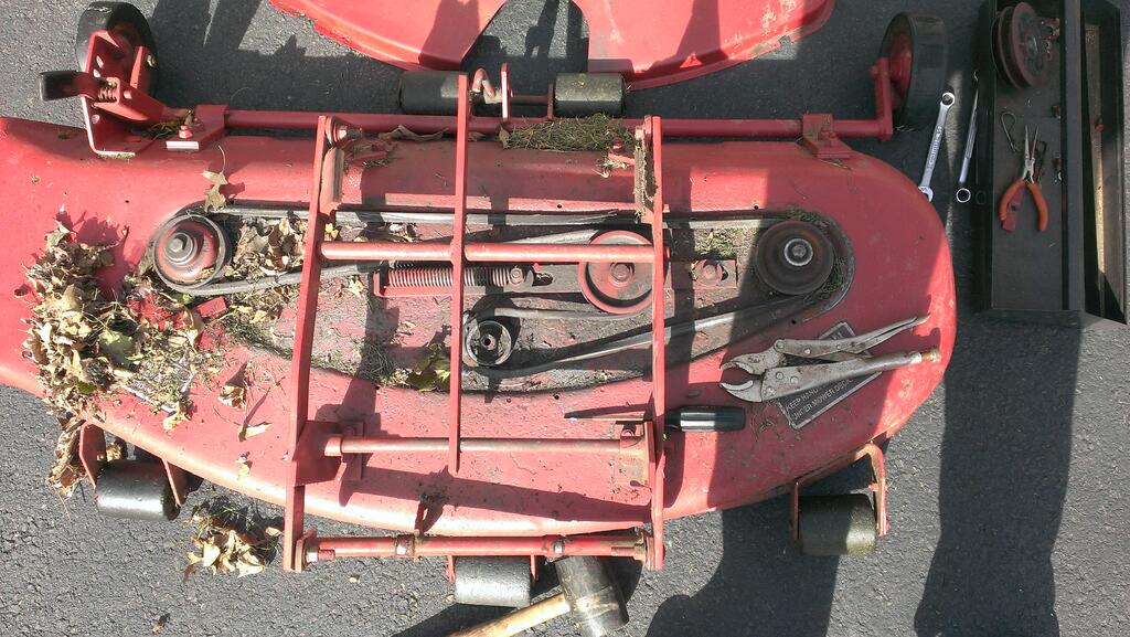

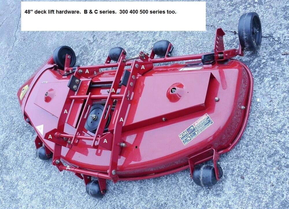

daveoman1966 3,612 #3 Posted February 29 Model 31-12K802 is a 312-8 Tractor. You can use most any 'Tach-O-Matic' style deck on it. from 36" and 42"---side or rear discharge---to the wider 48"...for mower deck years going back to the mid 70s. As long as the deck has the deck lift hardware like in these pics... 1 2 Share this post Link to post Share on other sites
gwest_ca-(File Mod) 10,503 #5 Posted February 29 Here are the decks listed for the 1991 312-8 model 31-12K802 tractor. You are not limited to these models. If you search our files using a deck model number look for DNA in the search results to see a complete list for each type and width of cut. Decks are sized by their width of cut - not the width of the deck. 05-36MR05 36" Rear Discharge Mower Current Model Available: 78305 Original Model Supersedes To: 78305 05-37SC03 37" Side Discharge Mower No Longer Available. Original Model Supersedes To: 78315 15-42RC01 42" Rear Discharge Mower Current Model Available: 78350 Original Model Supersedes To: 15-42RC02 15-42SC03 42" Side Discharge Mower Will accept Vac Bagger 07-4XVC01/79301. Current Model Available: 78345 Original Model Supersedes To: 78345 15-48SC03 48" Side Discharge Mower Will accept Vac Bagger 07-4XVC01/79301. Current Model Available: 78361 Original Model Supersedes To: 78361 1 Share this post Link to post Share on other sites
