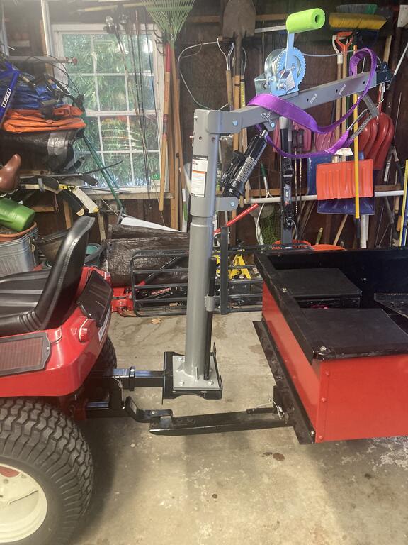

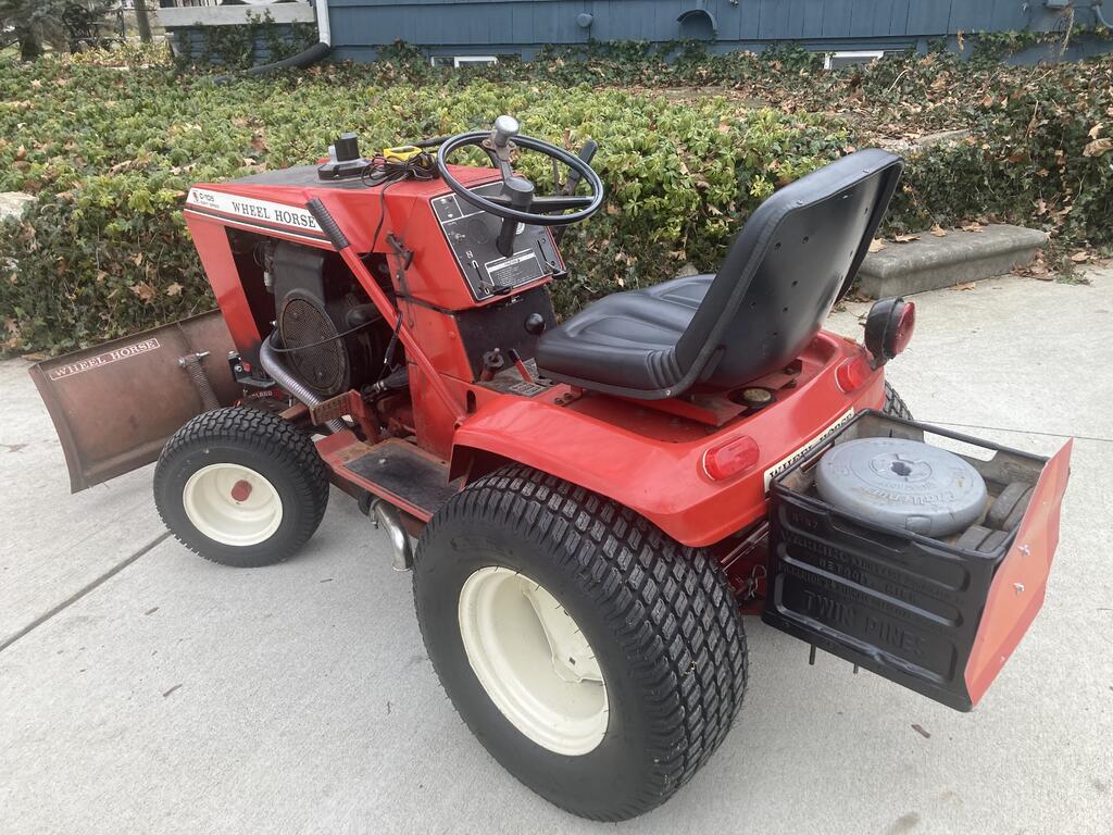

SylvanLakeWH 32,921 #4 Posted February 27, 2024 Weight box Lift crane Plow lift using winch 4 7 Share this post Link to post Share on other sites

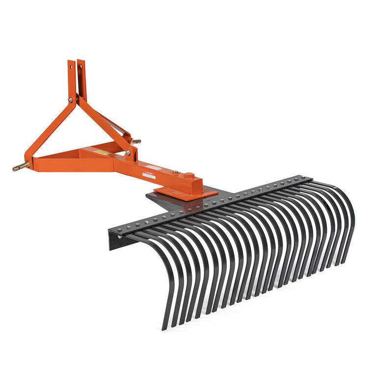

87 416-8 horse 430 #5 Posted February 27, 2024 36 minutes ago, rjg854 said: what attachments are you thinking of making? The main one I want to build is kind of like a rear spring rake. A smaller version of the on in the picture. 2 Share this post Link to post Share on other sites
953 nut 70,661 #6 Posted February 27, 2024 12 minutes ago, 87 416-8 horse said: a rear spring rake I built one several years ago, very simple and not too expensive. The rake tines came from Agri supply https://www.agrisupply.com/hole-landscape-rake-tine/p/10454/ The cross bar the tines attach to is two inch, 1/4" thick angle iron and the drawbar is two inch by 3/4" flat bar charved down to fit the sleeve hitch. Simple to make and works well. 6 9 Share this post Link to post Share on other sites

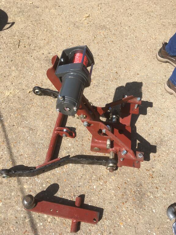

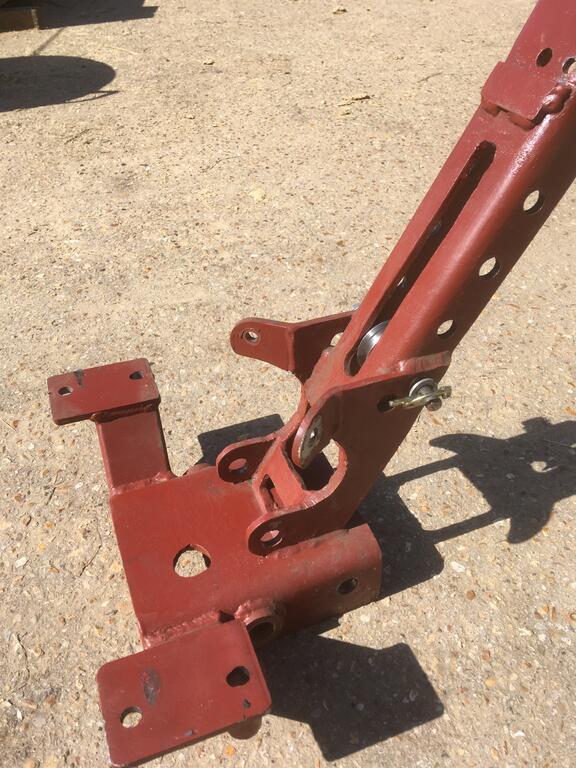

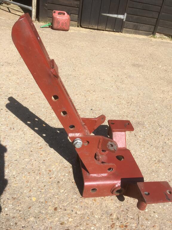

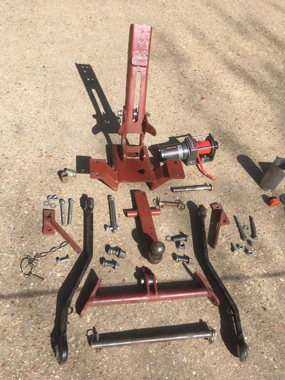

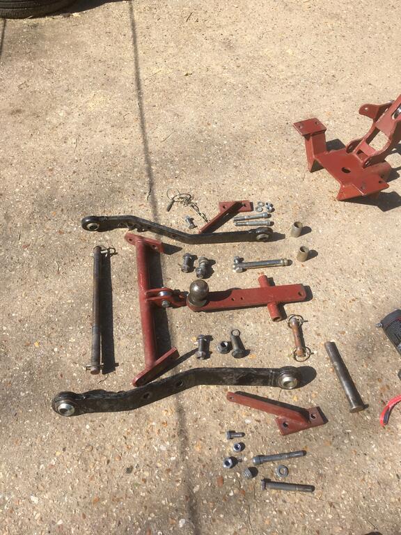

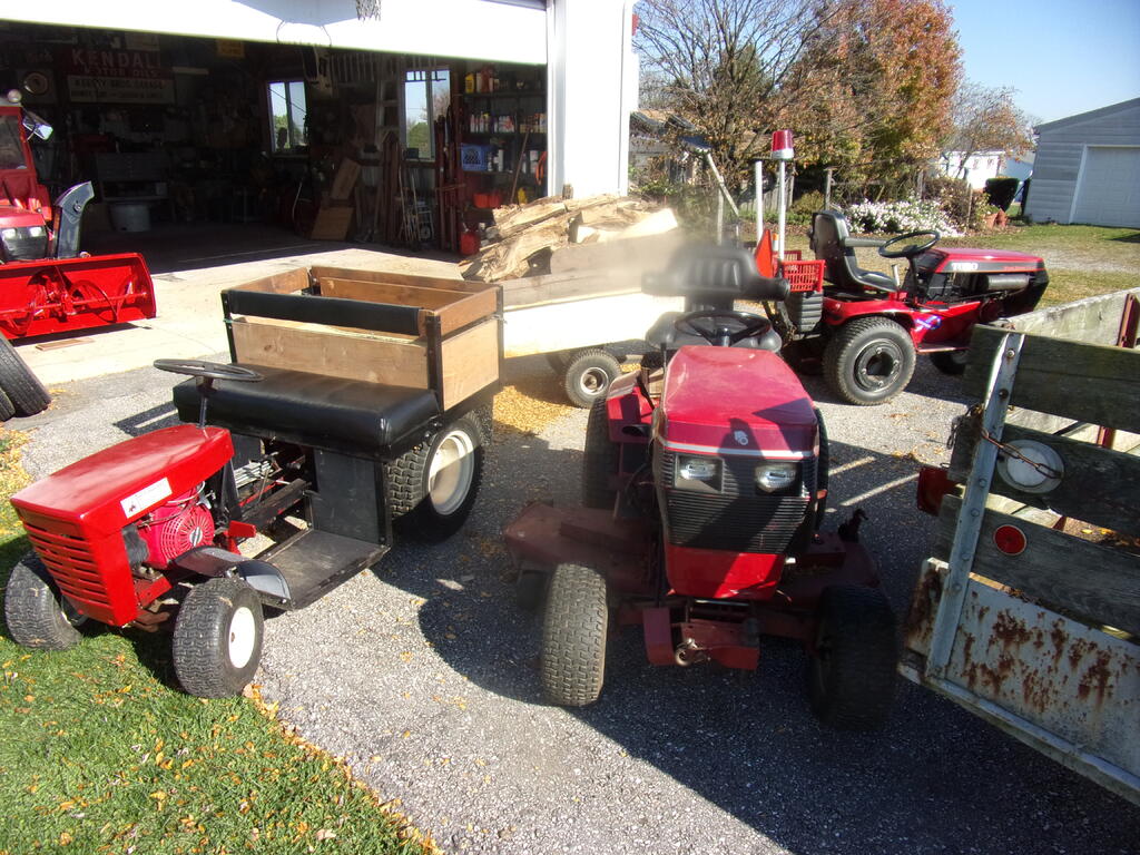

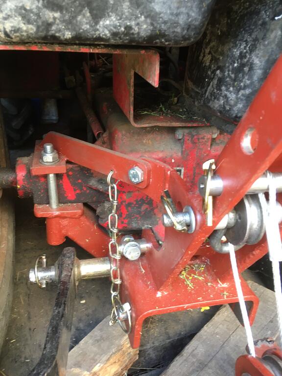

ranger 1,873 #7 Posted February 27, 2024 (edited) Welcome to Red Square👍👍 Here are a few pics of my main “Attachment”. Actually, more a device to attach my attachments to. Built from mainly scrap metal, apart from the winch! Plus a few other things that the C121 handles with relative ease! IMG_0822.mov IMG_0822.mov Edited February 27, 2024 by ranger 1 15 Share this post Link to post Share on other sites

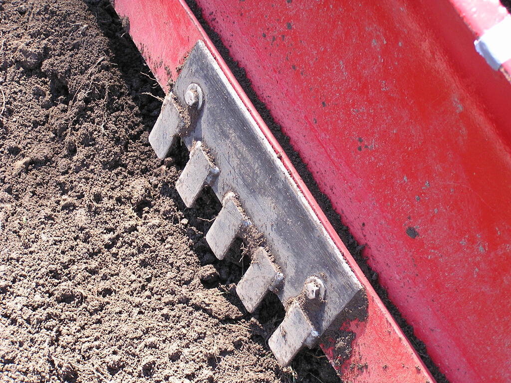

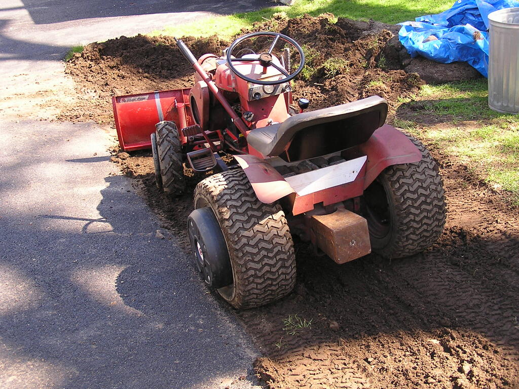

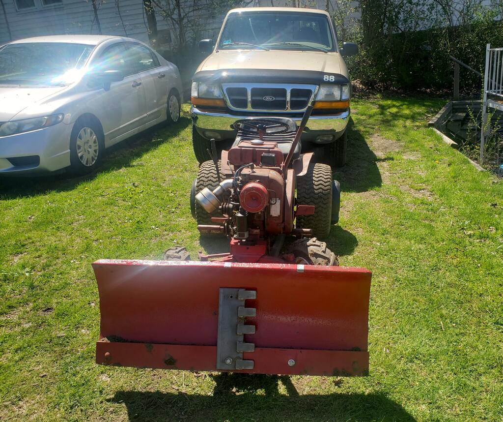

ri702bill 13,396 #8 Posted February 27, 2024 I made a ripping edge for the plow - had to remove grass after the new driveway went in... flips up easily to use the plow to smooth.... 3 5 Share this post Link to post Share on other sites
87 416-8 horse 430 #9 Posted February 27, 2024 20 minutes ago, ranger said: Welcome to Red Square👍👍 Here are a few pics of my main “Attachment”. Actually, more a device to attach my attachments to. Built from mainly scrap metal, apart from the winch! Plus a few other things that the C121 handles with relative ease! That looks amazing. Thanks for the pics. I may have to build one of those, it looks really useful. 2 Share this post Link to post Share on other sites
ri702bill 13,396 #10 Posted February 27, 2024 (edited) I named the Ripper Jack - Jack the Ripper!!. I also have a telescoping tree limb lopper namaed Cyndi - Cyndi Lopper!! Edited February 27, 2024 by ri702bill 1 7 Share this post Link to post Share on other sites

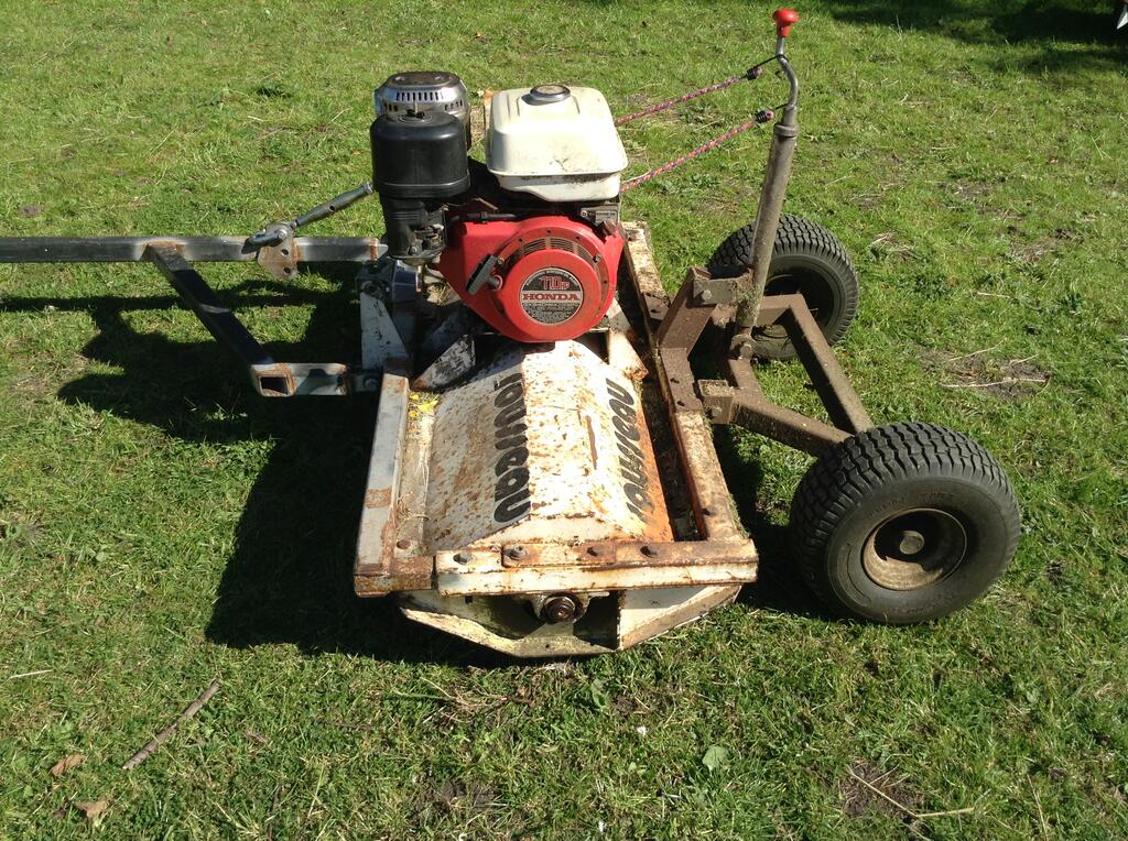

wallfish 20,744 #11 Posted February 27, 2024 For attachments Back hoe Modified a chipper/shredder to run of the WH Modified a walk behind rotary broom to fit on the front of a WH 5 1 Share this post Link to post Share on other sites

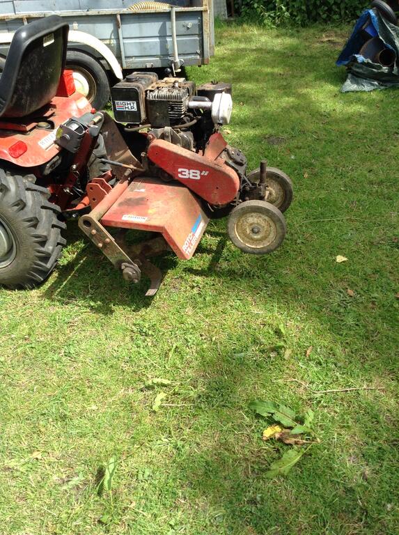

Ed Kennell 47,952 #14 Posted February 27, 2024 My front tiller. 5 5 3 Share this post Link to post Share on other sites

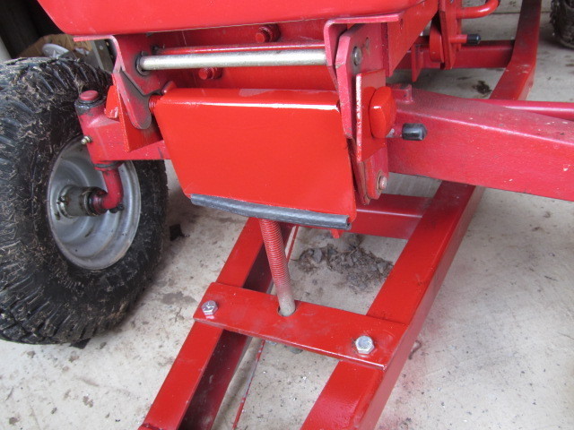

Ed Kennell 47,952 #21 Posted February 28, 2024 Plow frame stabilizers. 6 1 Share this post Link to post Share on other sites

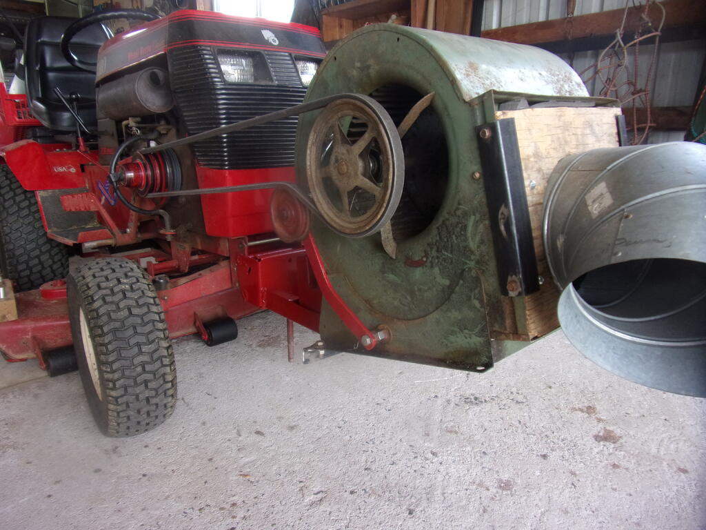

Ed Kennell 47,952 #22 Posted February 28, 2024 Leaf Blowers. 2 6 Share this post Link to post Share on other sites

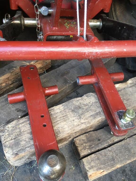

Ed Kennell 47,952 #23 Posted February 28, 2024 Side X Sides and Pick ups and front hitches. 3 4 Share this post Link to post Share on other sites
953 nut 70,661 #24 Posted February 28, 2024 10 hours ago, Ed Kennell said: Leaf Blowers I built one of those too. 3 3 Share this post Link to post Share on other sites

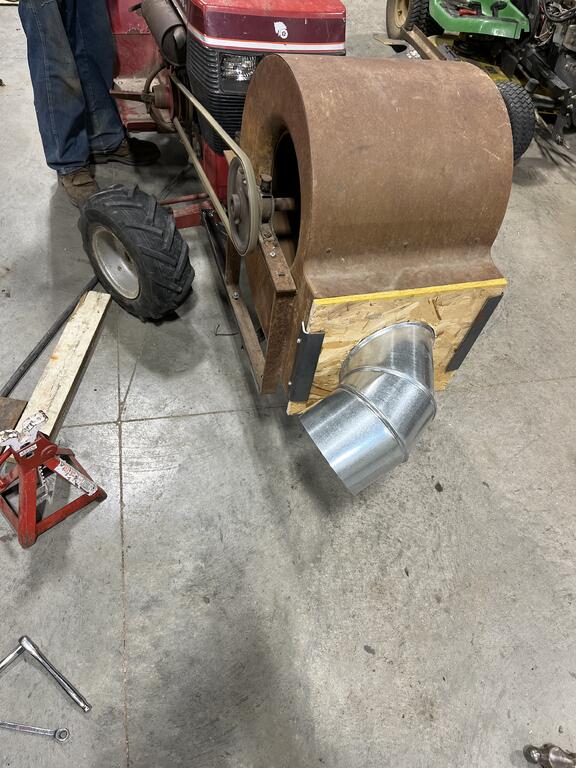

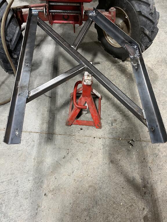

87 416-8 horse 430 #25 Posted February 29, 2024 I finished building a leaf blower last night. It moves an insane amount of air. The frame is built out of some scrap metal. Thanks for the ideas. 2 2 Share this post Link to post Share on other sites
