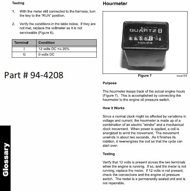

gwest_ca-(File Mod) 11,742 #2 Posted February 27, 2024 The ground for the light is at the oil pressure switch. Not running or no oil pressure the switch should close and ground the light which is powered with the ignition switch in the run position. That ground wire from the oil lamp to the sender also powers the hour meter. When the oil switch is open (no light) there is enough current flow through the bulb to the ground wire to power the hour meter and theoretically not enough to light the bulb. If the oil switch closes this pulls the ground to 0 volts so light on and the hour meter is no longer powered. Wheel Horse always used a flashing oil light but in this model I don't know how that is done. If you remove the wire from the oil sender and with ignition in run position the hour meter should advance. This is done to prevent adding hours when not running - key accidently getting left on. Just click on the picture to enlarge it 2 4 Share this post Link to post Share on other sites

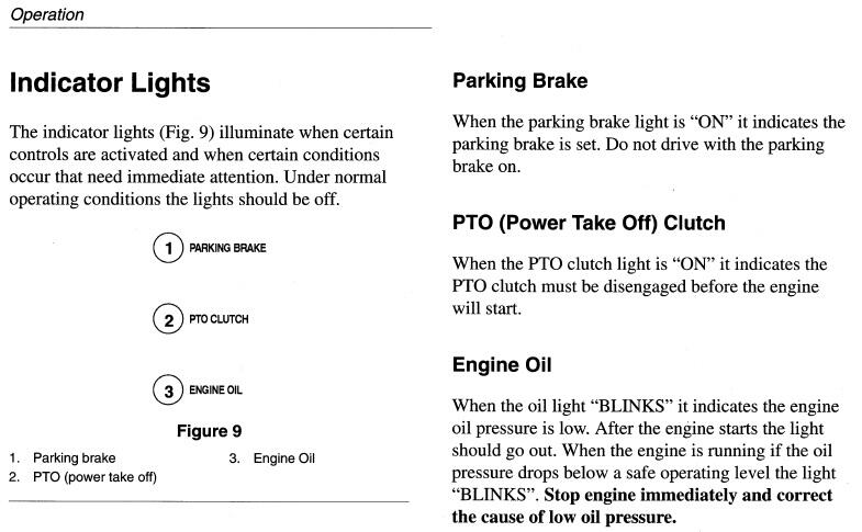

gwest_ca-(File Mod) 11,742 #3 Posted February 27, 2024 The 1998 operator manual claims the oil light blinks when activated but don't know what causes the flash. If the light is an LED it likely has a flasher in the circuit and part of the idiot light module. 2 Share this post Link to post Share on other sites

gwest_ca-(File Mod) 11,742 #7 Posted February 27, 2024 Any mechanical oil pressure gauge can be used for testing. If the gauge can not be installed directly into the engine a grease whip hose can be used to connect. They are usually 1/8" pipe thread on both ends. The parts list show 3 identical lights used so the flasher component may be part of the hour meter circuit. No mention in the manual about the pto or brake lights flashing. Key ON and the engine not running. What does the oil light do with the wire connected to the oil pressure switch and not connected to the pressure switch. Now do the same test with the hour meter connected and not connected. 2 Share this post Link to post Share on other sites

Gary S Minnesota 61 #9 Posted March 9, 2024 So, oil and filter change and a new oil pressure switch. Still have the faint flick about every 3 seconds regardless of RPM. Now I’m wondering if that light intermittent flicker may be tied to the hour meter? I’m assuming that the hour meter gets a shot of juice every few seconds until it actually registers the next 10th of an hour? Responders here have mentioned the hour meter gets its power from the oil pressure switch so as to not record if there is no oil pressure. Tomorrow i am going to pull the hour meter and check its’ ground wire? 1 Share this post Link to post Share on other sites

Gary S Minnesota 61 #11 Posted March 10, 2024 I traced the “faintly flickering” oil pressure light to the hour meter. When the hour meter is disconnected the flicker does not appear. I disconnected and reconnected the hour meter several times and the flicker appeared and disappeared predictably. I’ve noticed the volt meter registers at the top of the green at 14V. The explanation regarding the operation of the Hour Meter and its electrical coil charging and then discharging to operate the mechanical number counter at about 3 second intervals corresponds to the intervals I was seeing the flicker. Any issue with the Volt meter registering 14V? It’s still in the green but maxed out. This is after regularly being on a battery maintainer. Thank you to everyone who has replied to my posts. You guys are the best! 1 Share this post Link to post Share on other sites
