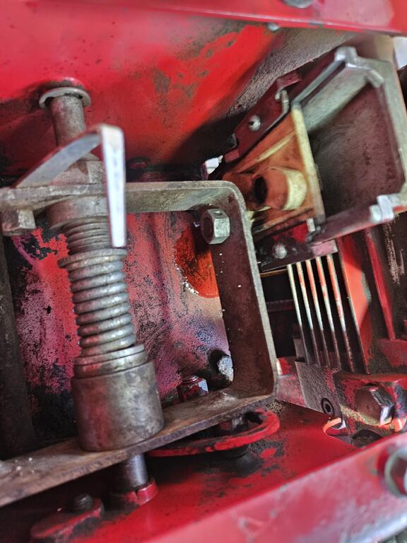

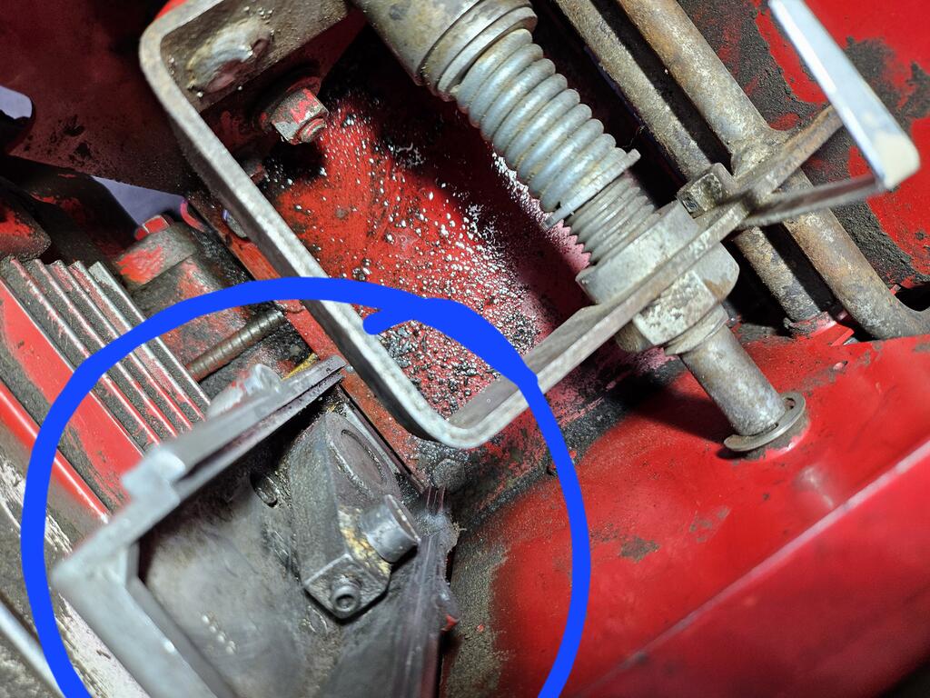

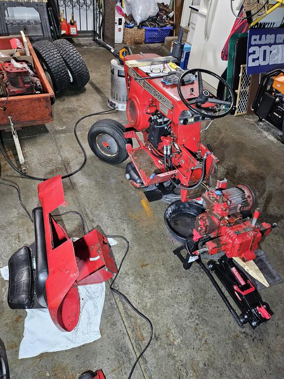

Brooklyn581 30 #1 Posted February 26, 2024 I have a steady leak that I think might be an o ring so I've purchased a replacement. Started breaking things down and it seems to be a growing project. It looks like there is a pin holding the hydro adjustment arm to the pump but no easy way to get to it. Can someone tell me if there is an easy way to get this assembly off and regasket & replace the o ring? Or am I barking up the wrong tree here and it's leaking somewhere else? Not sure if this is common but it no longer seems like a quick fix. There is a steady drip into the box from directly below this plastic assembly. Share this post Link to post Share on other sites

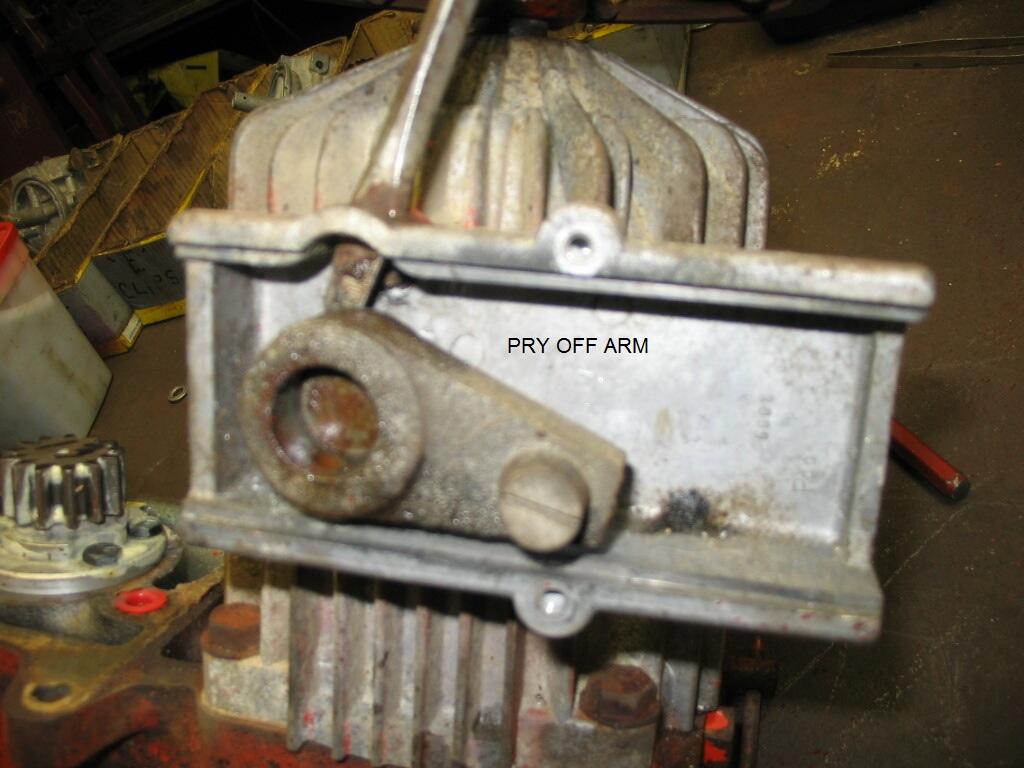

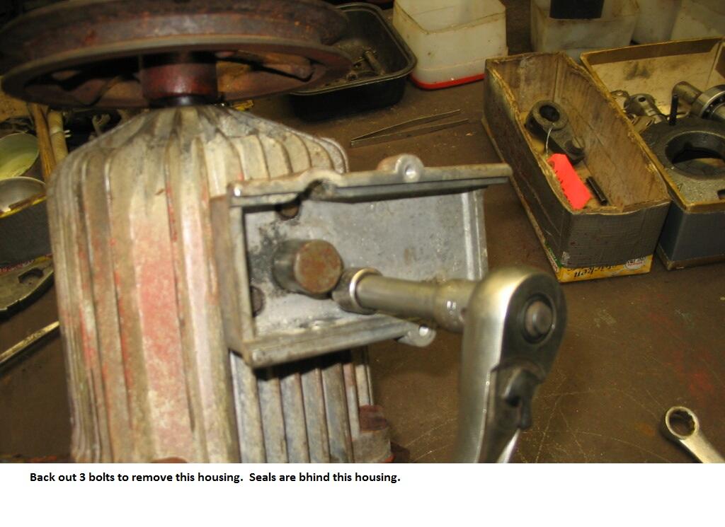

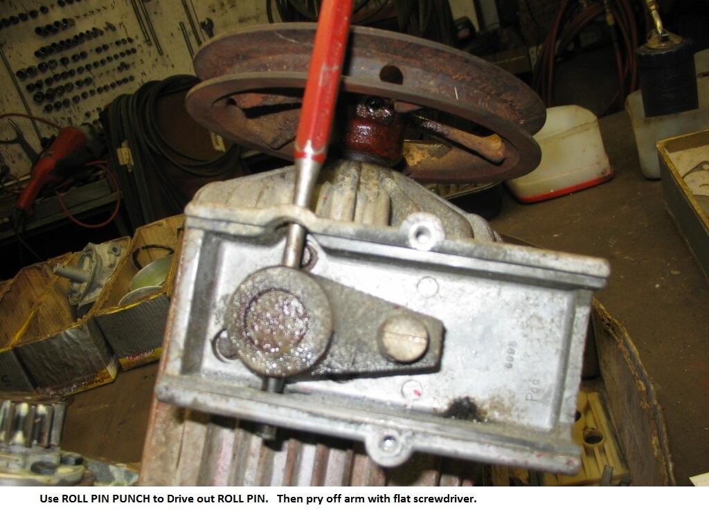

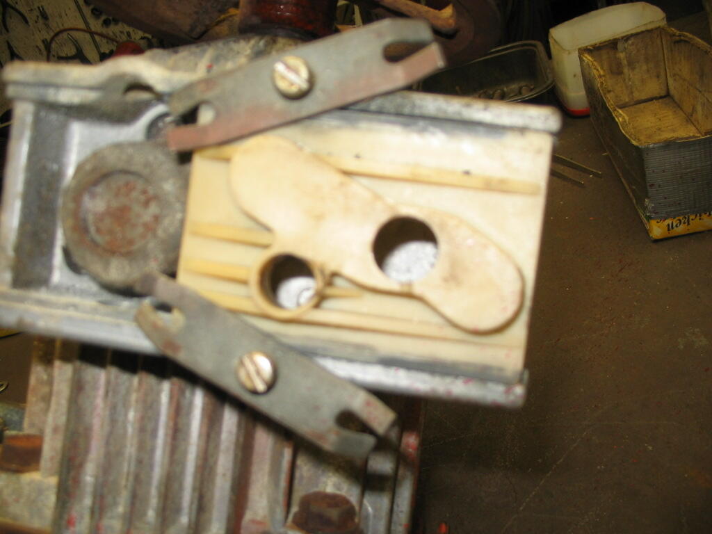

daveoman1966 3,880 #3 Posted February 27, 2024 There is, in fact, a ROLL PIN holding the motion control arm to the pump side shaft. You MAY be able to get at it without removing the entire pump, but I doubt it. In any case, use only a Roll Pin Punch to drive out the roll pin. I've repaired a bunch of these, but always out of the tractor...on the bench. 1 5 Share this post Link to post Share on other sites

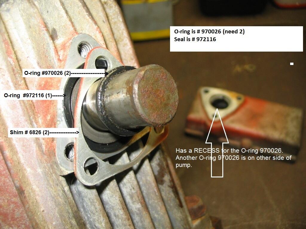

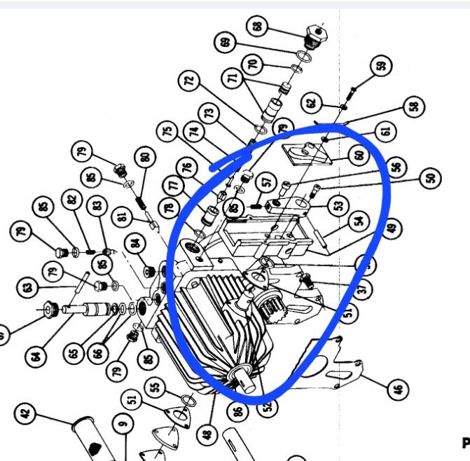

pfrederi 19,120 #4 Posted February 27, 2024 You will need to replace the rings in the motion control unit #52 and #55. Some say that you can do it with out splitting the tractor.. i have not found that to be the case. but maybe I may have fat fingers... Share this post Link to post Share on other sites
daveoman1966 3,880 #5 Posted February 27, 2024 I'll include another pic of the motion control apparatus. 1 1 Share this post Link to post Share on other sites
Achto 30,074 #6 Posted February 27, 2024 (edited) 16 hours ago, Brooklyn581 said: Can someone tell me if there is an easy way to get this assembly off and regasket & replace the o ring? The easiest way to change these seals is to remove the tranny from the tractor. Once you do this you will be able to access the hole to remove the roll pin from the motion arm. You will not need to remove the pump from the tranny. I've done a couple of them, should be about a 60min job providing the roll pin drives out easy. One tip to make life a bit easier - put some grease on the O=rings to help hold them in place while bolting things back together. Edited February 27, 2024 by Achto Share this post Link to post Share on other sites
pfrederi 19,120 #7 Posted February 27, 2024 Also you will need a 1/4" 12pt socket. I have the o rings I use a square profile for the large one makes it easier to get it in place and with a bit of grease keep it there during reassembly PM your address i will mail the two rings 2 1 Share this post Link to post Share on other sites
Brooklyn581 30 #8 Posted February 28, 2024 Well I've got it more apart than I wanted but it's a good opertunity foe a deep clean. Just waiting on parts now. Thanks pfrederi ! 1 Share this post Link to post Share on other sites
Brooklyn581 30 #9 Posted March 3, 2024 Update. New seals arrived and installed. Took all afternoon because I'm not a mechanic but the repair stopped the leak after a test run! Thanks again to Pfrederi! Share this post Link to post Share on other sites
